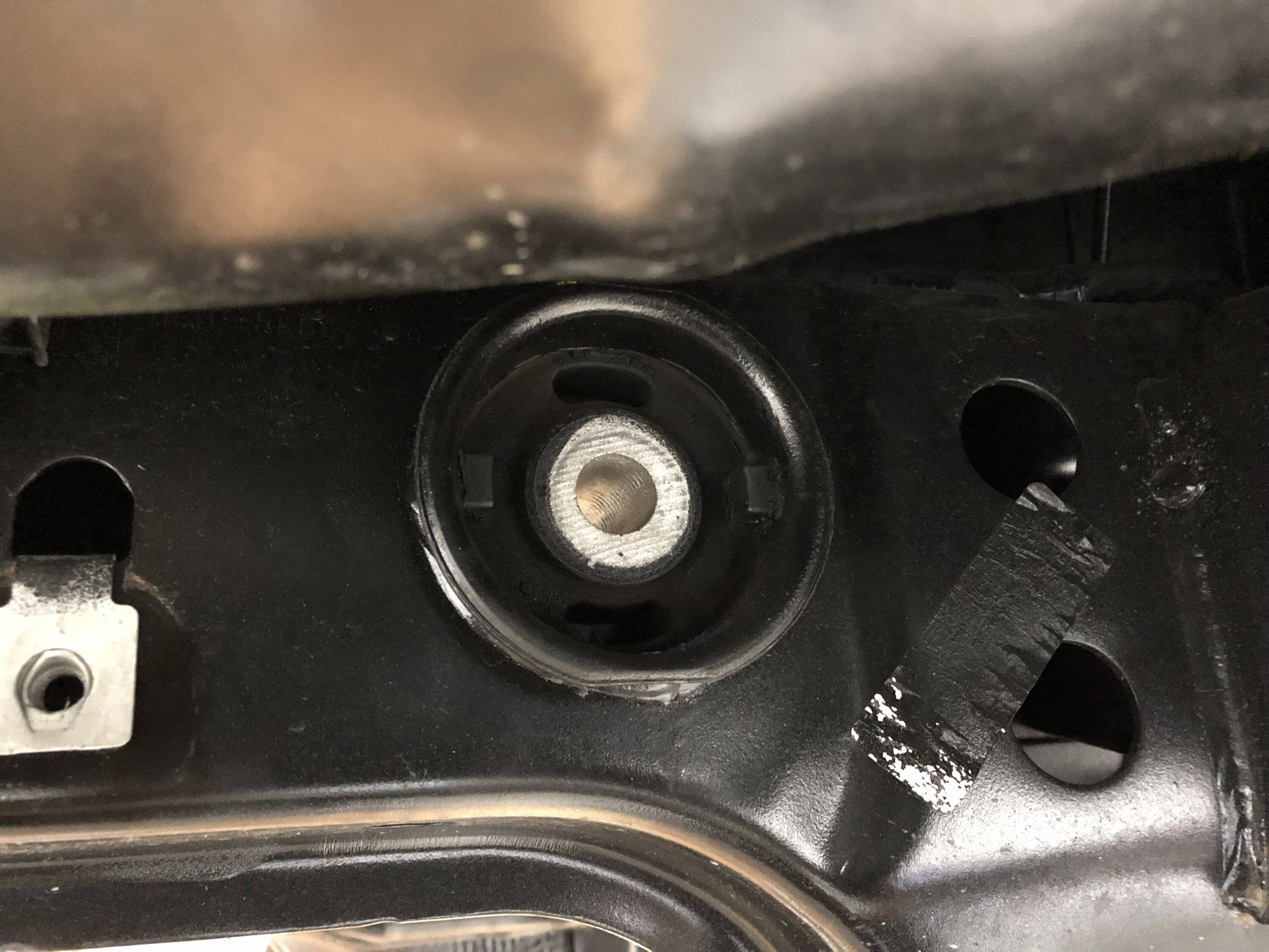

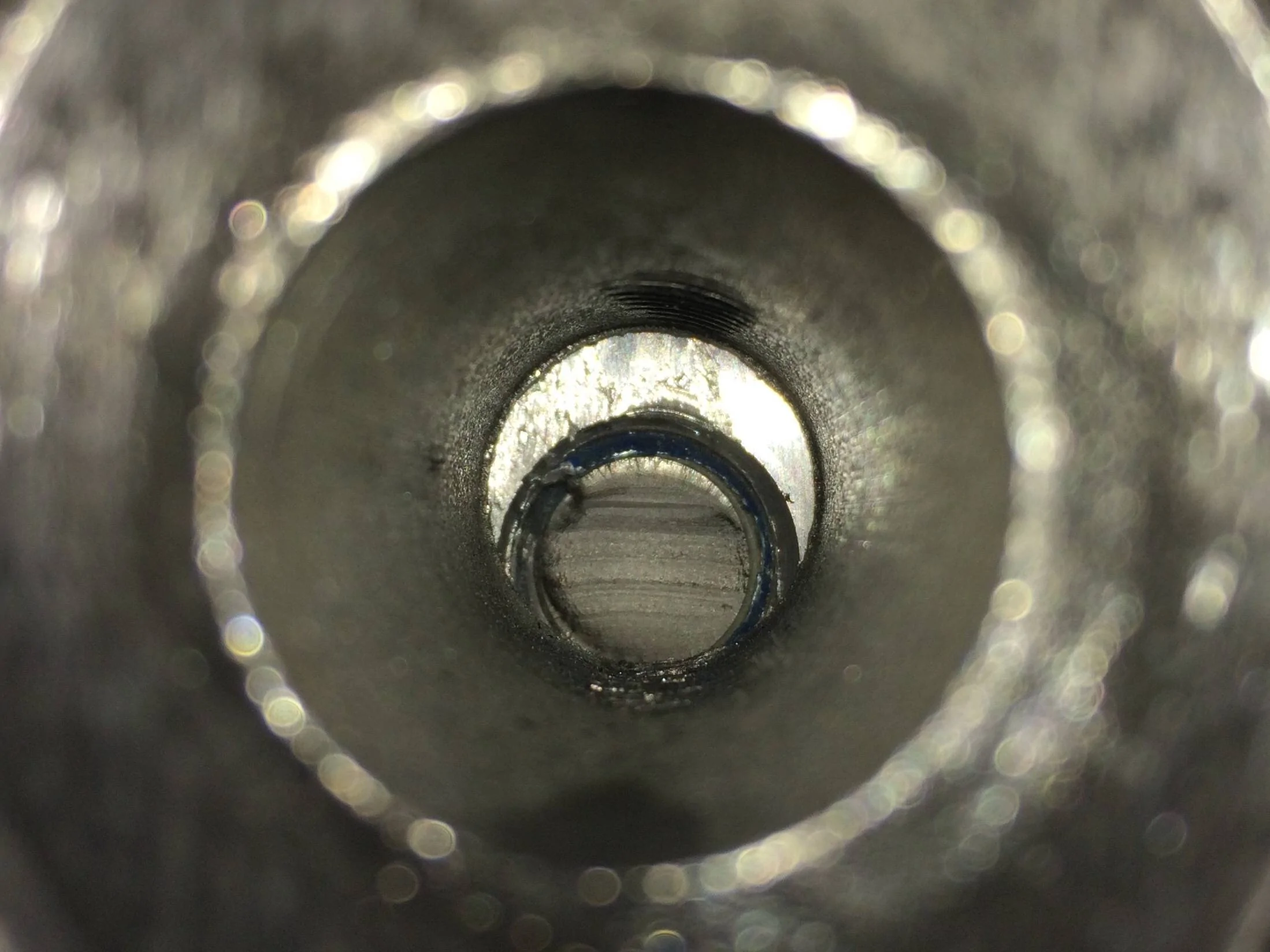

I hope you haven’t joined my club …
That’s the left side, but the right side also has nibble marks :
2020 car, standard PP1 spec including rubber, never been on a strip, never used launch control - I normally just roll into it but I can get through the 1st to 2nd shift pretty quick …
That piece of stud is well stuck in there. Due to that and the fact that the right hand side thread doesn’t look great, I’m waiting on a new rear cover :frown:
Hope your situation turns out better than mine :like:
WD :like:

I'm assuming by the location, there's absolutely no way to drill that out unless the entire rear IRS cradle is removed from the car, right?

Yeah the wheel well is in the way when everything is fully in place, you couldn’t get square onto it.
The bush is also quite thick that you would have to work through to get to the broken bolt.
The diff is currently out of the car awaiting the new rear cover :frown:
