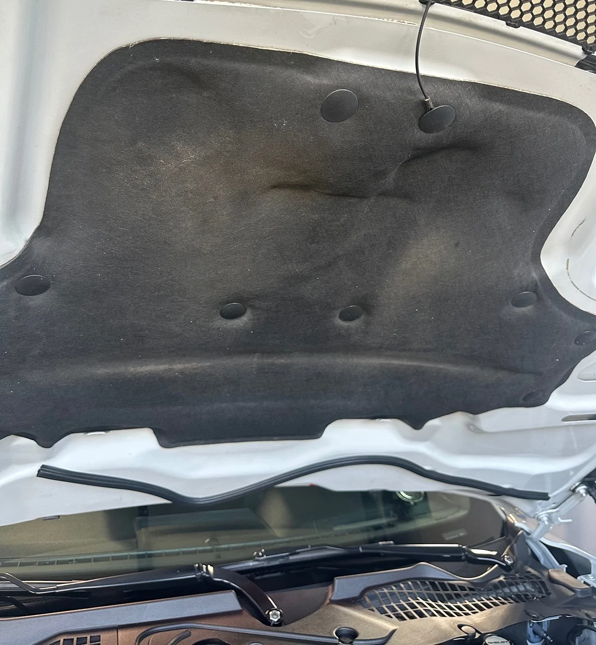

What is the best way to clean this liner? I don’t think the previous ever clean it.

My advice would be to remove the liner. Yup, pull it off and let the heat rise up and out. The liners only purpose is fire suppression, your rubber and plastic engine parts will thank you for the heat reduction once removed.

You can foam it down with a ph neutral soap and lightly scrub it with a soft bristle brush. I wouldn’t use a tire brush, those bristles are probably a little too stiff and might tear the liner. Or, you can ditch the liner altogether like Greg suggested.
Also, what’s that cable that is connected to one of the liner push pins? Those push pins aren’t super secure, curious what it’s holding

And you should apply some helicopter tape to where the rubber seal from your air filter contacts your hood. It will stop it from rubbing the paint off the inside of your hood.

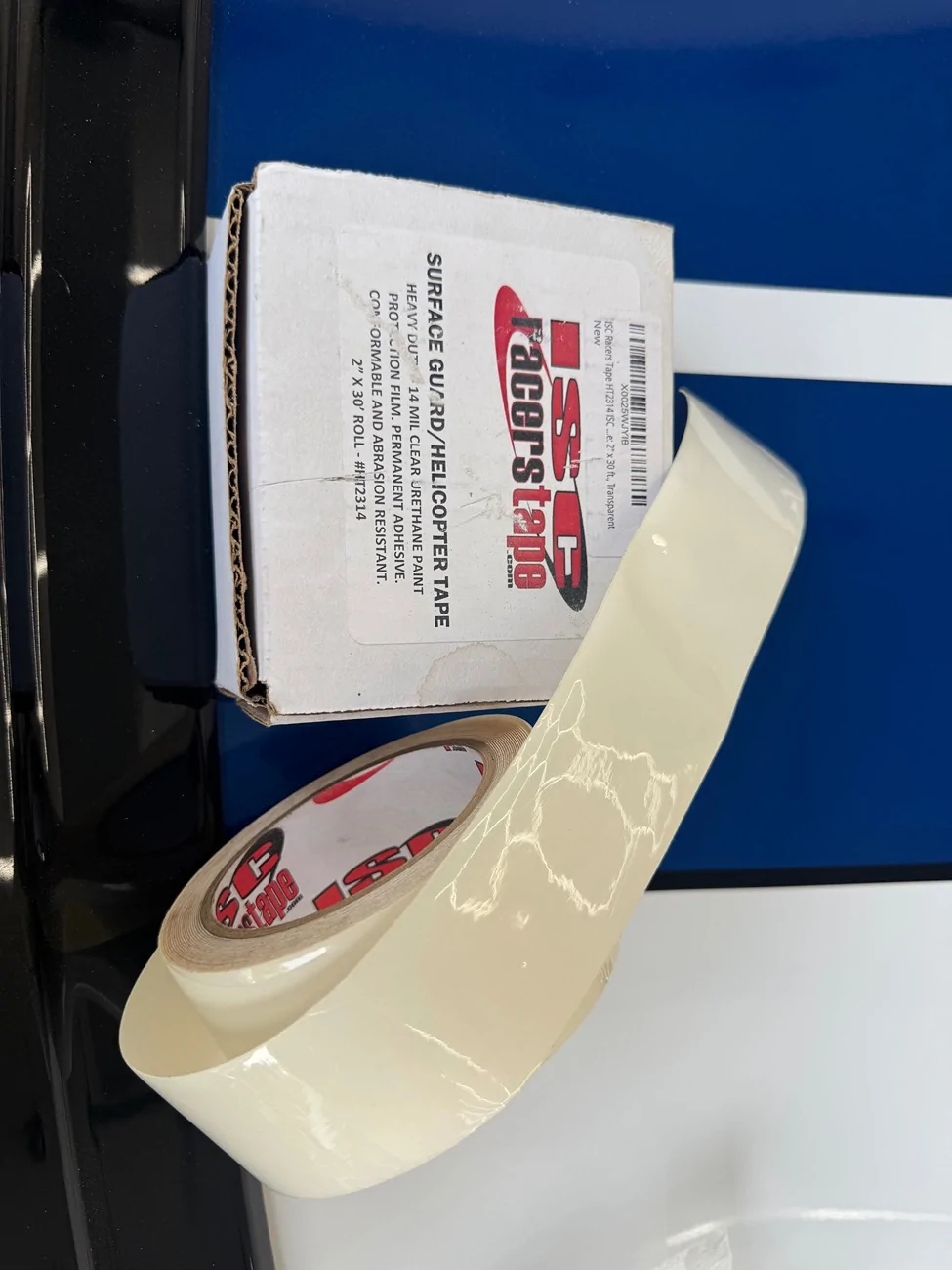

can you provide some info on this

the cable is from Ford on all GT350s - it is to make sure the air vent doesn’t detach and fly off.

Just google” helicopter tape” it’s basically really thick PPF for helicopter blades and plane body panels. I use it on my triathlon bike to protect where the bike rack makes contact with the bike. I applied the tape to the underside of my hood to protect the rubber from rubbing on the hood. It’s transparent.

Unclip it, throw it in the washer and then air dry it

removed mine. 5/5 stars, would recommend. Looks better, less unnecessary crap. Probably more engine noise coming through,as well, which is always fun.
