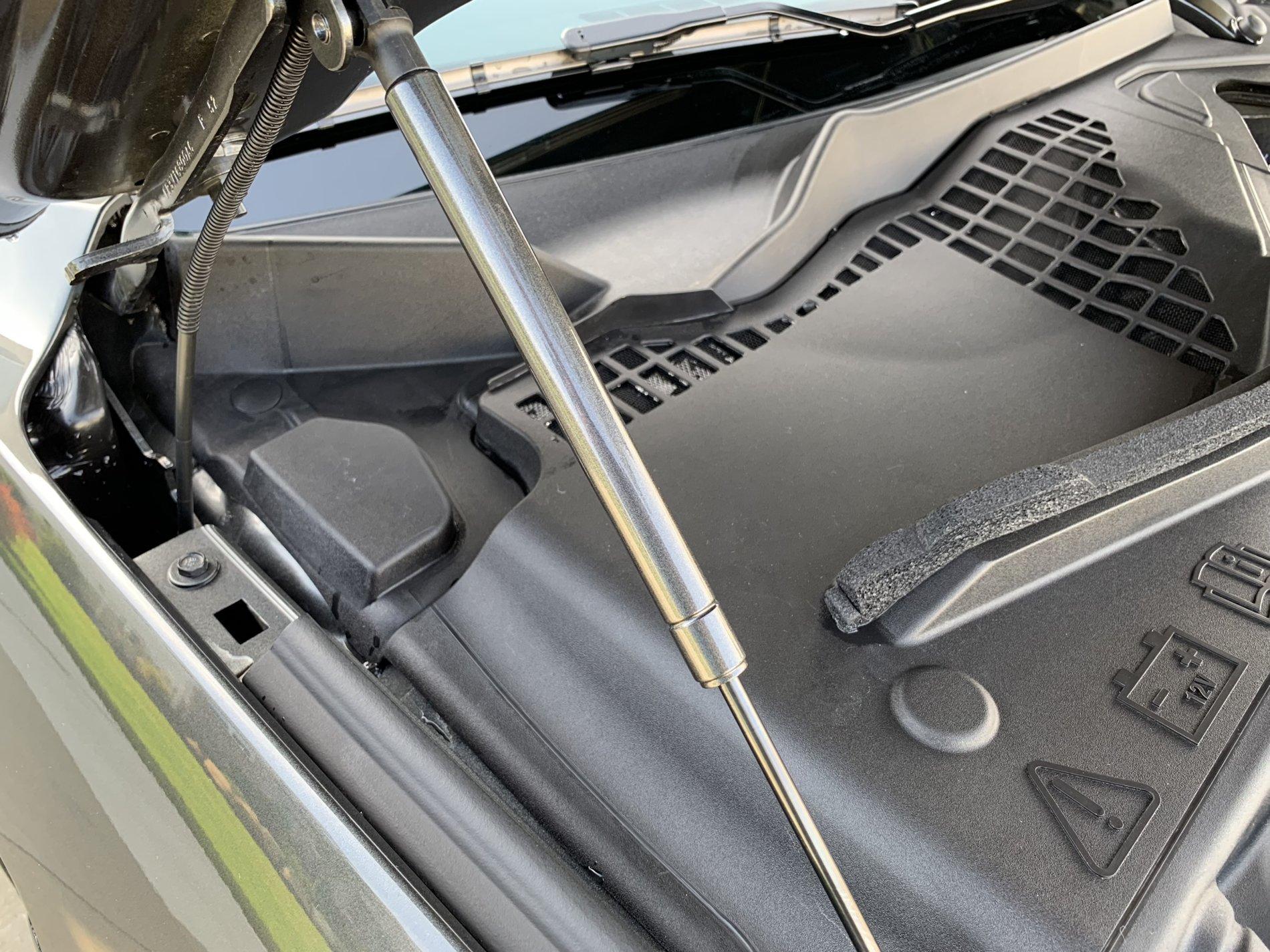

Black redline struts on my car, pulled the stickers and they look factory. If you want to be extra, some owners have had Ford Performance or Shelby stickers made for them.

Installed and removed the next day. Here is why: hood would not align properly on passenger side no matter how much I attempted to adjust the hood. A few other things that caught my attention; they are carbon dipped, not real carbon fiber, and the hood did not raise that high with them. They do install easy as stated, but it was a little frustrating not getting the passenger side hood aligned after install. Went back to the hood prop....will see if I can get either a Ford Performance or Redline hood strut at Mustang Week next week. Ran out of time to mess with it. I will probably bring it to Mustang Week and sell it to anyone for a reduced price.

Sure, I will clarify. Maybe align was not appropriate wording. Here is the condition which caused me to remove the MRT struts; once installed, the forward bolts have to be tightened to allow the hood to be as before. The install manual states to be sure to use the same bolt alignment as before so that the hood stays properly aligned. That was pretty straightforward; however, as the strut brace is placed between the loosened top hood bolt and the hood, and then tightened down again, the thickness of the strut comes into play for the hood assembly with the bolt. The strut thickness is estimated to be a little less than a 1/4 inch thick, and is pretty close to what the hood was raised on the passenger side. Could never get it to set down and be aligned or even as before. The driver side of the hood also had a raised lip but much less. I really wanted to use this setup for the true plug and play aspect, but it didn’t work for me. Maybe for others, but not me. I don’t have time to try and mess around with hood struts, it either works or don’t. The hood prop works fine and the hood is dead even/aligned whatever you want to call it. Time for me to move on as this particular solution did not fit my particular hood setup. The MRT is a nice piece but I figure with manufacturing tolerances in assembly of two different pieces, hood and struts, that that is bound to happen every once in a while. I am not astounded that this happened. I have been a DIY car guy for 40 plus years and each bolt on is different.

I don’t think it’s possible to install backwards. The bolts align one way only and the strut has a flange that sets into the hood bracket one way only.
