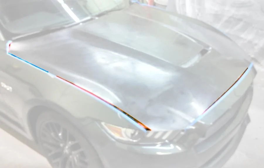

I am curious about the 350's hood fitment on a regular S550. Any chance you could comment on this since I am assuming you have done at least one test fit? I completely understand if you do not want to comment just yet.
I know it will not be a direct bolt on but I am curious just how close/far it is. Areas of concern that I can see are the rear sections that match the fender. 350's curve in more the OEM standard fenders. I would also imagine the front does not quite fit. Is the fender curvature different as well?

Your observations are correct. The hood is close, and looks good from about 15 feet away. However the fender to hood differences between a regular Mustang and GT350 are substantial. Enough so the are it drive lots of misalignment through out the rest of the hood, sides and the front.
We had our sacrificial clone on the car before I took these pictures. We couldn;t lower it because of the hinge studs, which we removed on the OEM piece. So we put the OEM Piece on it to confirm our suspicions.
I also need a new phone it didn't capture half the pictures I took, and barely takes good ones. Maybe I'll actually get a new one tomorrow and take more photos.
In the picture below, the orange overlays are gaps. The blue is physical interference where the hood is resting on the fenders.
The GT350 has much much more shape around the fenders and cowl than the regular mustang. The misalignment from the fender to hood interface causes most of this. What it also does, is drive the hood father forward. So in this picture you can see the hood is some what flush with the front bumper cover.
The hood is about 6mm too far forward in relation the the hinges, and cowl. So there is actually a large gap in the front as well. You can actually kinda see how much of the hood overlaps the headlights. It looks like the angry headlight inserts all the VW guys do. In addition to the gap, the profile is different. The GT350 has more of an arch on the leading edge than the regular mustang.
I am confident there is no changes to the hood fender profile though.
Could you get a OEM aluminum hood to work on regular mustang? Honestly probably not. Not without pouring money into custom body work. As you have to add and remove material. Hope this answers your question.
I will say this. It's a much prettier hood to look out over. And you can see more aswell. Although I have alot of money tied up in it. And there is going to be alot of time an money to get our fiberglass one to fit. To build Carbon ones. I have no doubt it will be worth it to have the same profile, and cut weight and not just a GT350 style heat extractor.
