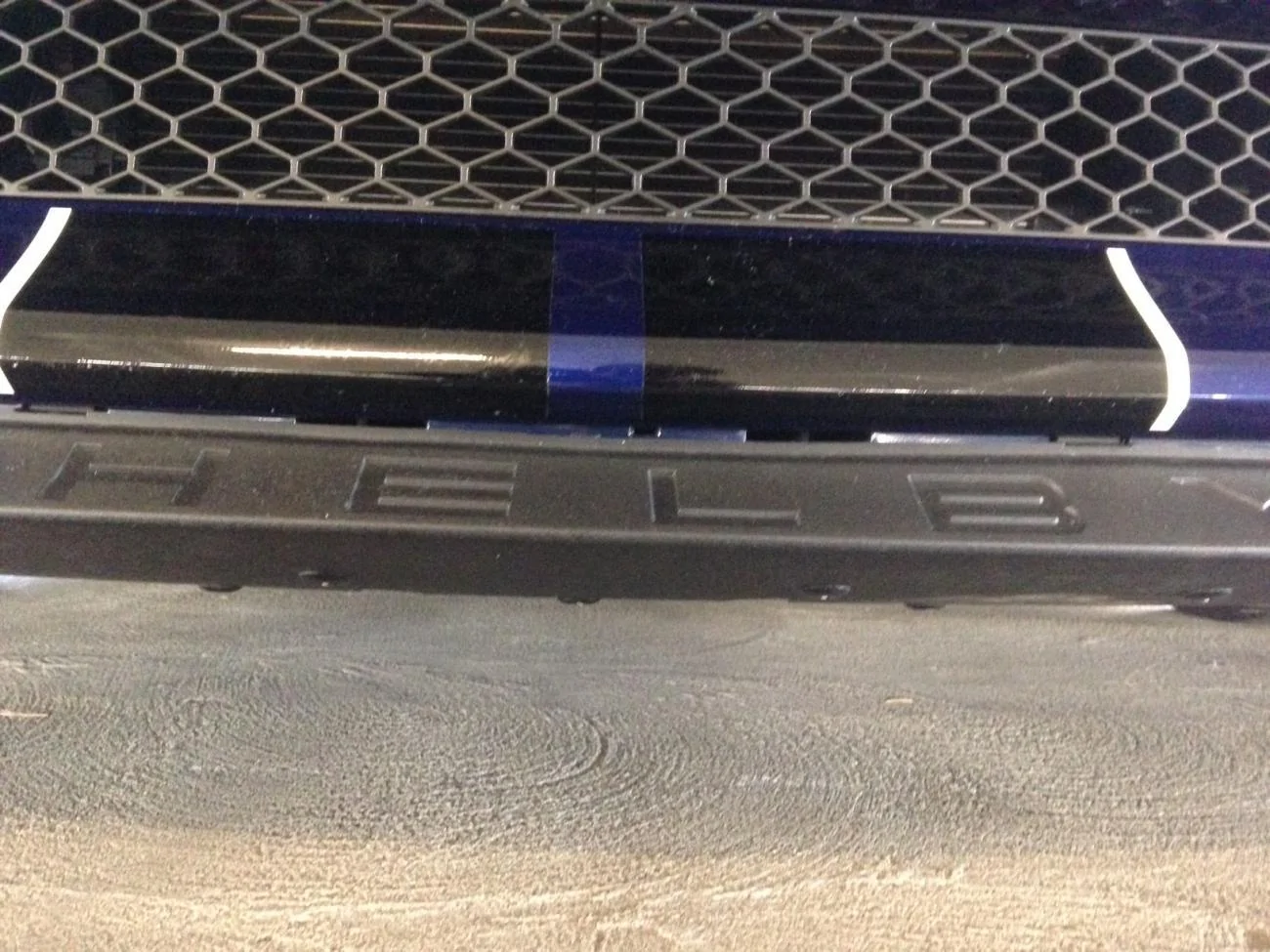

Okay I just noticed, so I take it my front splitter wasn't installed correctly? :doh: :frusty:
Newp. That's what mine looked like when I took delivery.
If I hadn't been concerned about transport damage to the fascia tabs I would've just loosened the fasteners and attempted to get the center tab to seat in the hole (you can see in the photo). You might try that.
