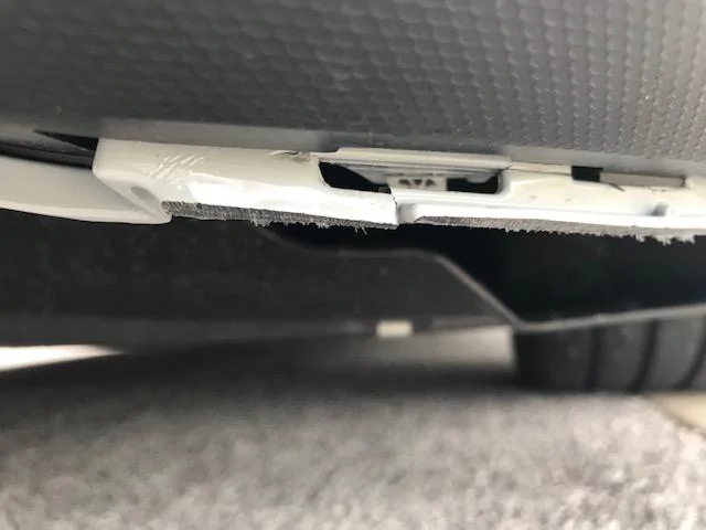

Well, this thread was recommended by a member here. So thumbed through...Those of you waiting to install, be careful because the exposed bits dedicated to receiving the three piece splitter can turn out to be uber-expensive if they are compromised. It could cost you the entire bumper cover, finish and install...I am going to try to fix the plastic tabs, but this little issue can be irreparable in theory...Not sure if I did the damage (I doubt I did), or the dealership hired help did the damage...At this point, because structural integrity is paramount for a working bit like the splitter, I will take it into the dealership and have them fix and install it...I will make sure to instruct them that the integrity of the splitter receiver tabs NEED BE STRUCTURALLY sound and if they can't sort it out with a good plastic repair pro, then the whole bumper cover will need replacement.

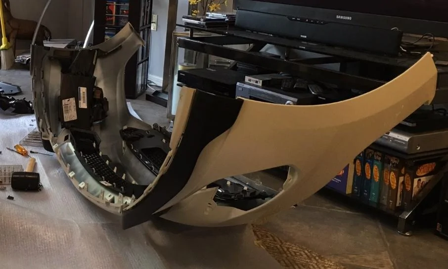

Splitter Woes
Probably Bumper Cover and Paint for about $500.
Problem is all the Labor involved in Disassembling the Parts.
You could do it all yourself by ordering a new Bumper Cover and take it to the Dealer’s Body Shop and have them match the Paint. After a week or so, take it back home and re-install the Parts.
Once everything (including the Splitter and Belly Pan) is installed, it’s actually easier to 1st remove the Fender Shields, then the Belly Pan and Front Bumper Cover as a Single Unit, if you need access to the Radiator area.
