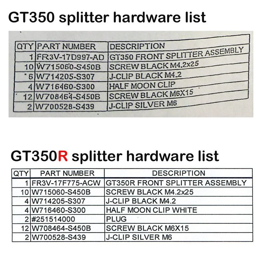

Does anyone have a list of the fastener parts needed; part number and quantity? I have my uninstalled splitter but no hardware. Thank you and thank you for this good thread. My car was shipped to me from an out of state dealer with the splitter in the trunk without hardware.
Wriggly
Jul 17, 2016
517
225
Illinois
2018 Porsche 718 GTS
Here ya go.
