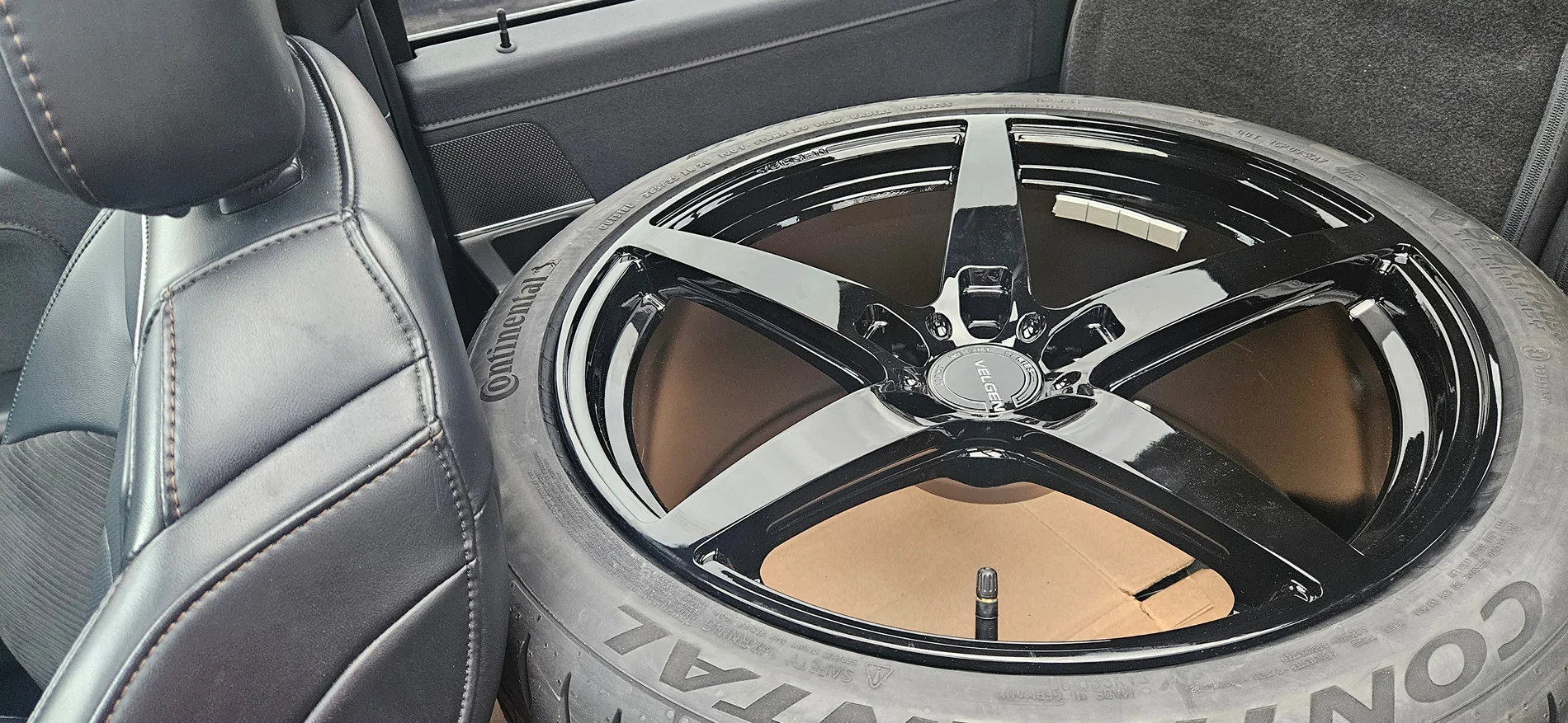

Well after a little mix up on delivery, ive finally got everything i need yo do the wheels. Going to go get the tires mounted today and probably coat tomorrow.

Ok , I'll definitely take a look at what adams recommends. Im pretty pumped as the tire shop i went to (Big E Tire) had newer machines which used a plastic guide for everything. Took a look at all 4 wheels this morning and there was absolutely no damage to any surface. I kinda wanna go back and give their tire tech a tip for the 2 hrs he spent putting the tires on.
Im glad I waited as everyone recommended i do before even cleaning the wheels. So tomorrow panel prep and coating. I do have a question though. I plan to tape the tires themselves off soni don't get any coat on them, but how do I go about getting the corners of the wheels where the face meets the barrels? I can see how it can cost it with the smaller pads I have now, but how do I go about leveling that with the 1st and 2nd wipes?
Edit :: Also as far as the ceramic coat goes wheb applying, do I just forget the sway nozzle and drip right onto the pads? That seems like a more efficient thing to do instead of spraying shit all over.
