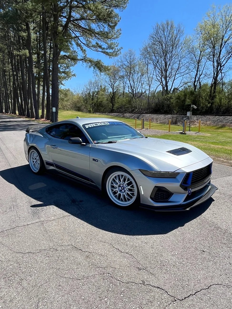

The ADS wheel is amazing. I did 2 coats on these wheels, and have washed them at least 15 times since, they shed water like any ceramic coated surface. Very nice coating...
