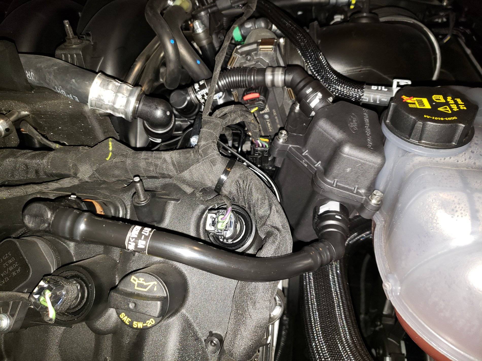

I have the FP Passenger side:
https://performanceparts.ford.com/part/M-6766-A50A
100% fits, had 0 problems installing it. It sits at a bit of an angle on the bracket (so it's not just hanging off the hoses)
Easy to remove and empty with the quick connect fittings.
Looks like a nice factory unit. I’ve only 800km on mine - hope to get it out of hibernation soon.
Interesting to read the disclaimer re. only for track use. Not sure how it’ll violate US and Canadian emission laws and since the probability of being checked/caught is essentially zero, I’m not too worried about installing one.
