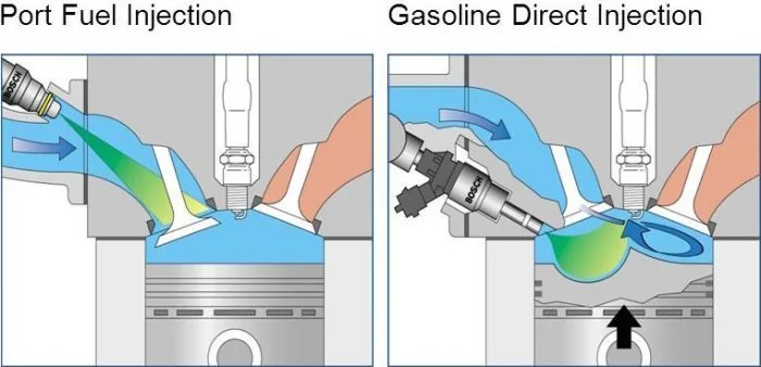

here is my understanding on how this works, i'll be vague and brief, since im not an engineer or mechanic :crackup:
the image above shows a very basic illustration of the difference between port injected engines and direct injected engines. keep in mine though, our coyote3 is a bit different in that it actually has both port and direct injection components. its my understanding though, that the port injection doesnt pump fuel as much or as often as the direct injectors do though.
so, now looking at the image above, the blue area is intake air. this is also where all the oil and crap that didnt get burned off and didnt make it to the exhaust, gets recirculated to. it gets pumped back through the clean air intake to go through the combustion process again, in an attempt to get it to burn cleaner..
this sprays dirty oil and other crud all over the top side of the valves, as you can see from the picture for port injection, the injector is located above the valves. so it sprays gas over the valves, helping to clean them as they get coated in dirty oil and other deposits that never got burned up in the combustion phase.
now take a look at the direct injection illustration. notice the injector is below the valves, so dirty air comes in, coats the valves, and since gas isnt washed over the top of the valves. its injected directly into the cylinder and the valves stay dirty, get crud build up, have the possibility of not sealing as well (due to carbon build up), etc...
the catch can, catches (minimizes) the amount of this dirty substance, before it has a chance to coat the topside of your valves.
