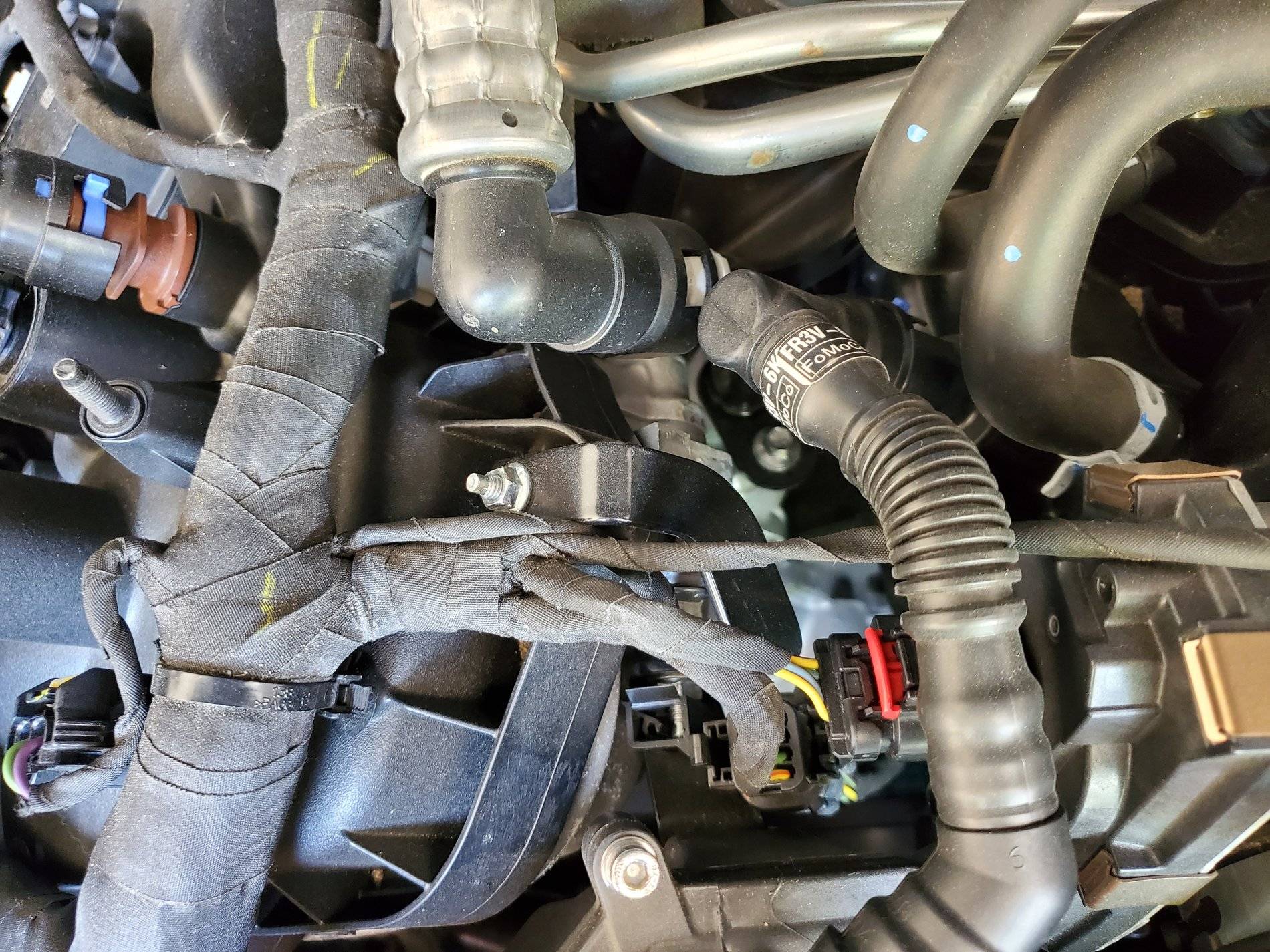

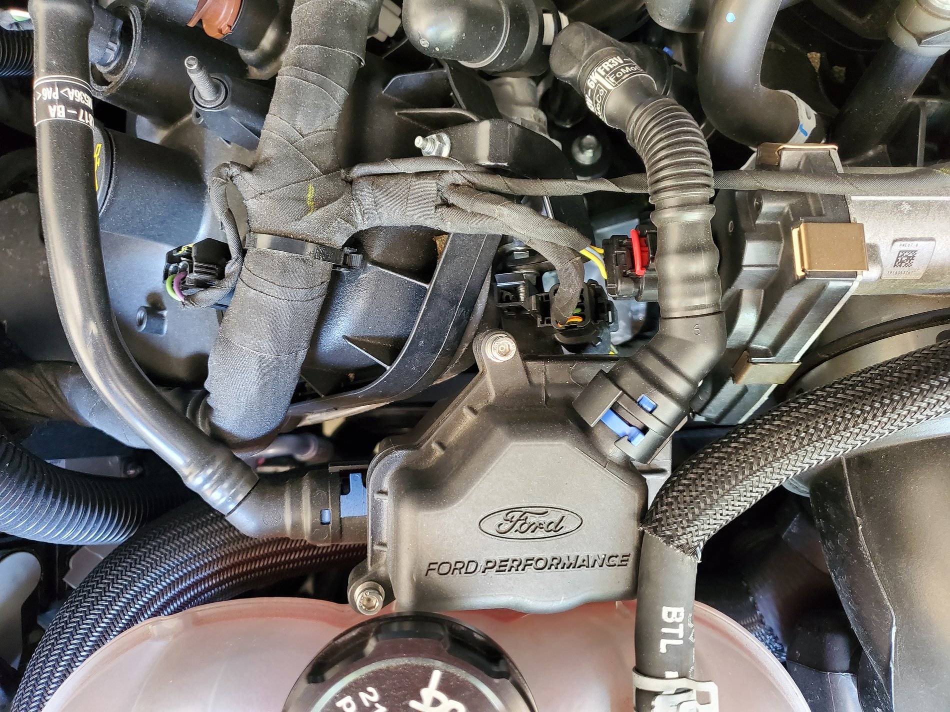

Hey, could you please post a picture (or 2) of your separator? I assume you have the xxxA version, with the long bracket, since the other one doesn't bolt to our valve covers. I've seen a couple of those installed, and they looked bad. Since you're saying it fits stock, maybe there was an installation issue or something. I'd like to see if it really looks stock to my more discerning eyes. Ha ha. Thanks brother.
Yes, I have the M-6766-A50A separator. The bracket attaches to the valve cover. You remove the top bolt and replace it with one that has a stud to attach the bracket. The first picture is the overview of the separator. The second is a close up of the bracket attached to the valve cover. I think it is pretty clean looking. To empty it I don't remove the hoses, I just use a 4mm allen wrench to remove the screws holding the lid on and use a large syringe to suck out the oil.

I have the same one. Looks and fit OEM

Thanks Nms. Yeah, looks good. Could be better if Ford had included a proper bolt and a spacer, rather than that cheap-looking stud. But more importantly, is the actual catch can design good? Did any of you scrutinized it on the inside? Because in this case, function trumps form IMO.

i looked inside my ford performance one when i received it, the *-A50A.. looked nice.. there is a groove and a rubber gasket so the top seals well. there is a metal fabric mesh/screen that sits between the lid and body, horizontally. this screen helps separate the oil from air before heading back to the intake.
i didnt take any pics of the inside of mine before install, however it looks really similar to this, just not quite as deep
