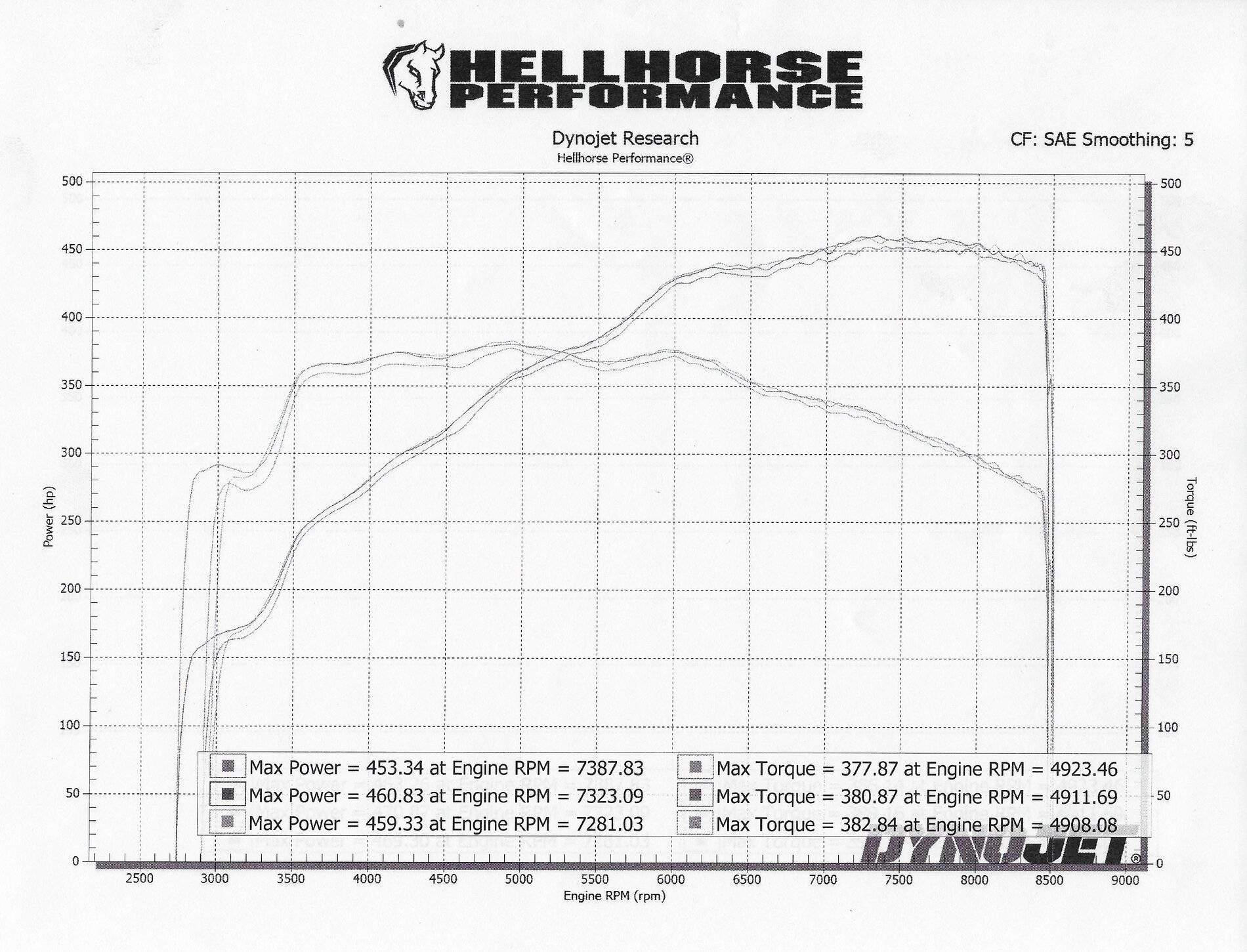

Looks like we have the same car and going with the same mods... Beautiful car! Just dyno'd mine stock the day before yesterday and putting exhaust when it gets here. Then back to the dyno. Then adding a 93 tune and on to E85. I will dyno after each mod same dyno and post only SAE#s (it made 473whp STD but that's only correct for that day). I'll post these up if interested. I've got 10.8k miles and burn about 1qt to 5k miles.
