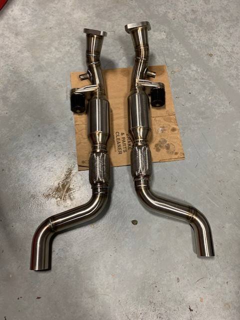

Finally received my B-Line resonated test pipes.
First impression is the build quality is top notch! I wish they were not hidden away under the car... awesome job guys!!! Install was a piece of cake, went right in with absolutely no issues. First start... wowzers! Sounds amazing! With bypass closed it is hardly noticeable... open on the other hand is a big FU to the neighbors but it made me pee a little... Don't want the sound to change at all from here... perfect for me. First drive... seems like I can feel something but to be honest not positive. Scheduling time on the dyno again and we will see. I'll post up when I get it done, hopefully by this weekend.

Man those are pretty. Definite shame they are hidden. Looking forward to seeing your dyno results.

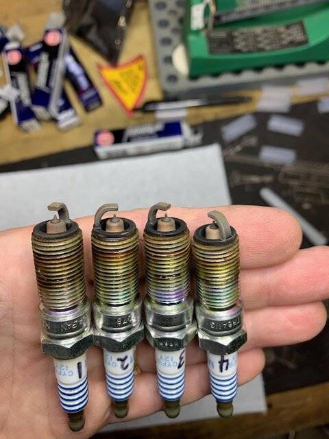

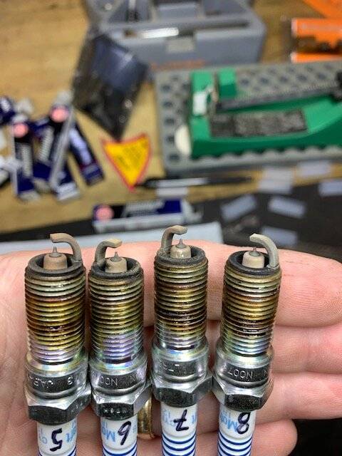

I decided to check my plugs since i am planning on a 93 and E85 tune next. While doing so I went back with the NGK (6510) LTR7IX-11. All the OEM plugs look pretty good and were consistently gapped @ .051. The NGK's were @ .039 and left where they were. Holes 7 and 8 had more oil buildup on the threads than the others but all seem to be a nice golden brown. This is with 11,600 on the ODO.

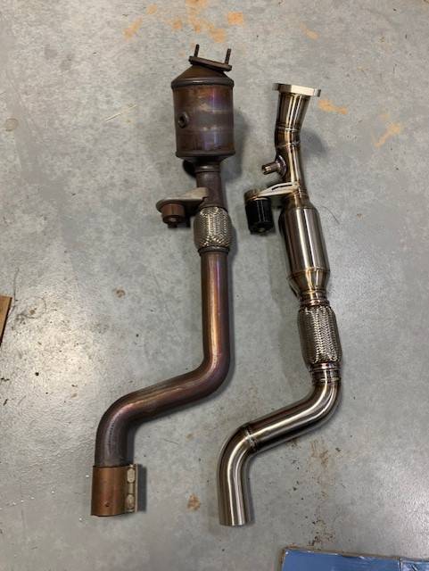

Did you happen to weigh stock versus the B line pipes?
I did and failed to mention. Stock are 13.2 each and B-line with resonator are 11.9 each. Not a whole lot of weight savings but there is still almost a 3lb difference to the good. The straight pipe would probably be another 1.5-2.0lbs lighter than these however.

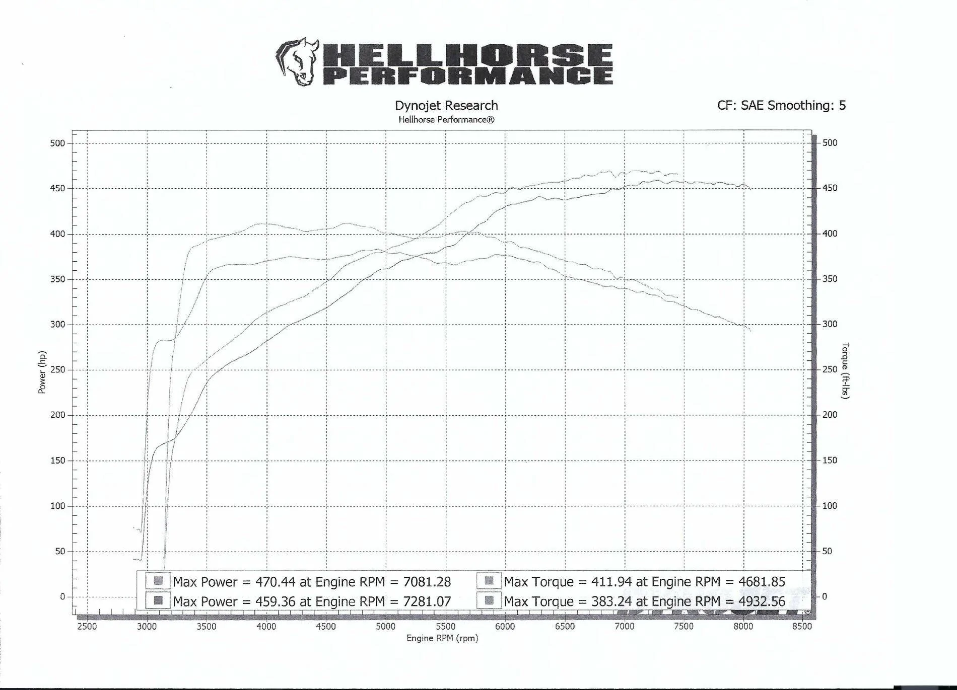

Well, I was finally able to get the time to get back on the dyno. I have had the B-Line resonated test pipes on the car for about 2 months and 350miles. No CEL and car still sounds awesome to my ears. While I thought I felt some gains when first installed I was hesitant to attempt to qualify because it's natural to "want" it to feel stronger. Here is the proof... notice the whole curve is dramatically improved. A ton of usable torque down low and you can feel it. I still have the OEM shortie headers on so I wasn't expecting much on the big end but there is a little gain there too. This is best stock pull to best catless pull but the mean between them is very close. 1-2 hp/tq. It was extremely hot when I ran (100F), these are SAE# but correction factors are not perfect. Again, just look at the curves not the peak numbers. This is stock engine management software. Next will be a PB 93 and E85 tunes.

Very nice sir! Great gains under the curve! I am sure some of your torque gains can be attributed to the installation of the carbon fiber driveshaft as well reducing rotational mass. I have a similar set up but switched to a full Borla Atak catback.

There will be gains in ET at the track but nothing on the dyno with the carbon DS, it’s the same as a lightened flywheel, you will notice it in responsiveness but not measurable by the dyno. In this regard the base run was done with the carbon DS installed.
