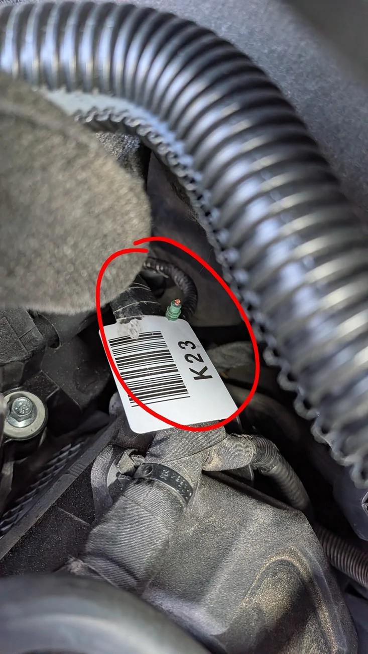

found the culprit when testing the connectors...
It's on the PCM / coil harness. Just need to get access behind the motor now to figure out where it goes to and what connector so I can order pins for repinning.
I guess my other option is to buy a new wire harness.

To close the loop I ordered a new connector from Ford WPT1253. Soldered it in and added a heat wrap.
Car is working again.
