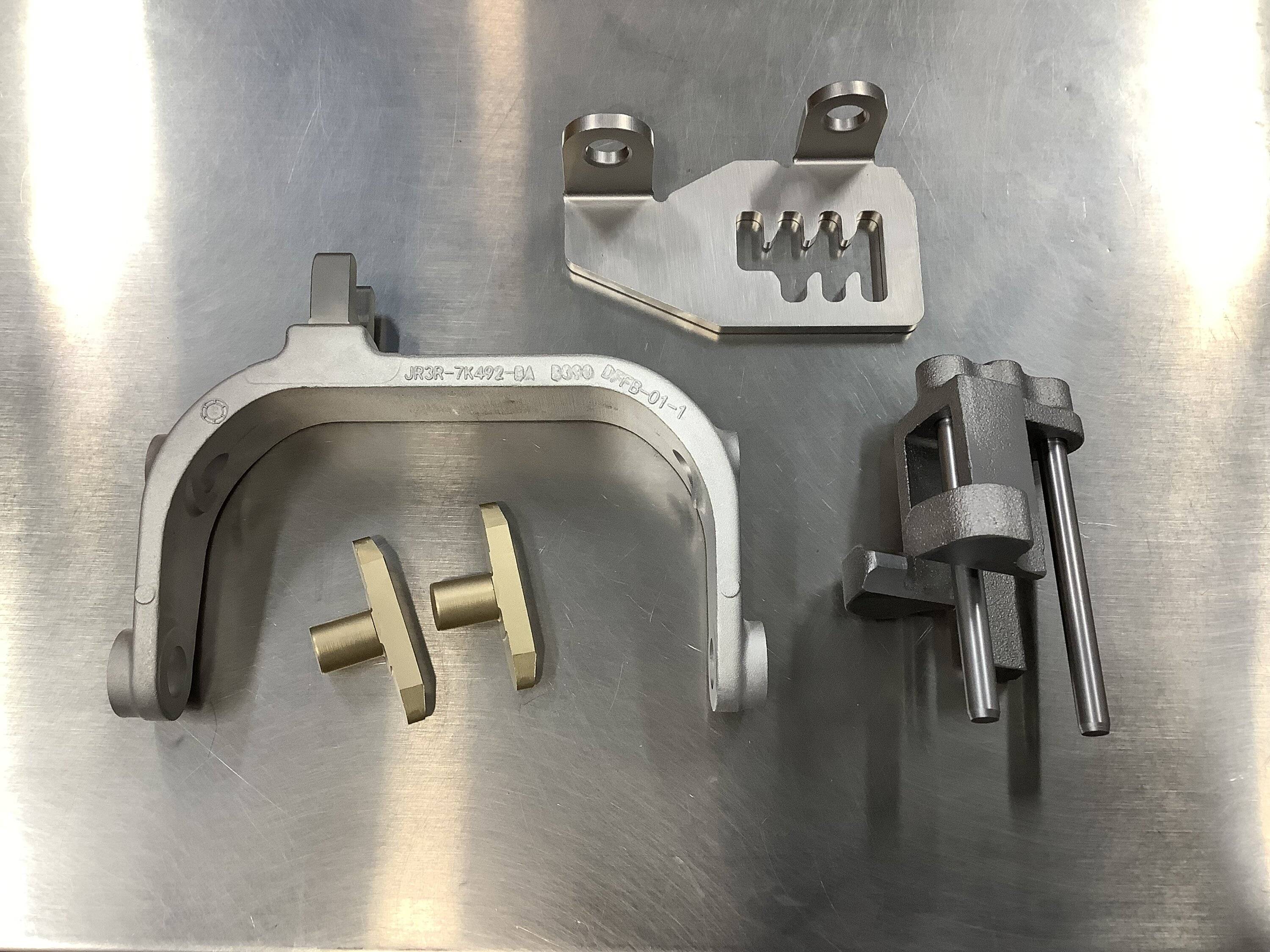

I’m not sure if this is your problem, but the reverse shift fork has plastic shift pads on it. I read somewhere a while ago, that someone else had one of the shift pads break and it caused major damage to their tranny.
When I changed mine out, I simply used a heat gun to soften them and pulled them out of their mounting holes.

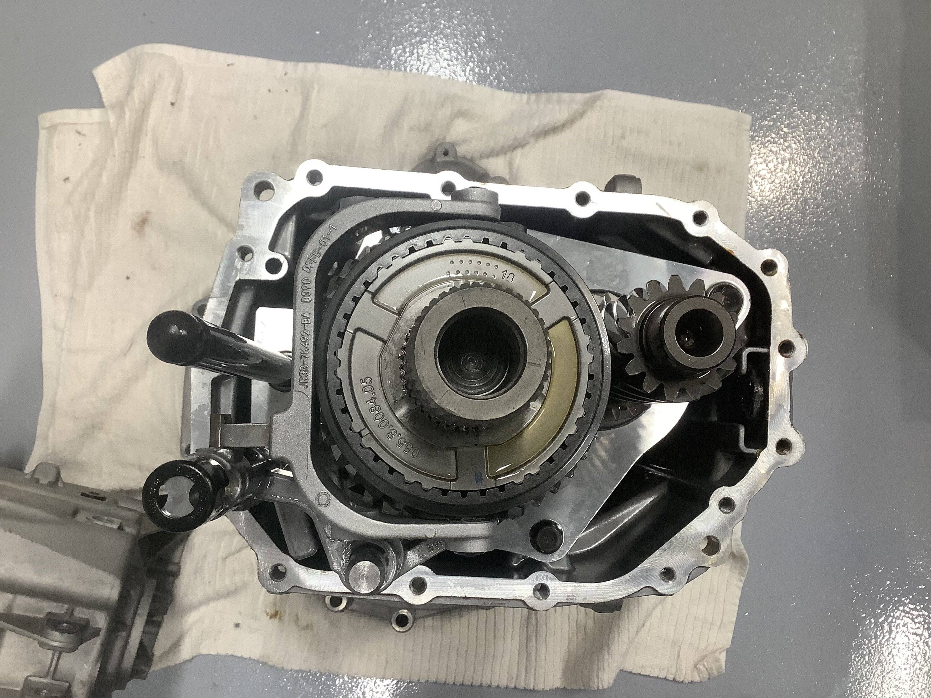

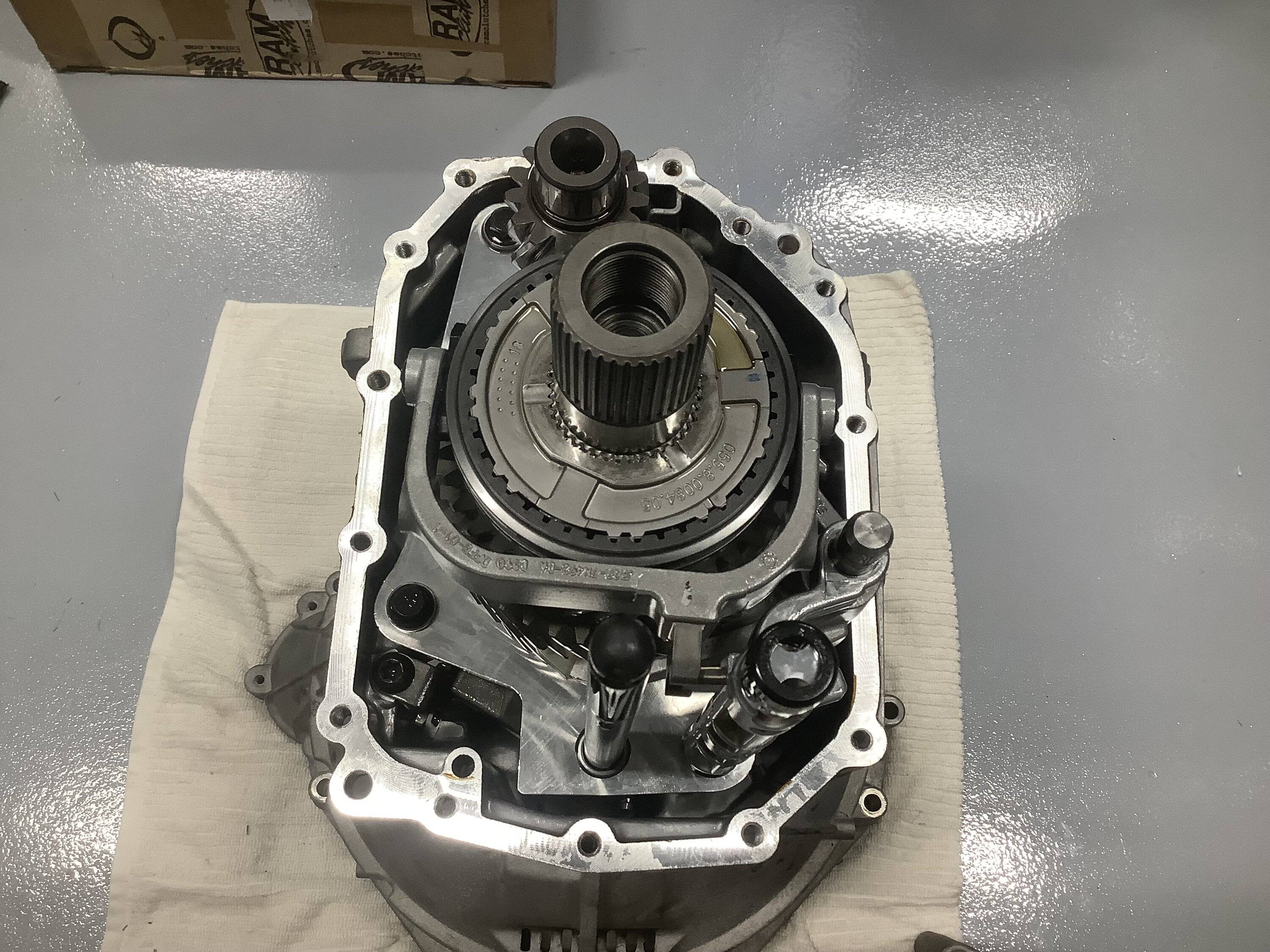

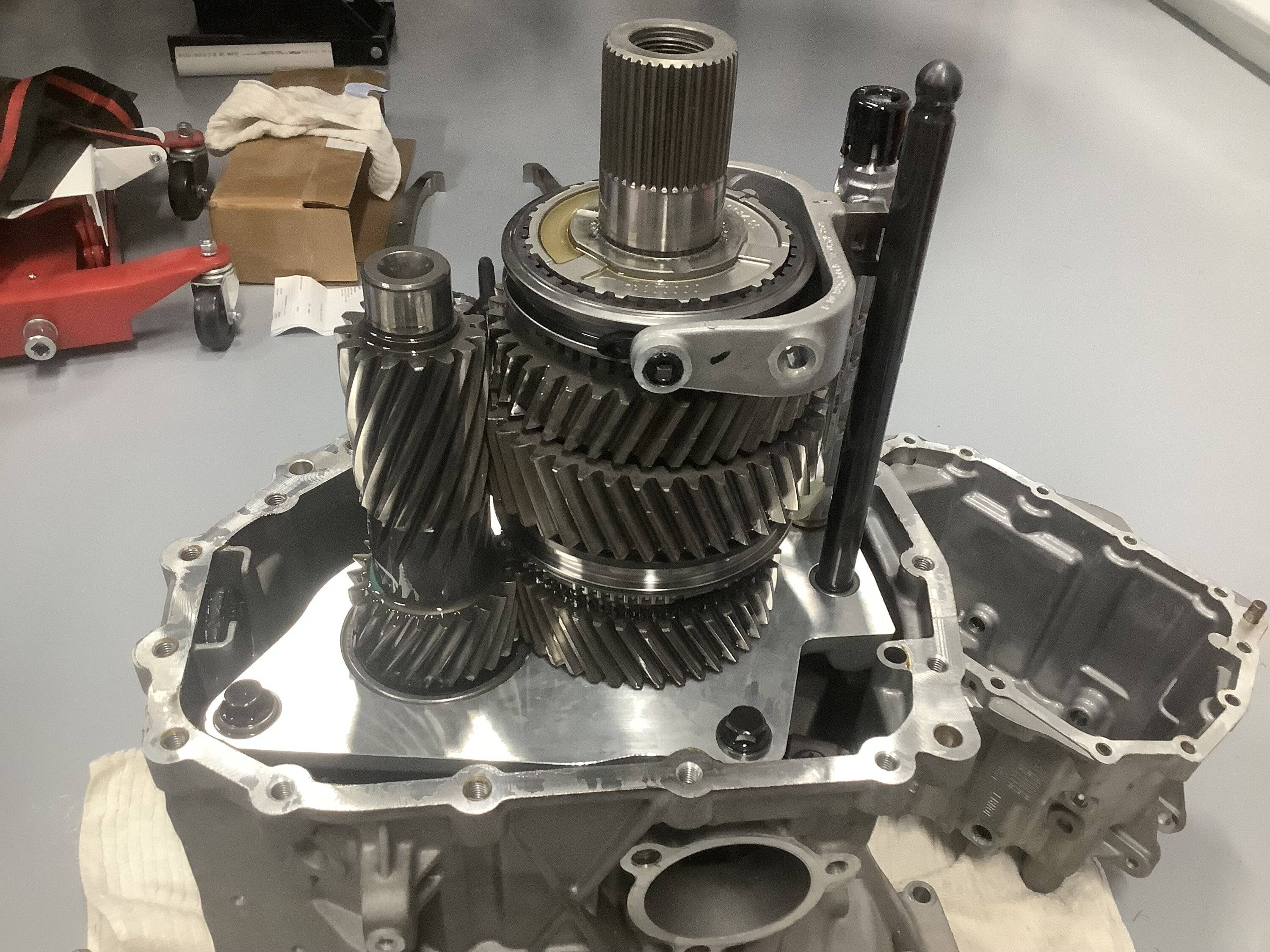

You won’t see much removing the shift knob and boot looking in from the top. To save you a bit of trouble, here are pics of how things look on the inside the shift rail engages the reverse shift fork.
