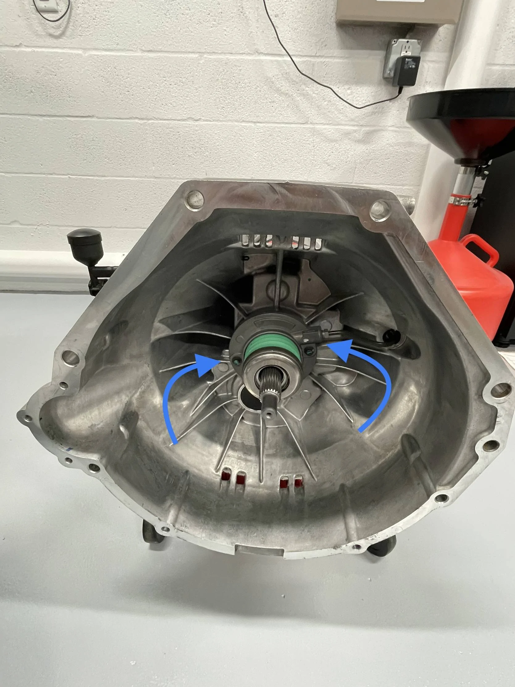

Where is the location of the Clutch slave cylinder?
It's going to be inside the bell housing of the transmission. This link will give you an idea what one looks like.
https://www.smfordparts.com/oem-par...EeR0mU0wsC0U6VF3UdOhVsm758xTccbhoC5rYQAvD_BwE
Sorry to say, replacing involves pulling the transmission. The work they did prior to replace the clutch, they'll perform again. The throwout bearing/slave cylinder is not all that expensive; it's a simple device. The cost is in the labor.

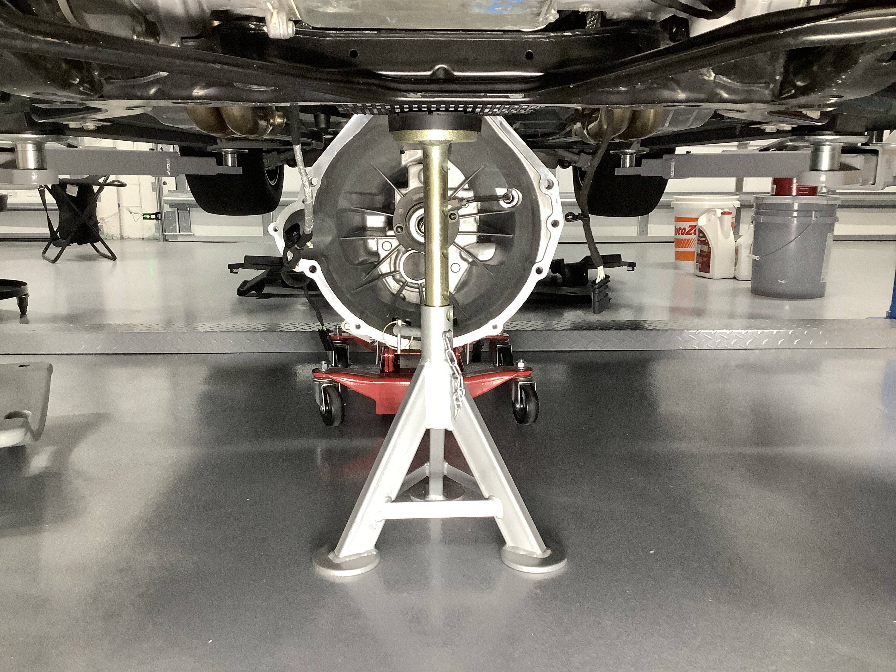

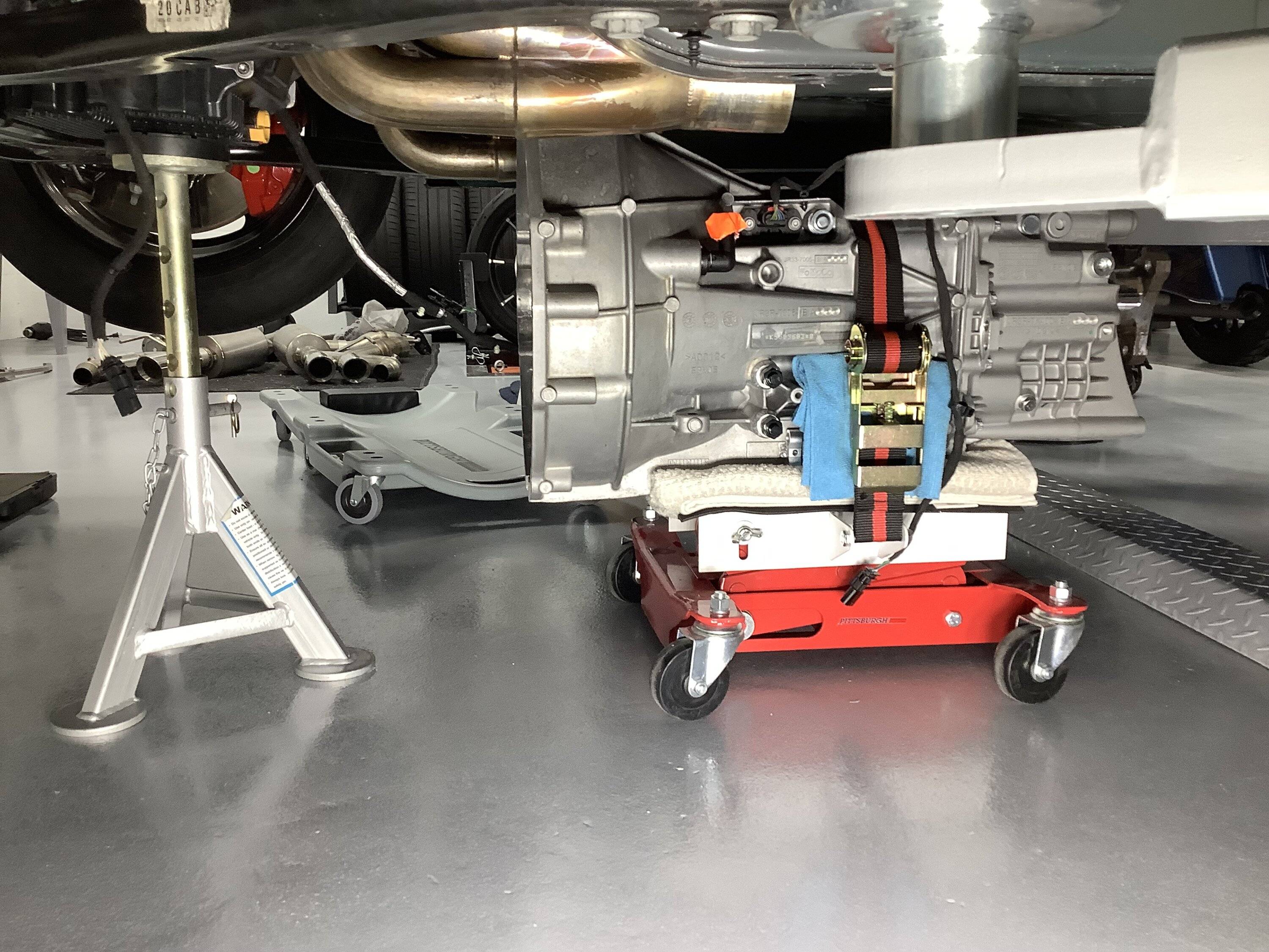

You can do it yourself. It will require disconnecting the clutch line from the tranny, followed by removing the driveshaft and unbolting and lowering the tranny to gain access to the slave cylinder. There are only two small bolts that mount the slave cylinder inside the tranny’s bell-housing. Bench bleed the slave cylinder and use a little blue loctite on the two bolts and torque to 89 in-lbs. You wont have to remove the tranny from underneath the car and it can remain on the transmission jack while you do the work.
