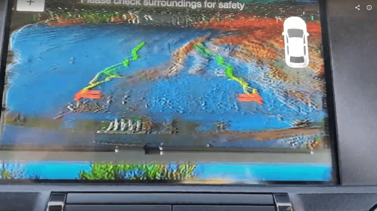

Just for reference:
Looks like what they ever did did not fix the recall issue. That is the kind of screen the recall is supposed to fix.

Just for reference:
Hold on. You thought this might be normal, just a little blurry compared to previously? How did you even leave the dealer without showing this to them immediately?

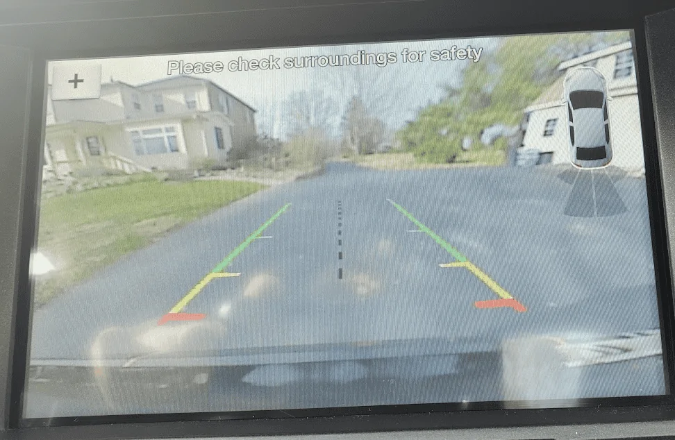

Ha, I should have been clearer! No, this just happens occasionally. Here is a pic of it in it's working state:
hard to take a pic of it.
Even if the distorted screen still happens occasionally, it is still not fixed. When I had a 2015 EB, my backup camera would sometimes not work, sometimes be distorted like yours, and sometimes fine. There is still a problem in your backup camera cable.
