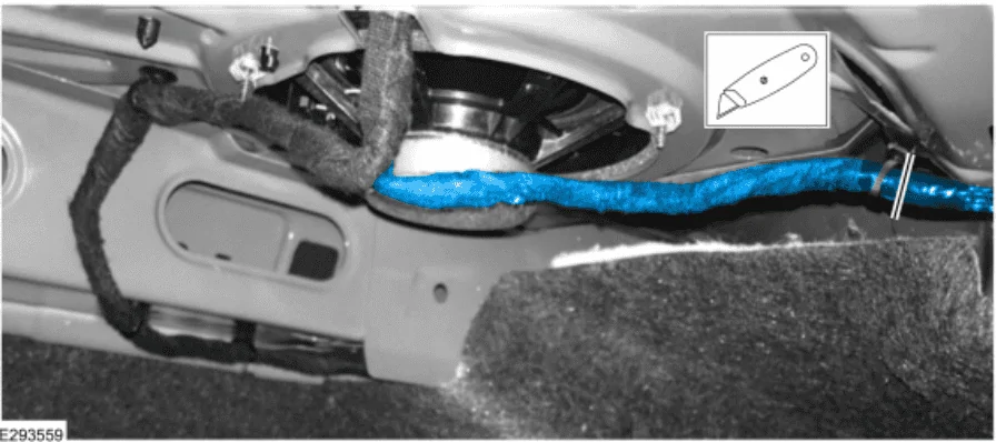

They do not need to remove that panel. Basically all they are doing is making the rear decklid harness longer by adding an inch or so near the rear speakers. The are cutting the entire harness and splicing in a new one, which is scary enough. I've already pulled the harness mount out so I don't get any chaffing. I'm going to ask if I can just take the harness in case I have trouble in the future. I don't want any splicing unless absolutely necessary. If it does need to be replaced, I'll do it myself too.

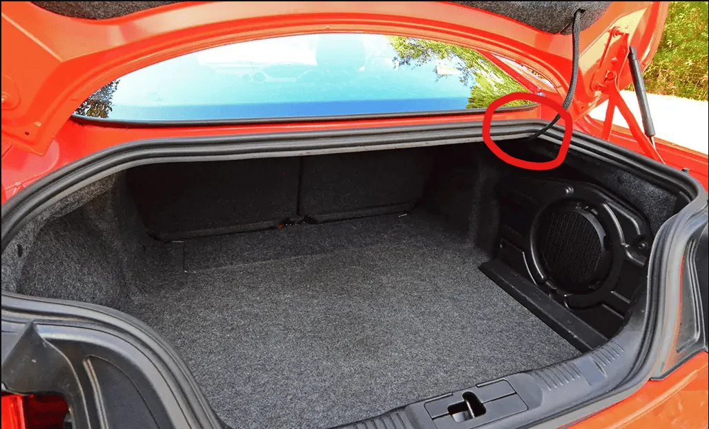

See the attached picture (not my car), the harness rubs in the circled area and causes breaks. About an inch in, the harness is attached to the body, I just removed that connection and let it sit loose, now it doesn't rub. I can't think of the term right now for the plastic piece that's taped to the harness that pushes into the hole in the body!

What Ford will do is inspect and repair ("SPLICE" an added length to) the cable to reduce stress on the cable. I strongly suggest you also release (disconnect) the plastic tie wrap on the cable and let the cable hang loose.
