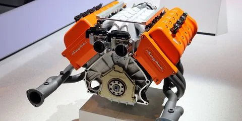

Koenigsegg engine
Lamborghini Huracan Engine 90 degree 5.2L Wide and tall as a mofo.
There is a Walmart sized parking lot area in the engine bay of the new C8 for them to fit a massive engine there. Only excuses and non-sense won't allow them to do so. The time is now or never for them lol :like::muscle::flag:
