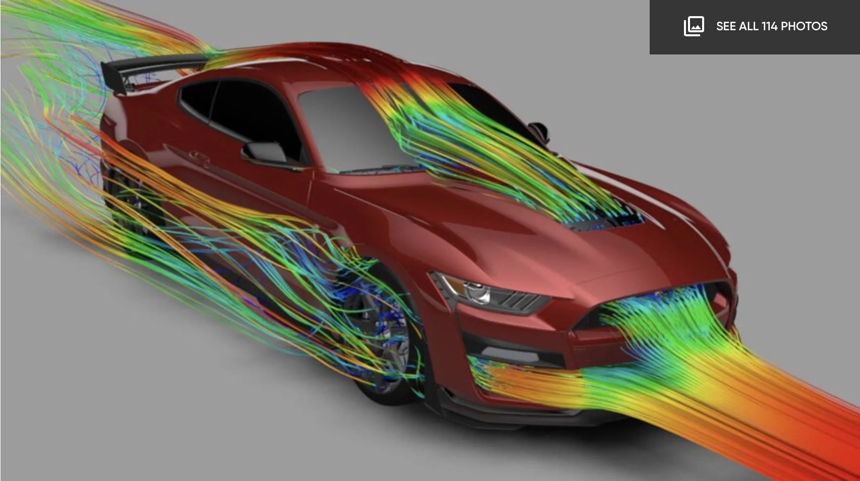

What we are calling "hood vents" are properly "heat extractors".
By design, at speed, the pressure behind the bulge (where the blinker is on '16s) lowers and higher pressure, hot air from inside the engine compartment is drawn out. There was a good wind-tunnel smoke test video made a few years back. Kind of a neat design.
And precisely why my open Roush airbox quickly returns to near ambient once moving as it's directly under the extractor. In addition, the OEM grille duct attached to the filter box feeds air in and allows the extractor to more easily perform its function.
