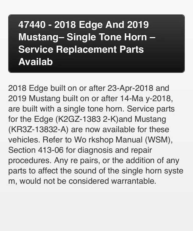

Pssst.... for those with the single tone horn, it didn’t only affect the Bullitt, see Ford SSM 47440.

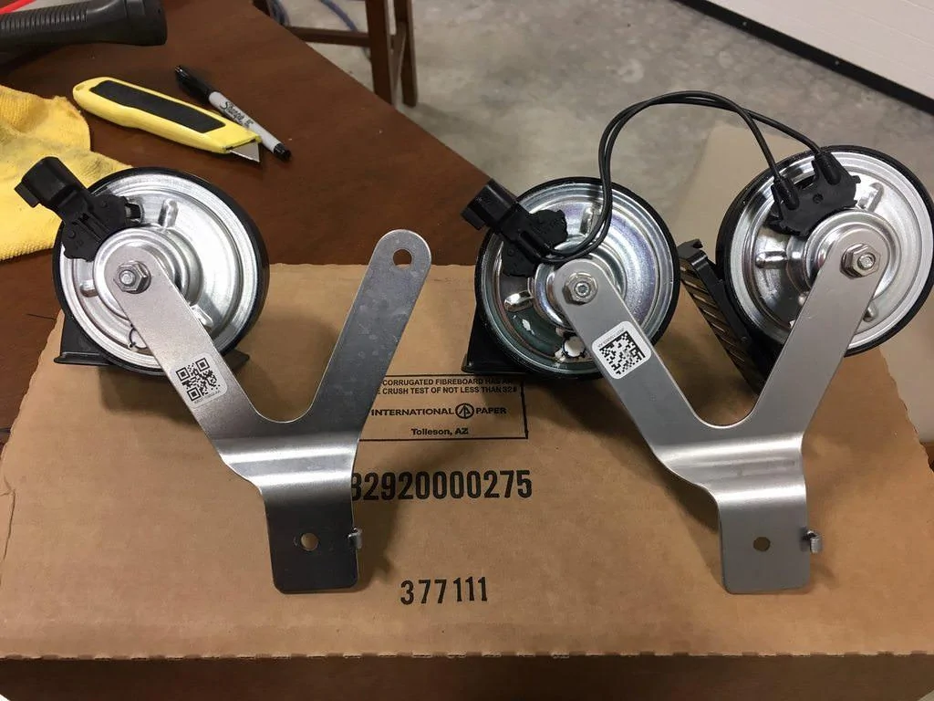

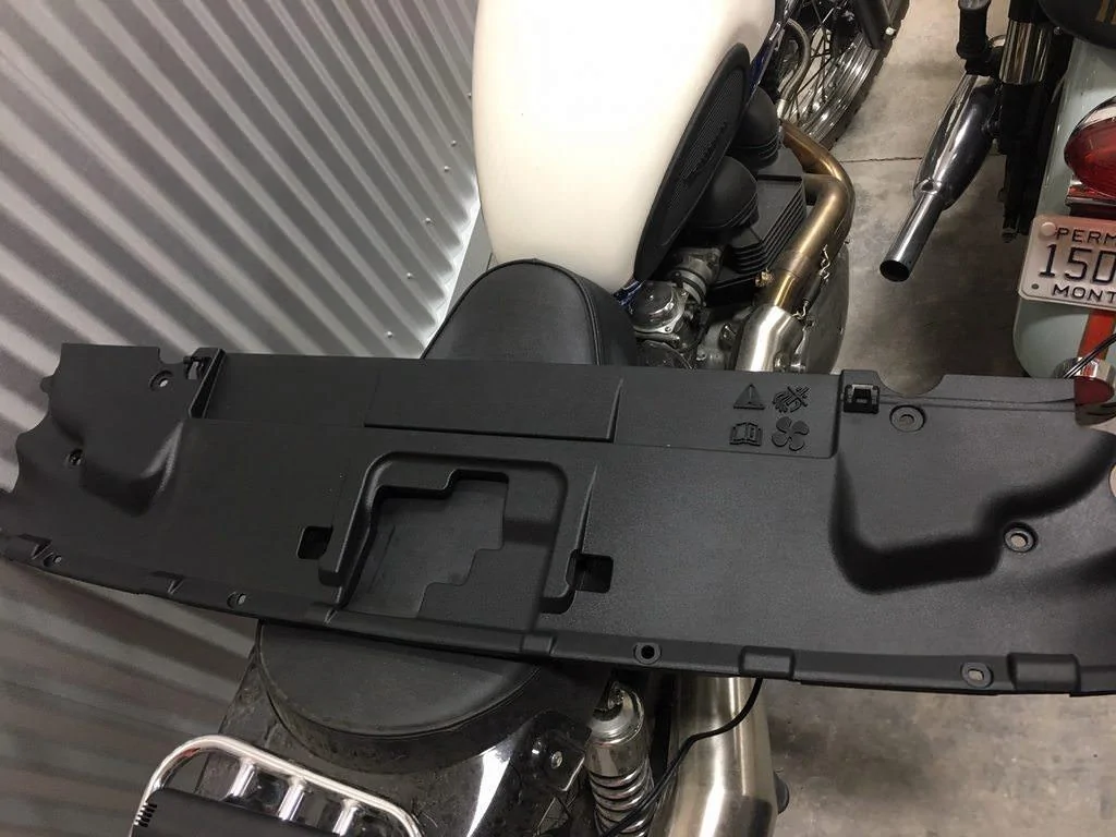

I swapped out the puny OE horn for the double horn referenced in the OP above. I did it from the top after removing the radiator cover, but in hindsight Shipey's dealer probably took the right approach by removing the airbox. I chose not to use the OE horn bracket; instead using the identical bracket provided with the dual horns. One bolt (8mm hex head), and it's out after undoing the connector. It can also be swapped from the bottom by loosening up the left side of the plastic cover, but again, the airbox removal is likely the best path.
Comparison of the OE and dual horns:
Radiator cover removed for access:

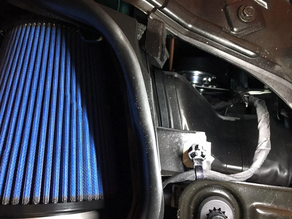

The horn is located at the end of the light:
Close up of the horn under the airbox; it's the shiny thing:
Thanks again to Shipey for doing the investigation and sharing the dual horn p/n :-)

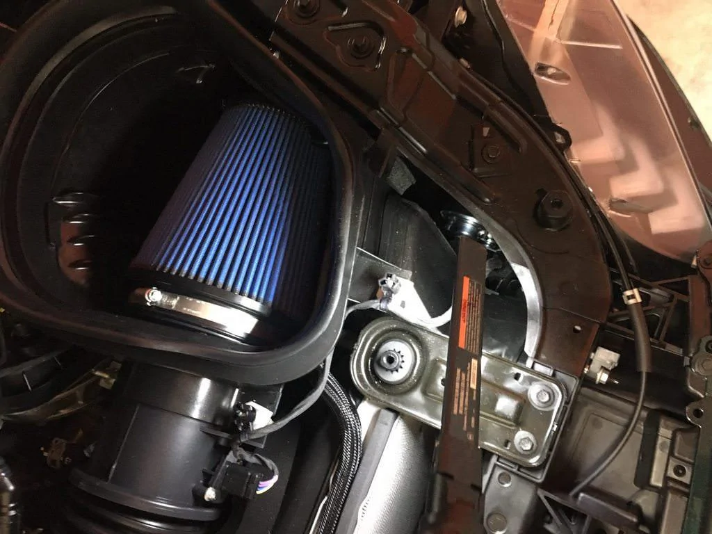

I just installed my dual horn setup. I initially tried the method used by aileron removing the rad cover but i could not fit my hands the small opening. So I decided to removed the airbox. This was much easier than I thought!!.. Completed the swap in about 20mins. Much better sounding horn. Thanks again Shipey for sharing this find and Thank You aileron for your install pics.
