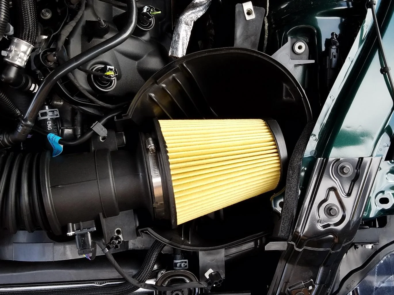

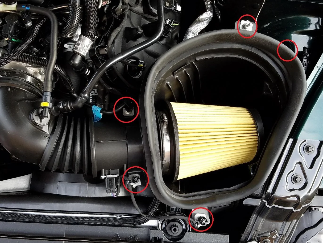

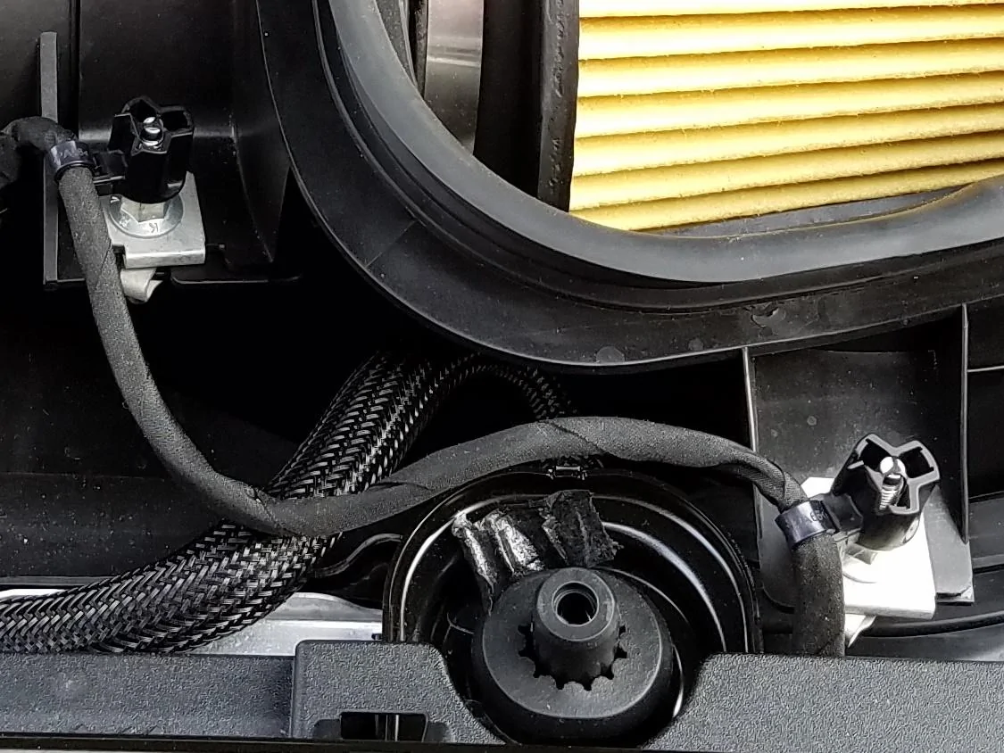

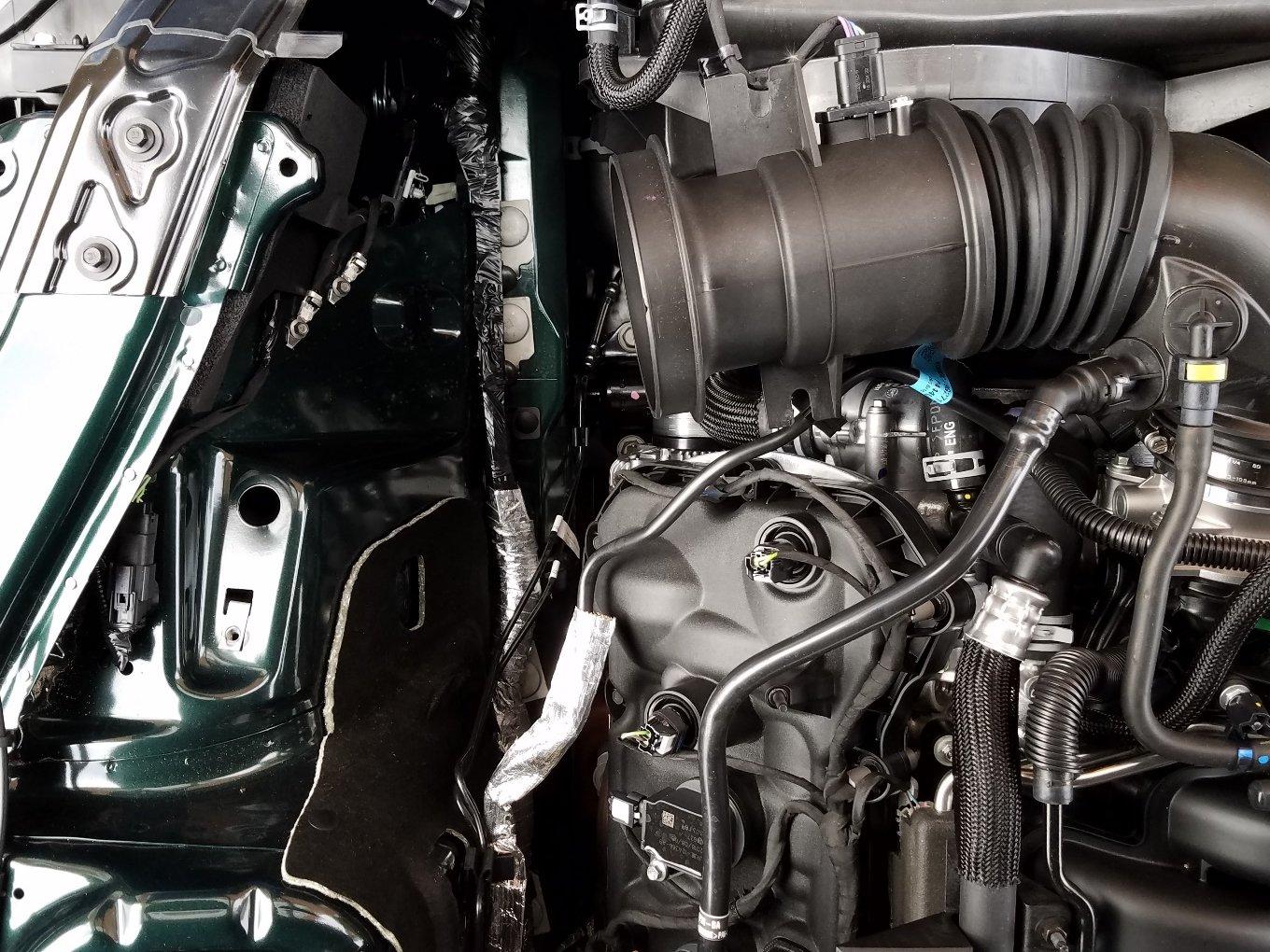

Here are a few pics I took when taking out my air box.
Remove 5 screws. There are connectors on top of them holding wires in place. See next pic.
You might have to loosen the band clamp at the throttle body to rotate the air inlet tube up enough to get the filter out.

Awesome! Just what I need. So: 1) the box needs to rotate up, and 2) the filter has to come out?

The box needs to be removed. The hose/tube going into the box may need to be rotated up. The filter has to come out to get the box out.

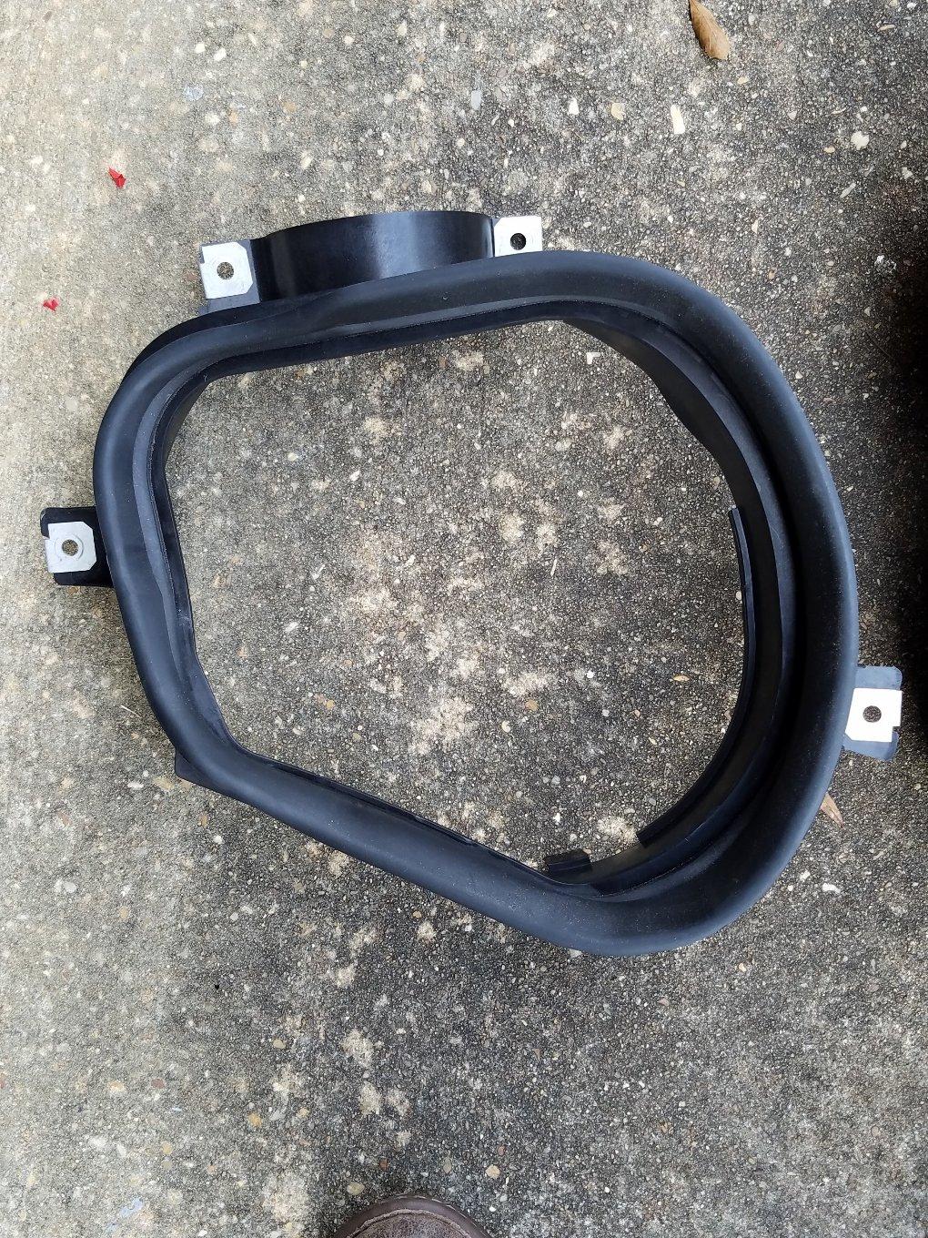

The forum is turning this pic upside down for some reason. I'll fix it if someone will tell me how.

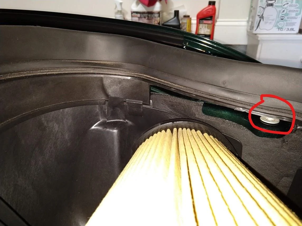

Finally got around to adding the 2nd horn which wasn't too bad after removing the throttle body which I found so much easier and less stress on the hose so my hats off to those that could do it. Anyway, I have a couple of questions regarding the factory install of the airbox itself and the gasket that sits on top of the airbox that seat against the hood when it is closed.
1) There is a piece of foam in one of the photos that were not fitting correctly inside the airbox and I was able to adjust but still doesn't look perfect (OCD on my part). Does anyone have any idea what that p/n may be? Mine was torn during the assembly it looks like.

2) The silver sleeve that fits into the fender where the gasket sits has a little nipple that rides on top of it doesn't seem to line up too well but I am sure that it is making good contact once the hood is closed. I wished I paid better attention before removing it that way I would have known that it was there the whole time. Funny thing I tried to adjust it but didn't seem to matter
Is everyone seeing the same thing? I will try to go by Ford and look at 2 Bullitts that are in the showroom and compare.
