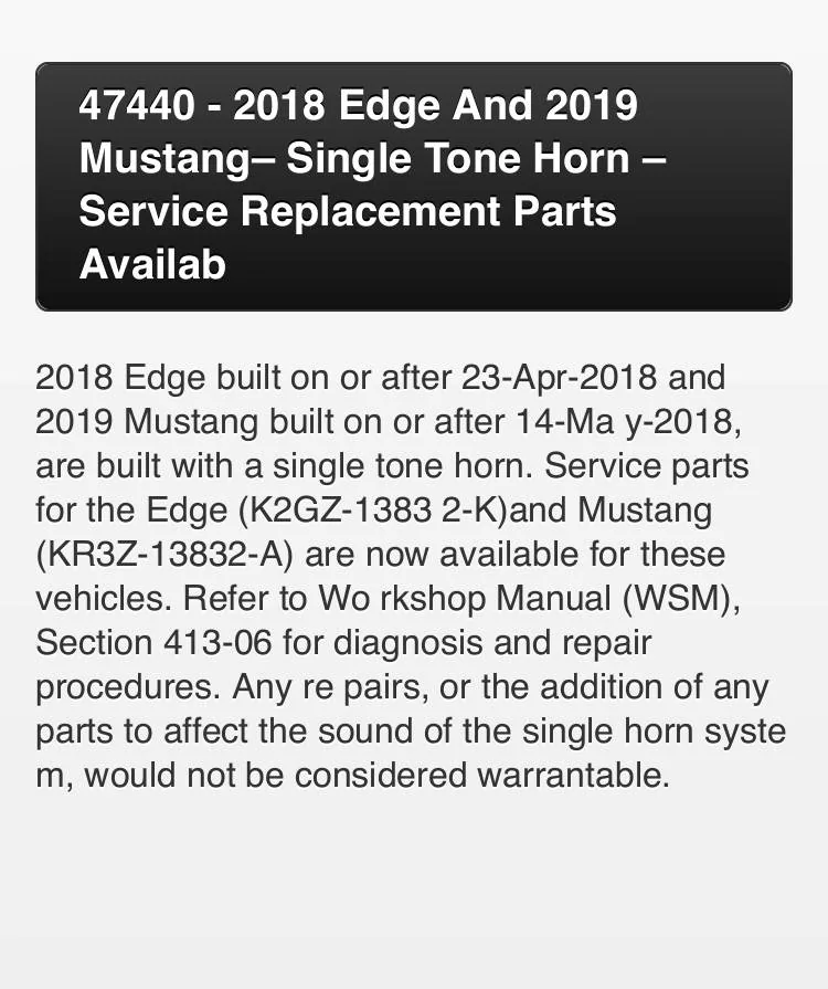

Ford reduced cost in 2019 by deleting the dual horn setup to a single horn, as opposed to the dual (L and R) horns.
A Ford SSM was also released telling Service Centers that it was a running change and that it’s completely normal in the event a Customer has a concern.
