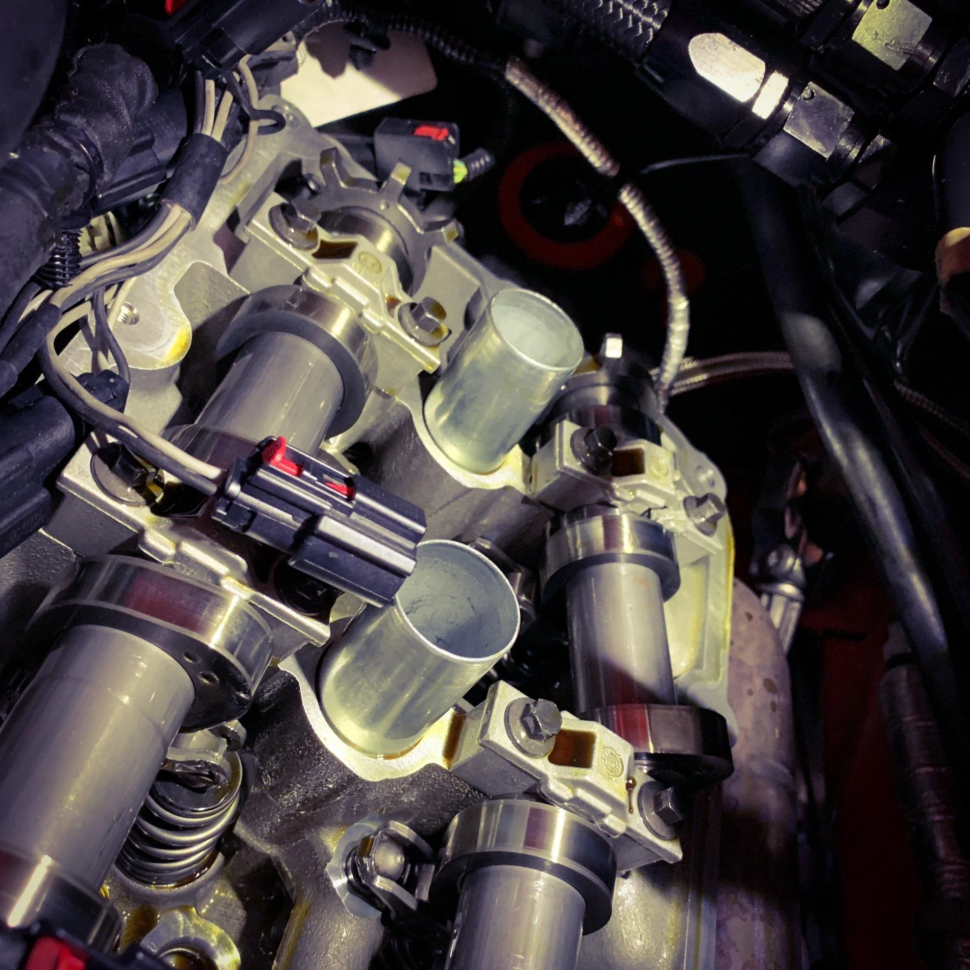

My recent build failed after 1000 miles. The cause being relayed to me is the piston rings unseated on 3 cylinders due to excessive heat causing massive blowby and spraying oil everywhere mostly back through the throttle body and air intake/box filter etc. Cause is being said to be going lean due possible to
#1 Fuel System Aerated. #2 Bad Fuel #3 Too High IATs. Any thoughts on this? See below
#1 - I went into boost and as I did, the 1/4 tank light came on saying I have 50 miles to empty. Saying the fuel pumps Aerated due to low fuel? I had 1/4 of tank = 4 Gallons
#2 - I am running 93 with 32 oz of Boostane Professional in every tank to protect against bad tank
#3 - IATS were not out of the ordinary.

All involved are working together at this point to get this resolved. No one has discussed $$ in either direction. My focus is why this happens and how to plan and safeguard for this not to happen again.
If you focus too much on this they will know that they can screw you and you will end up paying all the $$, from what I have read there are three parties to this. You, the engine builder and the tuner. Unless you insisted on parts that either of the other two parties didn't want or didn't know about (fuel system) then as far as cost goes you are out of the equation and it is up to the other two parties to rectify the costs and repairs.
Personally, I think I'd lean towards the tuner only because of that one statement from you "Tuner had it from start up tune until it was ready for delivery. Took a full 2 months at the tuner from when he started on it. He was responsible for break in. daily driving it etc etc. so when i got it was ready to go. i think about 500 miles were put on it with the tuner"
What reputable tuner needs 2 months and 500 miles to tune a car!!

#1 went lean when fuel pumps starved for fuel with tank that low. Should only do pulls with minimum half tank. The stock and stock type fuel hats can’t keep full of enough fuel when hard accelerating.
Has a Fore return style fuel system. But let's be realistic. This is a weekend car. If I am on the highway and go below half a tank I can't put my foot to the floor and go into boost? It only gets about 200 miles to tank. So every hundred miles I need to fill back up to be safe? Or granny the car. If that was the case should have been explained to me from day one or at least at delivery or some other time during the build. Never told that ever.

On my '18 once I installed my new fuel system this spring, I found I needed to keep more gas in the tank. I had that same low fuel chime just pop on where it also said '50 miles to empty' and tried to roll into it for a quick 3rd gear log. It chugged and nosed over so I got out of it very quickly. I then went straight to the gas station, filled up and the next pull was clean and full power.
I would suspect that you starved your engine just long enough... all it takes is to be lean once.
I never let it get less than 1/2 tank now.
