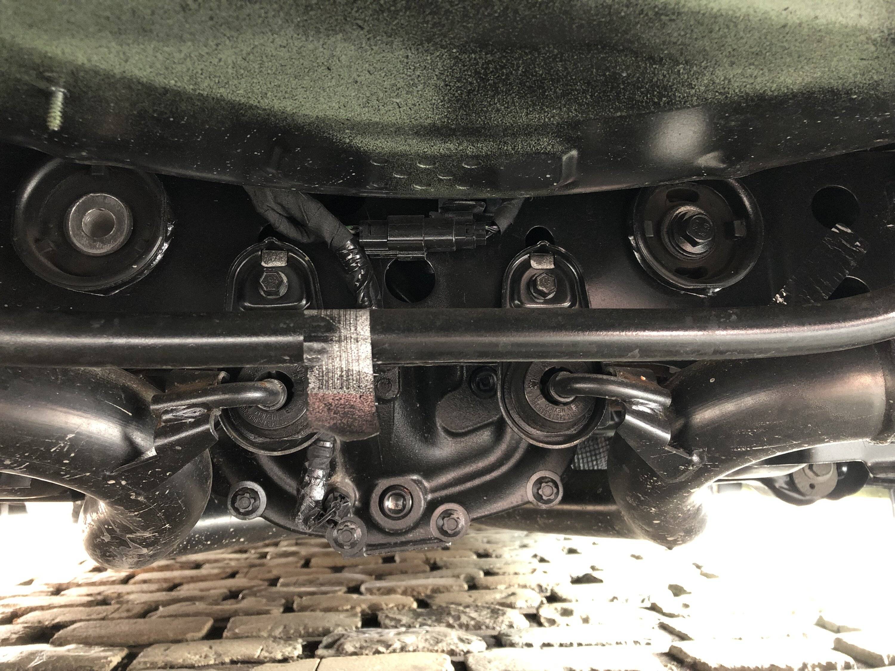

Right, yes I was sitting still, foot on the brakes. Car didn't move and stalled out. What a stupid mistake! I was on the side of the road and in a hurry + stressed + distracted when it happened.
I will check driveshaft play once up on the ramps. Nothing determined yet.
I think you’re good. Take a look here.

I hope you are right! I bailed on the home diagnostics and just took it to the dealer, so I will have to wait to hear back from them.
I have my doubts it's just driveline slop though. It is a little hard to describe what I am experiencing and I really should have taken a video. I feel fairly certain there is something moving around under the car that's not rigth. It is not so much of a clunk, but 2 or 3 pops the happen once you get on the gas. It really sounds like a broken bushing or mount to me.
Would you mind elaborating a bit more about what I see on those pics? I mean I am genuinely curious about that and envy everyone who can tell just by looking into random dirty tube :wink:
That dirty tube should have a bolt in it! And what you see on the other end of the tube is what's left of that bolt after shearing off and leaving part of it threaded into the diff (I think?)
Yeah that’s exactly right :like:
This is looking under the back of the car :
Note the left diff mount bolt missing - easy to spot with a euro due to the black crap and the nice silver paint free area … :like:

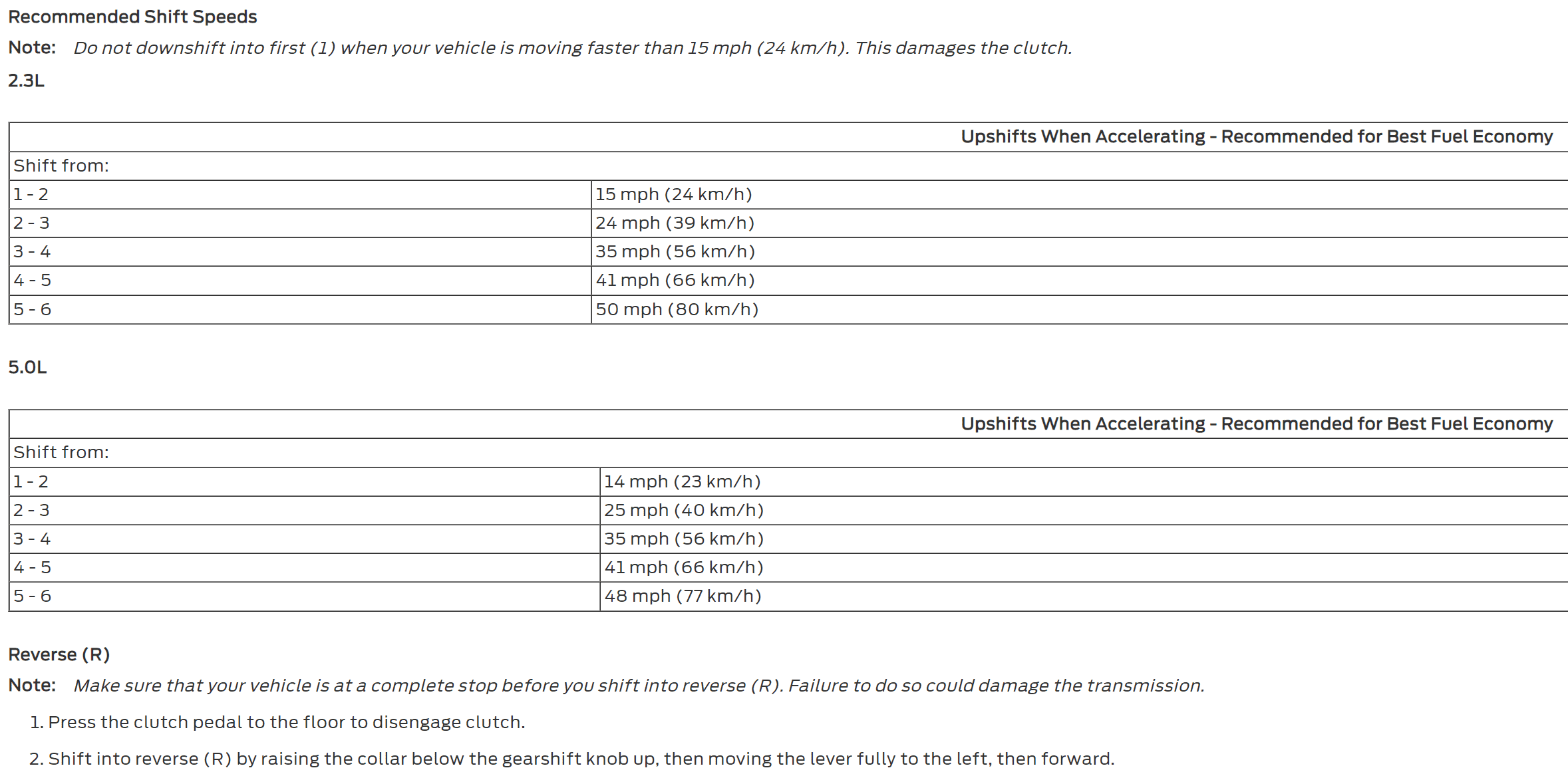

There is a note in a user manual that you should not shift into the 1st gear when driving faster than 15 mph (or such), otherwise it will damage the clutch. They do not say how though.
Interesting detail about this statement is that it is a kind of definitive. They do not say "may" or "could", just "it will".
Its just a disclaimer for the people without common sense. If someone puts it in first going that fast, that person should NOT drive a stick shift.
The 2022 Owners Manual states the following:
"Do not downshift into first (1) when your vehicle is moving faster than 15 mph (24 km/h). This damages the clutch."
I guess they rephrased it in a new version. I was quoting 2021 Mach 1 Supplement :wink:.
