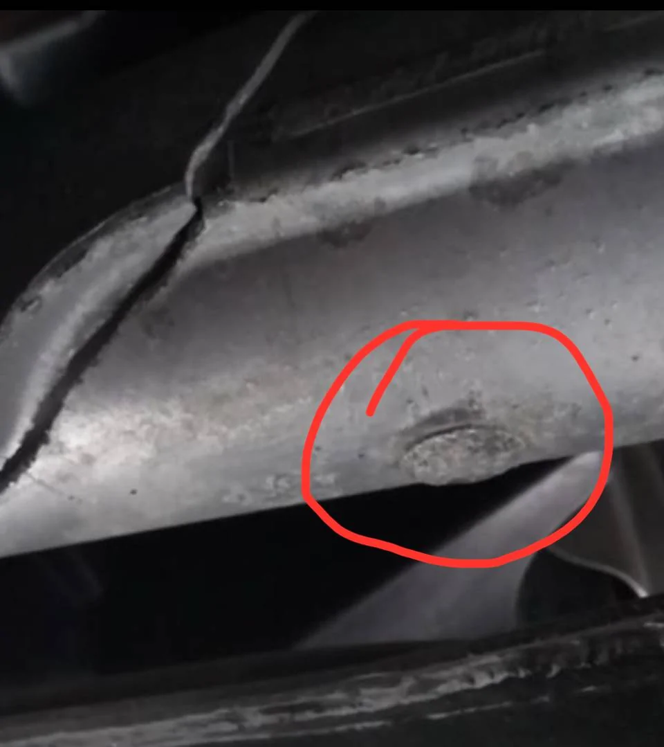

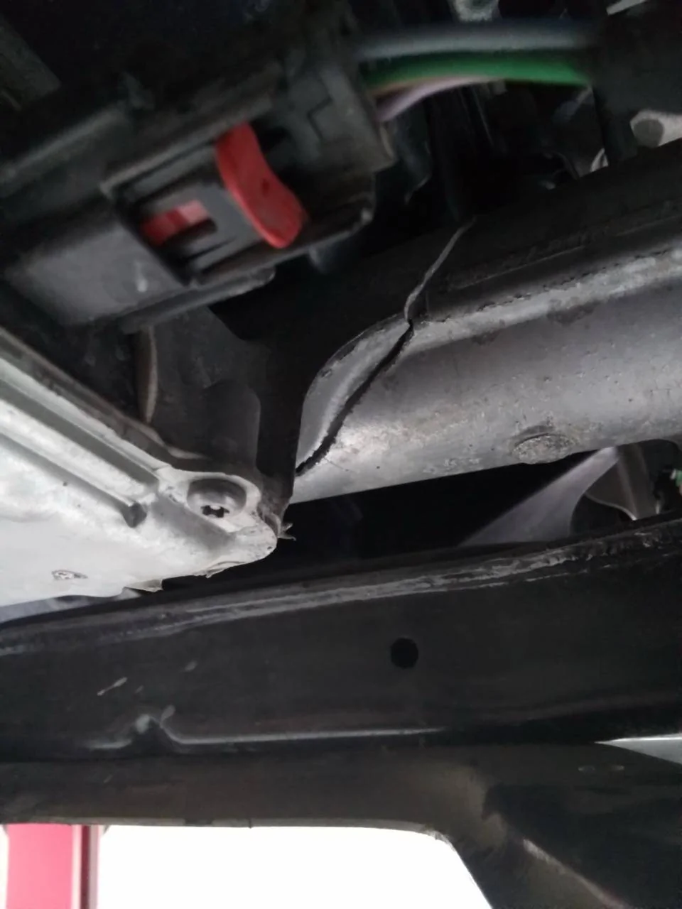

After having a shop replace the seals on my differential, i started hearing some clunking noises from the suspension, and my steering wheel wasn't centered, so I brought the car in for a check-up. They noticed that the steering rack had a large crack in it.
Anyone have any idea how this could have happened? There isn't any damage anywhere else on the car.
Also, is the replacement steering rack Mach 1 specific, or will any 2018+ S550 steering rack work?

My initial thought is that, during the work being performed, the repair team selected that area as a jacking point by mistake. Or, a jack or tool they were using slipped while repairs were being made, with the force of that object striking the column.
To break the column in a driving accident, I'd think there'd have to be additional tells and other damage.

Was the car a prior “salvage” S550 brought over from the US? Seems like a lot of S550’s wrecked here in the US are then imported overseas for a cheap fix and alternative to owning an S550.
I have not seen or heard of any S550 EPAS units being cracked like that without any prior impacts from road debris, driver inflicted damage by hitting an immovable object like street curbing or cement barriers with the wheels, careless jack points (as mentioned above) or accident damage.
In any case, if that Mach 1 was purchased new by the current owner, and if it does not have any accident history, that should be replaced under warranty through Ford. Now unless they find any prior negligence, that may negate a warranty repair and replacement.

The answer to your question appears to be in the pic you posted.
That caught my attention as well. I'm not sure what that area should look like, but it is suspect. The disc seems to protrude, but then maybe putting a jack at that location deformed whatever that disc is, creating the protrusion.
That's looks like an injection runner site. This where the molten aluminum flows into the mold. They are cut off after the part is ejected. There can be several of these on large cast metal parts.

I had this thought as well, but unfortunately the shops here don't take responsibility, and you can't do anything about it. It also seems unlikely given that the crack is right in the center of the car and there wouldn't be any reason for them to jack it up from there even if they could.
