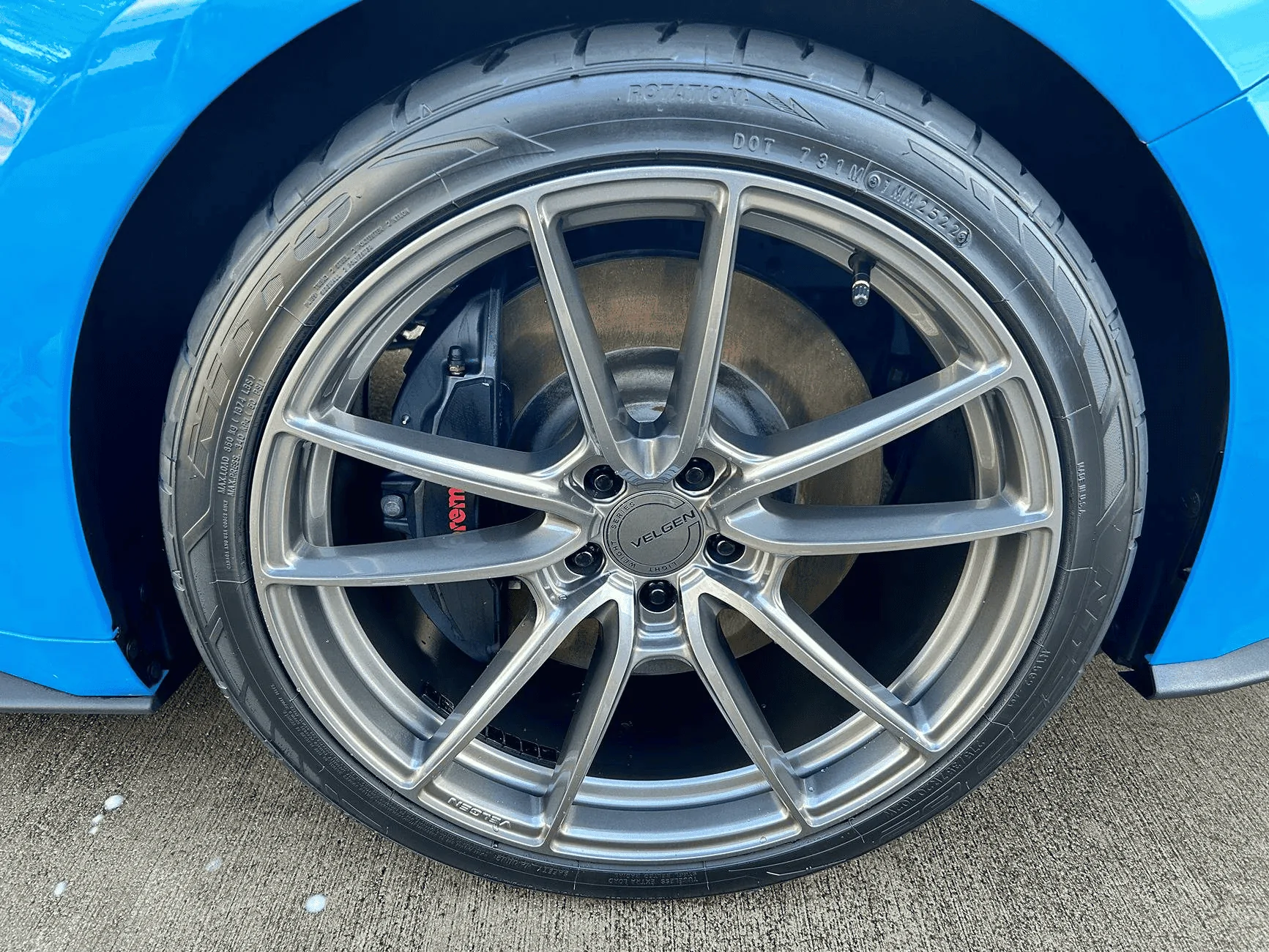

That's weird the way that wheel is dished in the back. I've never seen a wheel like that. My 19s clear with like an inch of clearance

the issue is not the clearance with the spokes/inner face of the wheel, it is with the caliper scraping the inner barrel of the wheel
Sure sure. And a 3mm space won't address that. I recommend grinding any high spots off the capiler if it's a couple of small places. Otherwise it time for different wheels.

As others have said, there should be plenty of clearance on a 20" wheel, these are only 19s and there's masses of room.

18" Apex wheels clear those brakes. Even the old $150 OE Wheels 19" Performance Pack knock offs cleared those brakes with a mile of room. I'm sorry, I can't wrap my head around a 20" wheel not clearing these brakes.

The stem location is so far back in the wheel, odd design so that is why it probably is not designed for big brakes.

Thank you all for the suggestions. I want to clarify that the issue is not the clearance with the spokes/inner face of the wheel, it is with the caliper scraping the inner barrel of the wheel

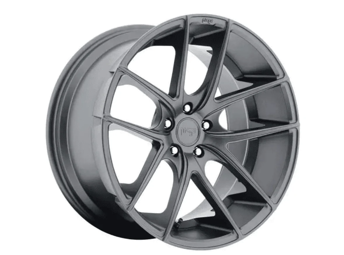

It is and it isn't. It's not an issue with the outer spokes, but people are referencing how far back the spoke design goes in comparison to most options. The inner "lip" on these wheels and the angle from that "ridge" to the spoke makes you 20" wheel closer to an 18" wheel where clearance counts near the back side of the spokes.
You can see below how the "ridge" and back of the spokes extend to almost the middle of the barrel of the Niche wheels where as on the Velgen wheels the spokes and "ridge" are only about an inch or so deep. If you can space the wheel out enough that the caliper can get more distance away from behind the face of the spoke then you'll gain clearance. If nothing else you can probably get it spaced far enough that the tire fill valve isn't near clipping.

There's all kinds of stress risers in this design it makes you wonder wth were they thinking?
They make right angle valve stems which will easily solve that problem.

Thanks for the insight and replies. Unfortunately these were the wheels that were on the car when I bought it used. I'm definitely going to go the route of new wheels since these are really heavy as well

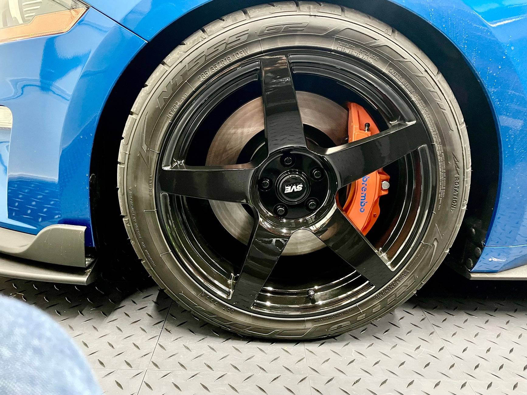

I have these wheels that have a similar lip on the inside that barely rubbed my brembos. Luckily I had spacers on hand so I put 20mm spacers on which allowed the inner lip to be offset from the caliper. I'd recommend just putting on some spacers.

What width are the wheels? With 20mm spacers that’s gotta be some decent poke, no?

They are 20x9.5. not sure what the offset is, but theres no poke. I am running 2.25 degrees of camber though so not sure if it would poke with stock camber. I have a set of 19x10.5 +45 and I run the 20mm spacer with those which is why I had spacers on hand.
