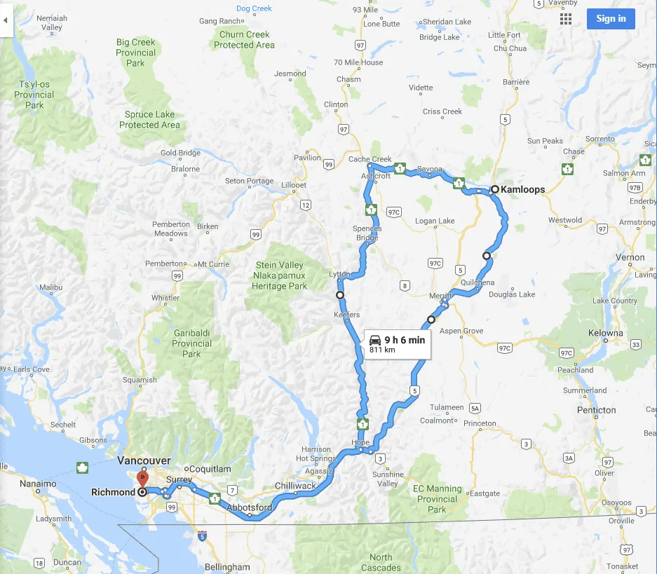

    Well, I am 140km (85m) short of 1,000 miles, and have generally kept it under 4,500. Hit 4,900 on a couple of down-shifts. I'm going for a 800+km (500+m) run this Friday. I plan on taking it easy the first 150km, then I will hit the moutan roads and will start increasing the rpm's over the balance of the trip, and get close to redline before the end. So not going to pin it at 1,001 miles....., but ease into it.
    Don't plan on an oil change until 6 months (probably <3,000 miles.....won't get driven much in the winter)
    Weather looks good, so pending no change, here's my route. Should be a fun drive...... road trip.PNG

    Well break-in drive done. Now have 2,300 km (1426 mi) on the odometer....Did the drive exactly as in the map. Beautiful day. Left a little late 07:45. Lowest temp in the mountains was 9C (48F) and highest on drive home was 27C (81F). Will start another thread with a few pics and my thoughts.....
