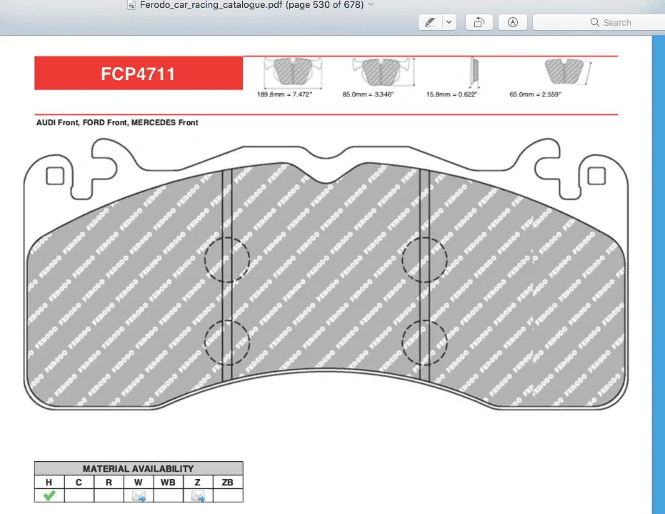

Ok great question, I actually love the Pads that come with the M1 for the stopping power, little fade and rotor wear. Yes it does have a lot of dust but 3 out of 4 is fine.
I went to Ford to order them and (2) different part numbers come up, (1) is a Police pad (with (1) slot). The rendering below has (2) slots and that's what comes with the car. To me the compound appears different as well.
Here's what I found similar to the above.
Front Pad:
Ferodo FCP4711 (makes it for Brembo) compound DS2500
Ford MR3Z-2001-C (2-slot)
Brembo #98.5031.40
Front Pad FR3Z-2001N-BRF1553 (1 slot)
Police pad
Specs
Front Pads 15.85 mm
Front rotors 34mm 35mm
Now, I to would like to find out who sells these for a discount? Plus is Ferodo DS1.11 different then above Police pad?

MY DS1.11 have 2 slots. They do not come with the brake wear sensors.
