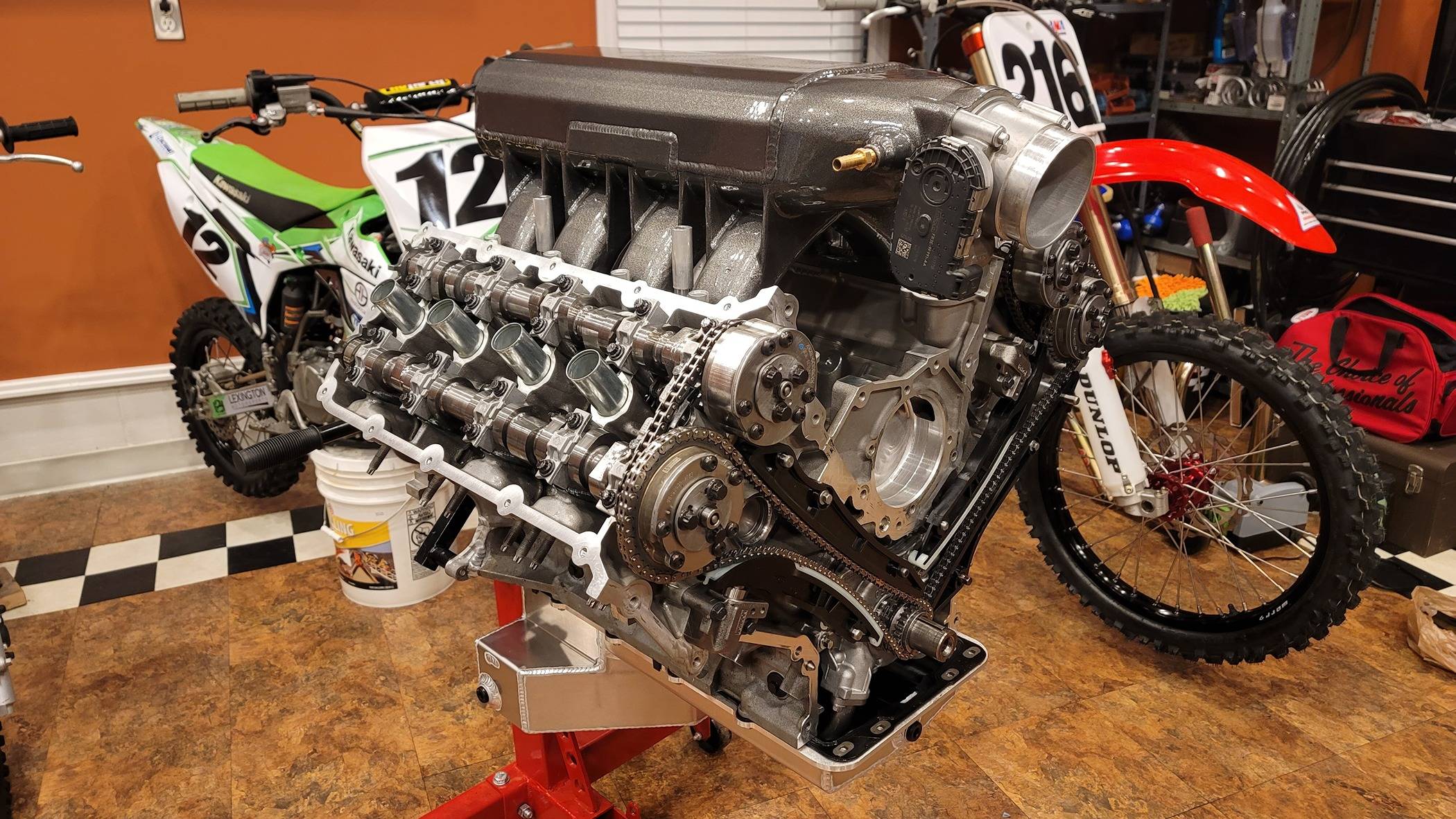

Heads were torqued to 100ftlbs per arp instructions with arp lube on threads & bottom side of nut / top of washer. Engine is back in should be running soon. That gasket def had more than 1000 miles. I had a few engine builders look at them they all said the same thing. Hopefully it’ll go 8.99 Now.
