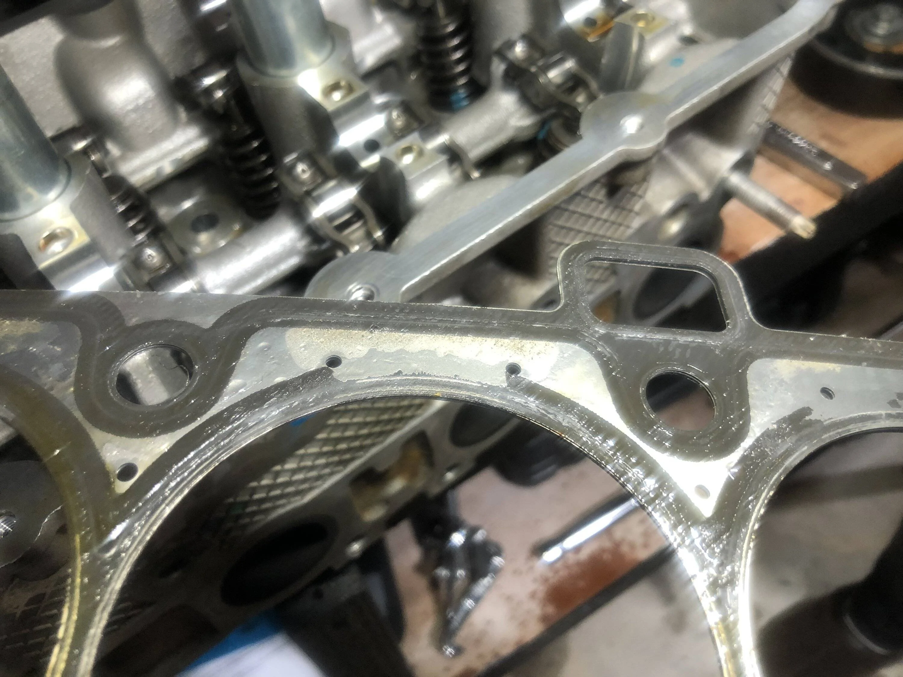

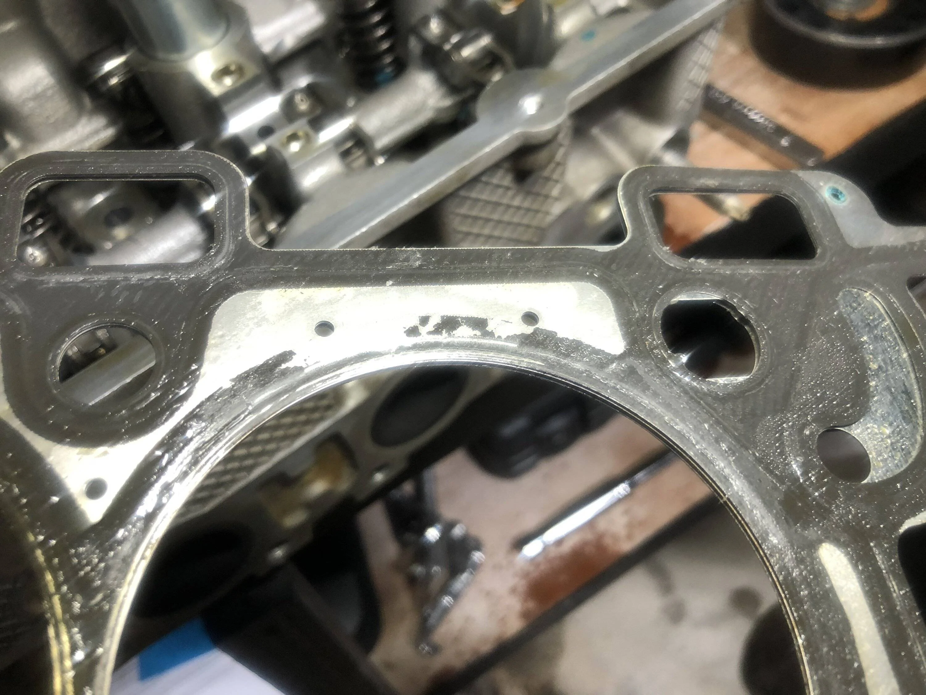

Noticed coolant dripping into #5 cylinder when engine was cold. The shortblock is a forged RPG unit, headstuds, stock headgaskets. The shop that installed the new shortblock claimed they used new headgaskets, engine had 1k miles and around 20 1/4 mile passes. Heads were removed from the previously blown up engine & definitely not resurfaced. Do these look like 1000 mile headgaskets? The material missing is not stuck to the block.
It's awful how skimping on a $30 gasket can cause so much grief. With that said, that doesn't look like a newer gasket

Send the heads out and have them checked. What kind of power are you throwing at them?

Just got the heads back, Resurfaced & pressure tested. Machine shop also said gaskets looked used. Not sure on power it traps 151+ mph 4000lb race weight.

Resurfaced? Did they say how off they were?

.004 isn't much. Hard to say with the gasket, but .004 shouldn't be enough warp to cause it to blow.
No wouldn’t think so. I’m thinking they reused the gasket. The material missing wasn’t stuck to the block. Stock headgasket isn’t recommended for this boost / power level.
