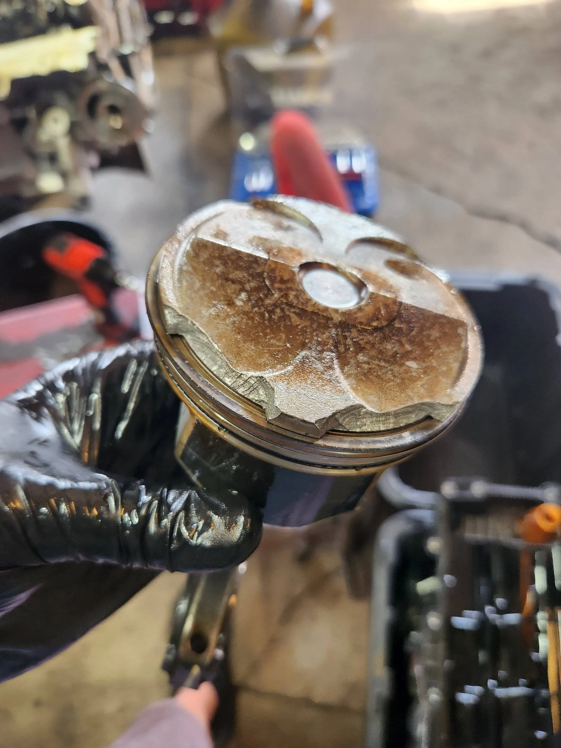

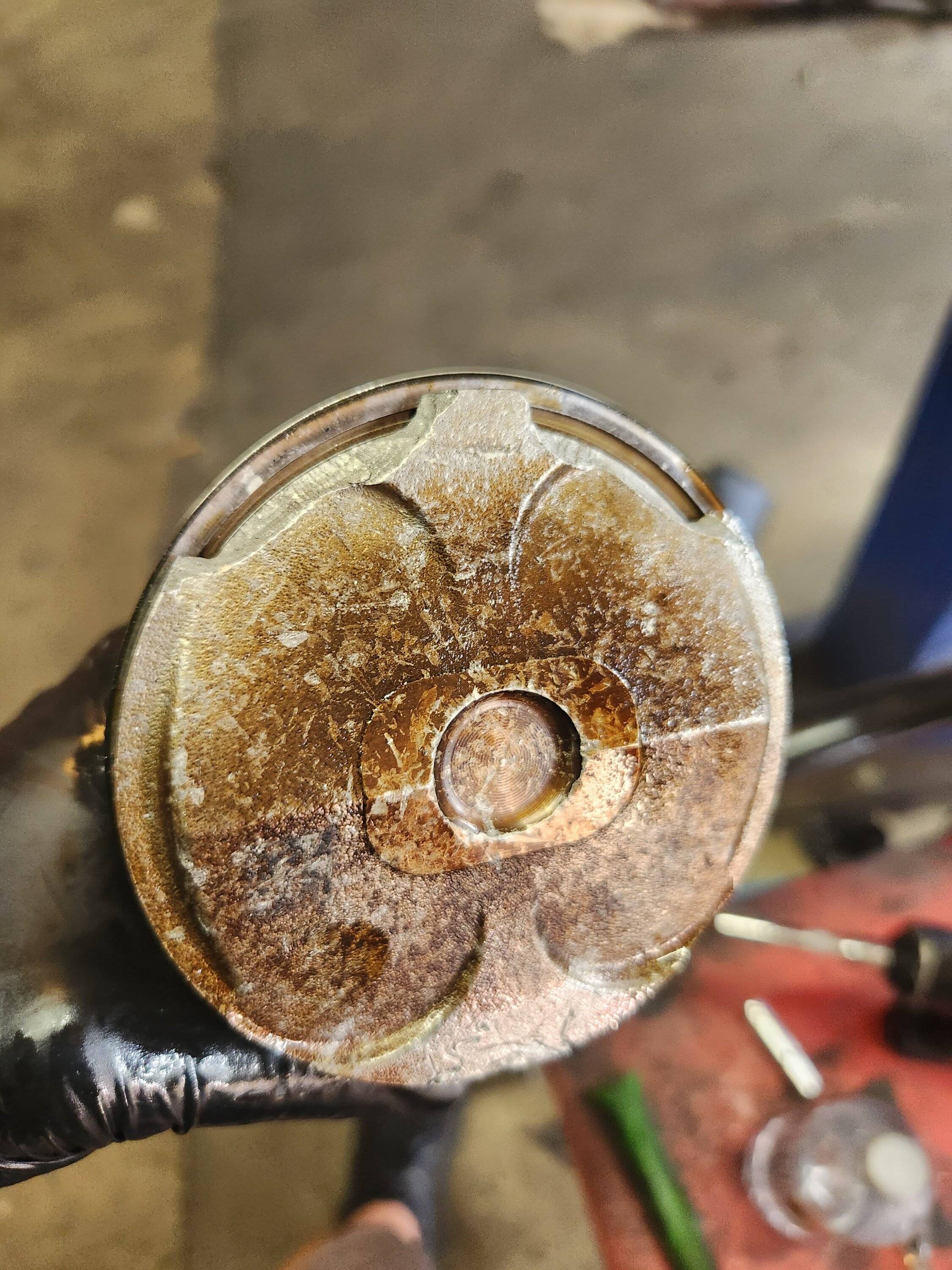

I don't think they are correct, but they want to alleviate as much blame/suspicion as they can from themselves, and honestly, it's not their fault. It's Ford's top ring gap. I suspect, you were running the car for an extended period of time on a road course and put enough heat in the pistons to close the ring gap until it broke the ring land off of #1 and #6 pistons. I and a few others have done similar. The stock top ring gap is too tight on these engines at .009 for boost with any extended pulls. It starts to close and when it closes, the ring land fails.
If you are rebuilding the engine, I would have the builder gap the top 2 rings at least .025. You won't lose compression, and it will be much more friendly when you do it again.
Edit: added the photos of my #6 piston to demonstrate the issue.

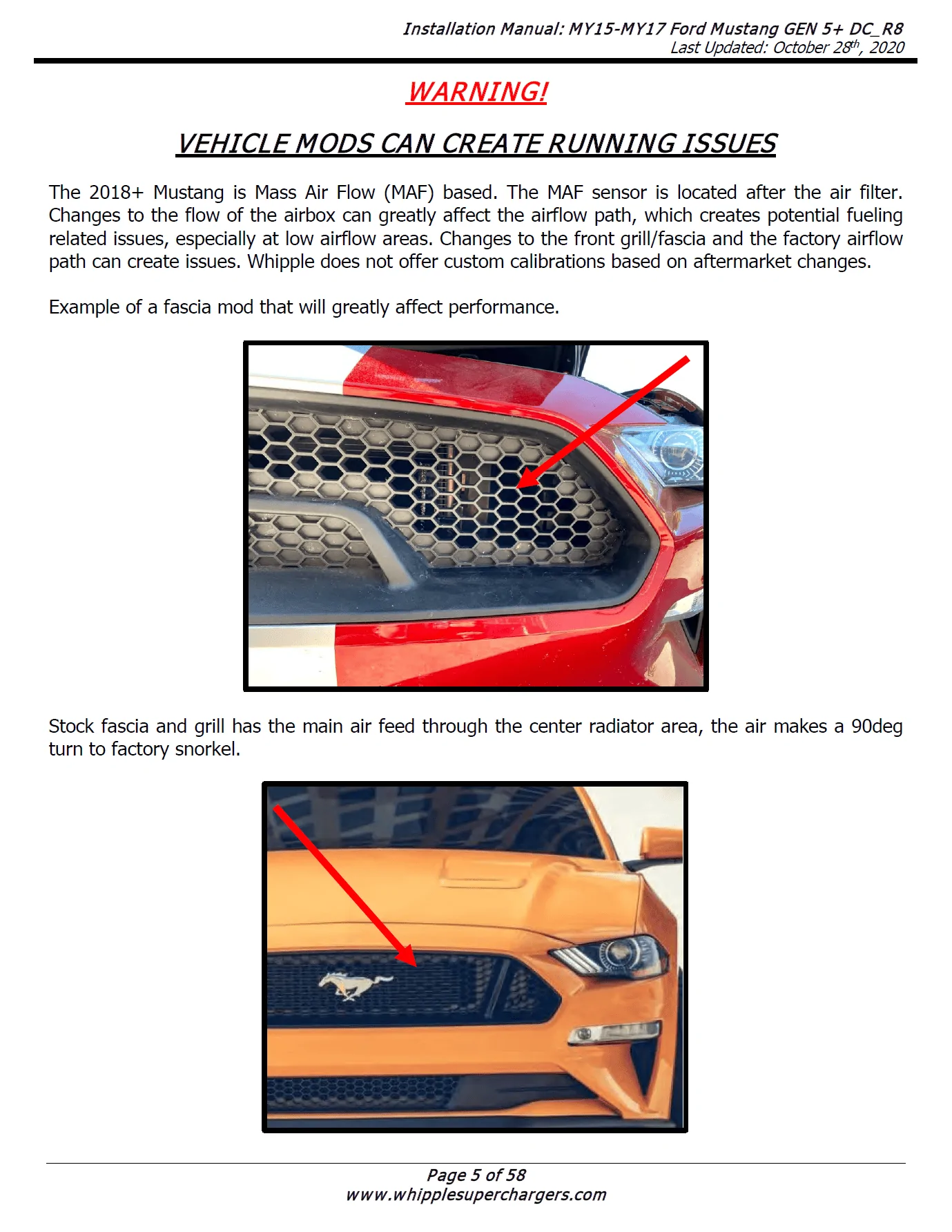

Whipple has a warning in the manual about modifications or changes to the front fascia can cause "running issues" with fueling. Below is a pic of that page in the manual. Not sure why it says 2018+ when this is the manual for my 2017 car. But I doubt this was the main cause of your engine failure.
What fuel was in the car? The whipple tune requires 91+ octane. Even with 93 octane I always add some boostane for extra insurance when racing the car (I do some drag racing).
Bummed for you that it didn't last long. I do not think your experience is very typical, but it does happen. Always a risk when going with boost. Especially when running pump gas.
