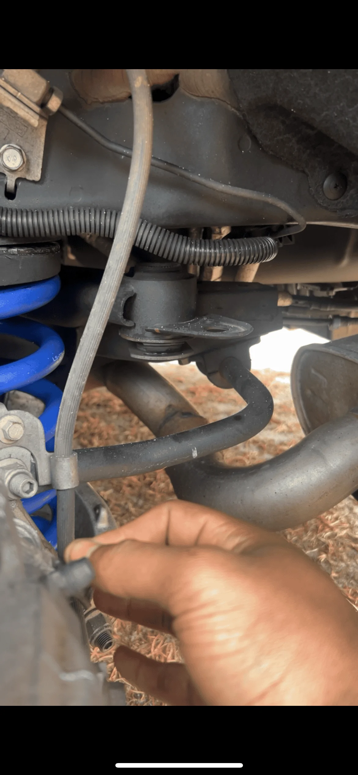

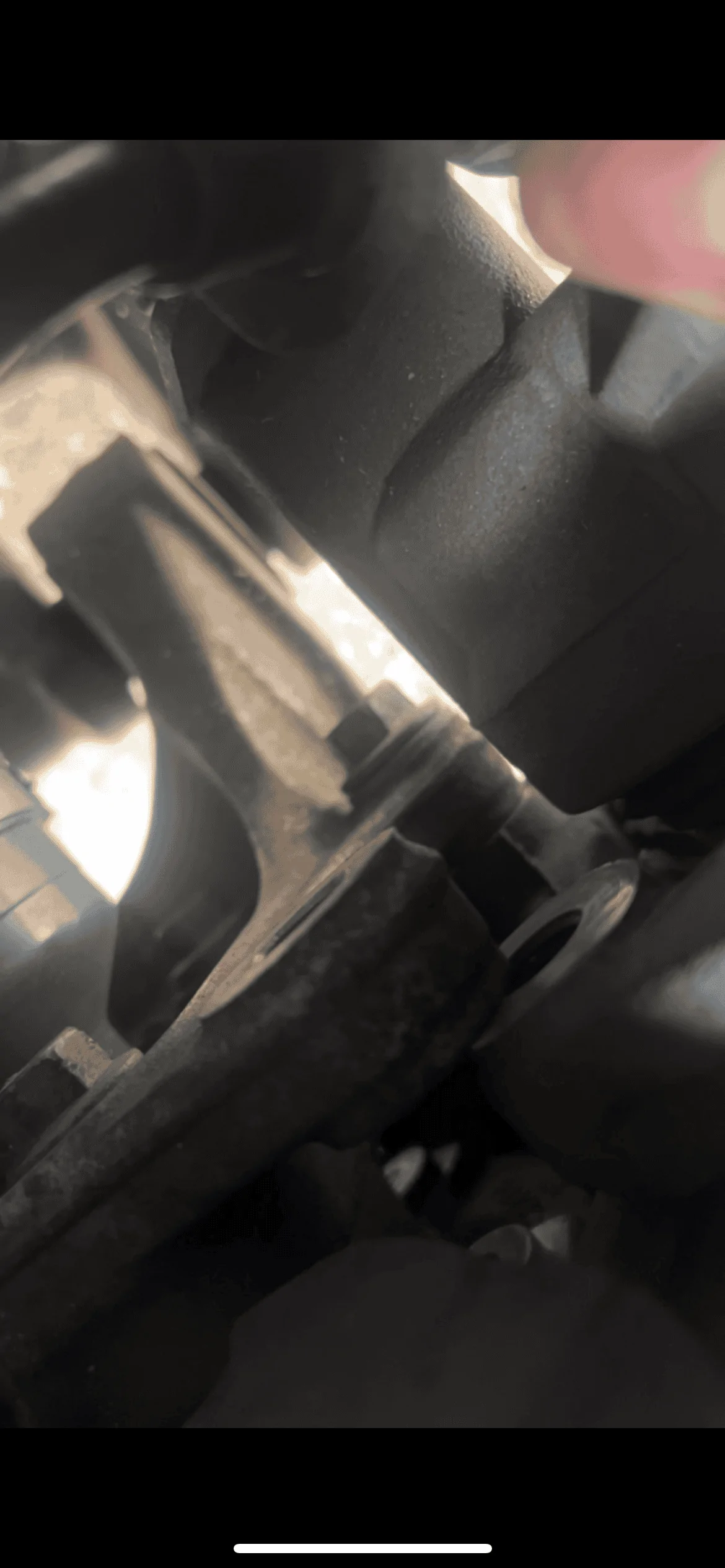

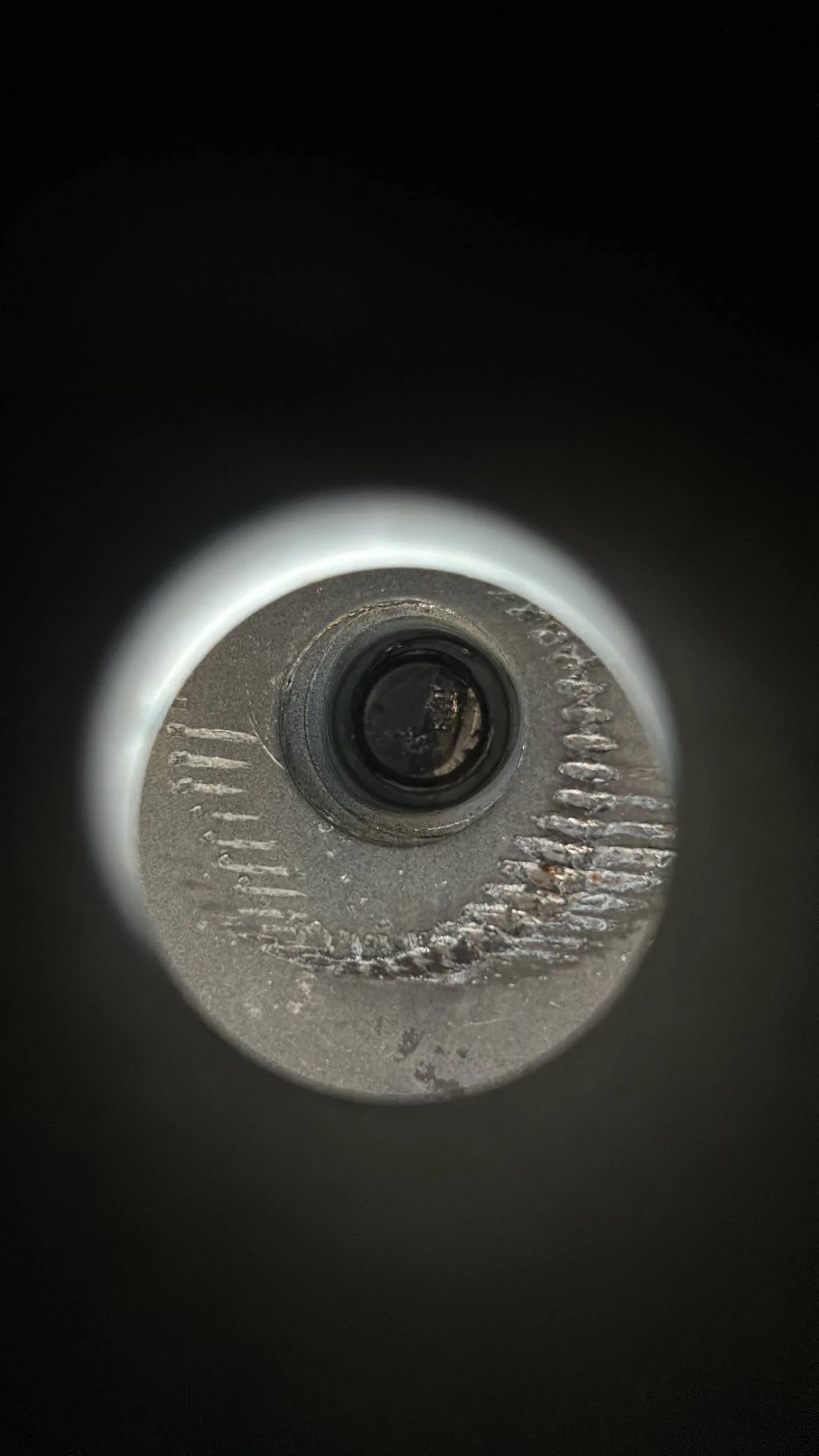

I have a 2016 Mustang GT, and recently about a week and a half ago, when I would press on the brakes to slow down, it would make a metal grinding noise, and turns out one of the bolts holding the rear caliper backed out, and one didn’t take much force to break loose, which I fixed that, but at the same time I noticed the rear subframe nearest to the muffler (on the rear drivers side) was sagging down a little, and turns out that I thought that the subframe bolt was gone or backed out, turns out the bolt broke. I don’t know how it broke or when it broke but I need to find a way to get it out, anyone have a way to get it out?

Whoever did your lowering spring install should be slapped lol. That's gonna be awful to try and fix. Hopefully left handed drill bit makes short work of it, but the exhaust will have to be dropped/moved

If it broke because it wasn't tightened enough it may not be so bad. My first step would be a punch (get it as centered as you can on the bolt stub), and then a left handed drill bit. If that doesn't work it's not going to be fun.

You can drop the subframe and then use a cutting wheel to cut a slot into it for a big flat screwdriver. That might do it, assuming its not crossthreaded terribly.
getting enough access to cut a slot into it is going to be the annoying part.

A Dremel may be helpful, but I'd try drilling it and using an easy-out first. If that doesn't work it will be a pain, for sure.

I don't know if there is room for a vice-grip to swing, but if there is you could clamp onto any remaining part of the broken bolt to start to unscrew it in stages.
You'd also have to drop the cradle to gain clearance. I made a DIY set of super long all-thread to lower my cradle a lot but without fulling dropping it. If trying that, you would use 3 of the 4 long DIY studs to support the cradle, but without one at the trouble spot.
