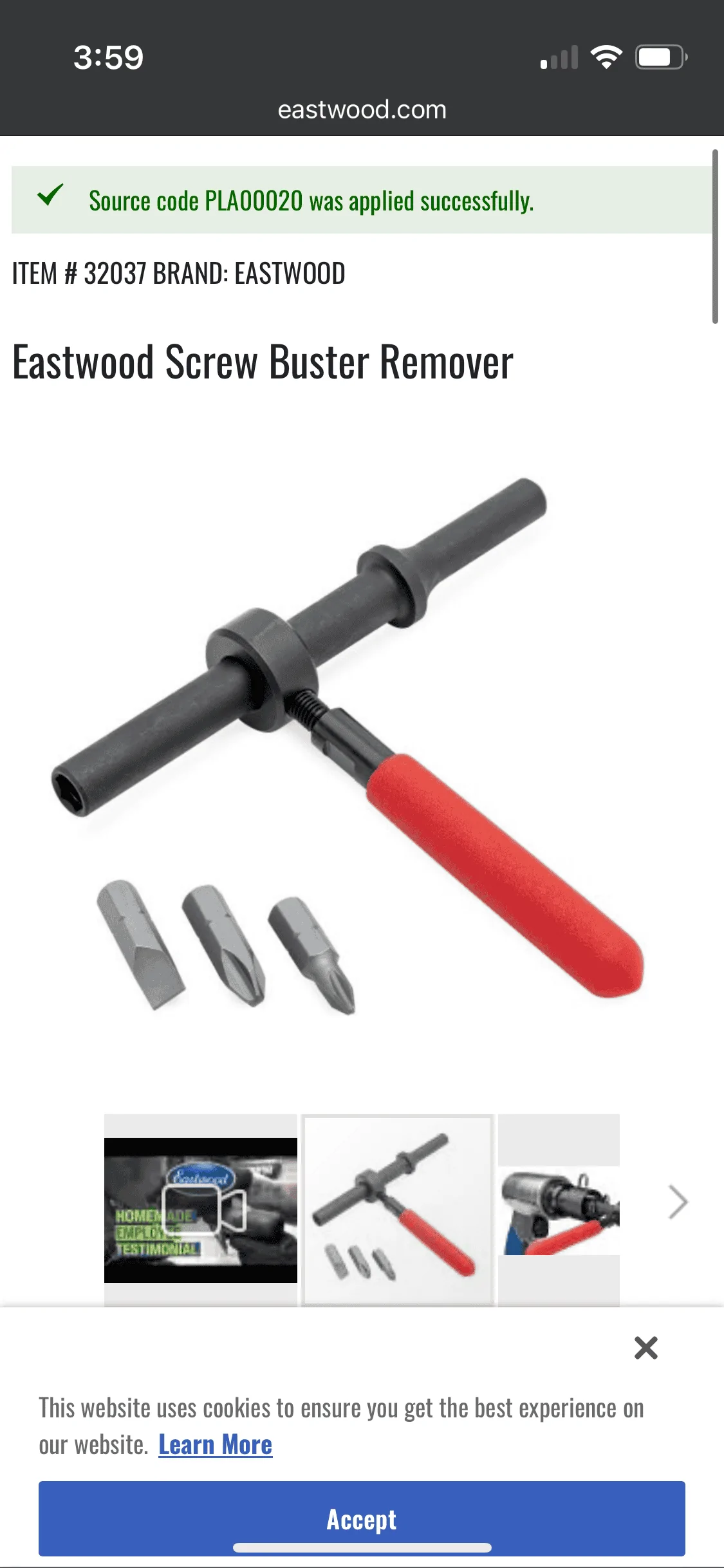

Again a terrible idea to use an impact on these.
I’d lower the subframe enough I could dremmel a slot.
Put some heat into it with a torch.
Then I’d come though the subframe with an air chisel using one those flat blade attachments with a lever arm and see if I could get it to turn out with the vibration and rotation.
