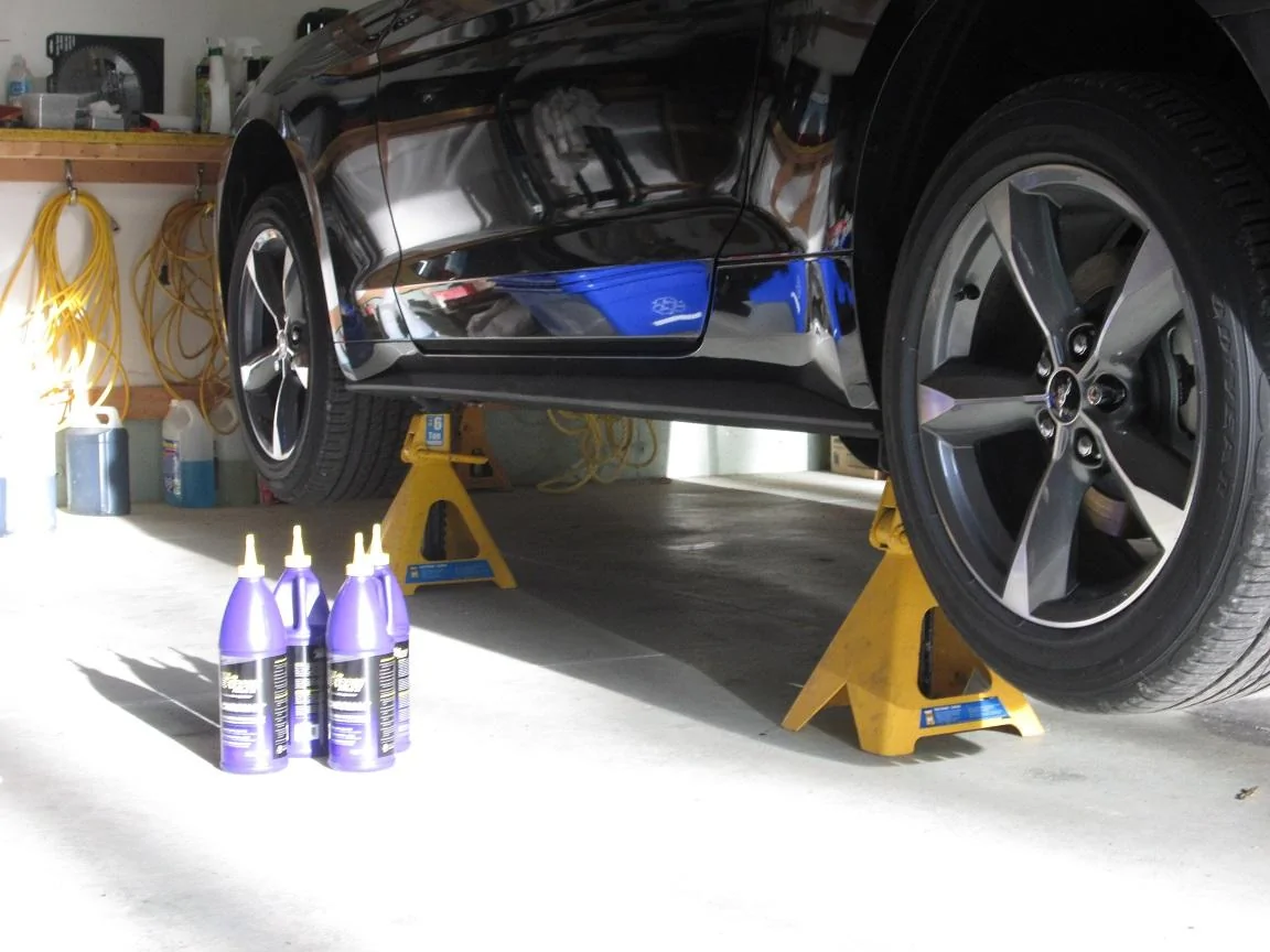

Changed out the stock tranny fluid for Royal Purple Synchromax. Purposely was careful to measure the Ford fluid. Only 2.6 quarts came out. :shrug:
Better check the diff.

I thought the MT82 took 2.7 quarts? I am pretty sure that is the correct amount.

You're correct Todd. My mistake. :doh: :headbonk:
2.7 US quarts or 2.55 liters.

I just swapped mine out yesterday with the same royal purple. What a difference it made!

Im pretty sure I read in the owners manual for the GT it says not to fill it until it pours out the fill hole but fill it to a half inch under the fill hole.
But for V6 and EB you fill it to the fill hole, I remember thinking it was a bit strange

3qrts came out mine and 3 went in.
