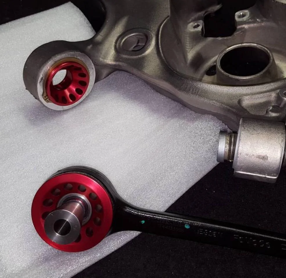

Those cortex bearings look pretty snazzy! Have similar spacers as the Steeda unit, but I don't remember if the Steeda spacer would slide right through which is what the Cortex looks like. Guess I'd have to take my LCA off to find out, haha.
Tell me more about the results from the front LCA bearing. I haven't noticed, personally, any want for the front to tighten up on my car (probably because it's not responsible for putting power down).
What do you mean "slide right through"?? Cortex,Steeda, BMR all use the same spacer design. A two piece spacer, one that goes onto each side of the bearing.
The stock front control arm bushing is a freaking sponge! It needs to go. Doesn't matter if you think its not putting down power or not, you car still has to handle and turn. Why not install it? Even for a drag race standpoint it will keep a more accurate front end alignment when the front wheels transfer weight. Plus it's over 1 pound lighter per side than the stock bushing.
For auto cross and track racing it provides more feedback and more solid feel. You'll notice it in the front just as you did swapping out the LCA bearings from the rear.

It looks like in one of the photos that the spacer rod would be able to be pushed from one side to the other and fall out the other side but I hadn't seen the photos you posted on an earlier post which show up (for me) on a different page. That's my bad. I quote like the Cortex cone design of the spacer - makes for good surface area contact with the mounting point of the LCA in the back, plus a cone is basically a series of triangles (think base of a water tower) so that'll prove to be nice and strong. Looks like awesome stuff!
Regarding the front bearing, thanks for the info. Looks like changing it doesn't require the same amount of surgery as does the LCA bearing, which is wonderful. I'll have to add one of those to my list of things I shouldn't buy but... will. Haha.

I have both the BMR and cortex bearings. I personally like the cortex better. Just my opinion. The BMR is also a nice heavy bearing, but I like the fact cortex offers both front and rear matching bearings.

[MENTION=7033]Voodoo[/MENTION] hence my argument as to why I believe ours are better than the others, that this thread is about. The issue with no retaining lip and lock ring is that you are solely relying on OEM tolerance...and your tolerance. Not to mention....you are pressing steel from aluminum....If one or the other is off too much then it can be a bad day.
As for the cortex stuff, I like those bearings. They're nice pieces. I don't think they offer any performance benefit increase except being a little lighter...but they do look awesome and of high quality.

If we are speaking who wins the engineering contest. Sorry guys but it is Cortex. I love all their stuff, but as a 40 year old non-competitive, fat guy with a family, I cannot always justify the money for their stuff. By the way they are big fans of steel too, check out their struts.
Cortex has built some stiffness into their design by shaping the housing. It looks to me they have done a bit of FEA and strengthen the necessary load paths while keeping it light.
As for the Steeda pressing into the LCA, I agree there is some risk associated with that. I used a set of Calipers and made sure the clearance was something sensible. I ended up sanding one LCA.
In my opinion if a company is going to use a snap ring or any retaining device, in order for it to be effective, for more than a fail safe it would need to be installed with some pre load.
