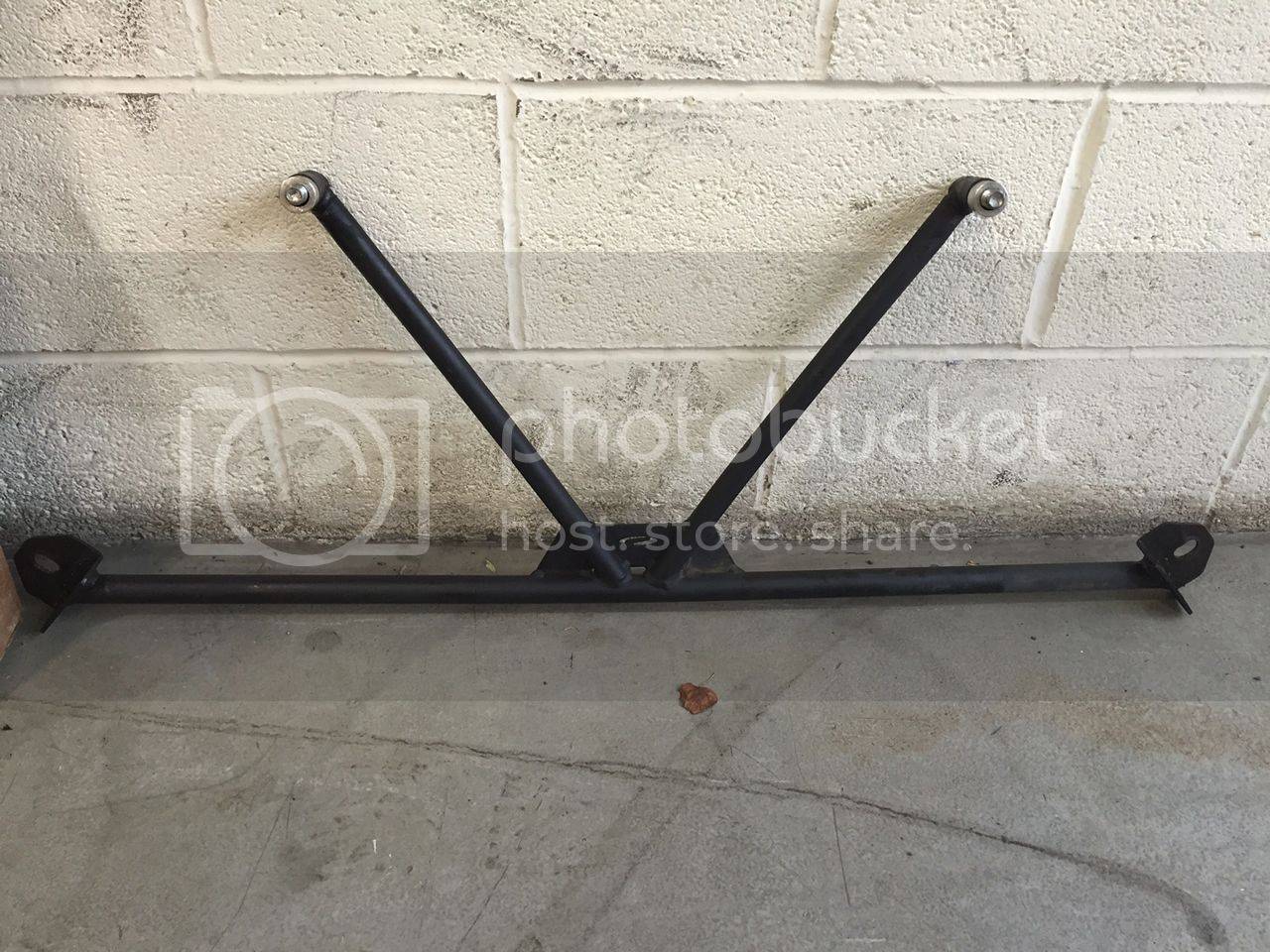

As such I present you the Steeda G-Trac brace that has a floor in the design:
The brace itself does the job as advertised and well, but the design floor is the fact it reduces ground clearance by 1" on the car, which on lowered cars particular ones on Steeda Ultralite or Eibach Sportline can be an issue. For me I was scraping on taller speed bumps and even worse the car was stopped dead entering a business park that had metal runner sticking out the ground, thankfully I was going under 5mph so more a scare than any real damage.

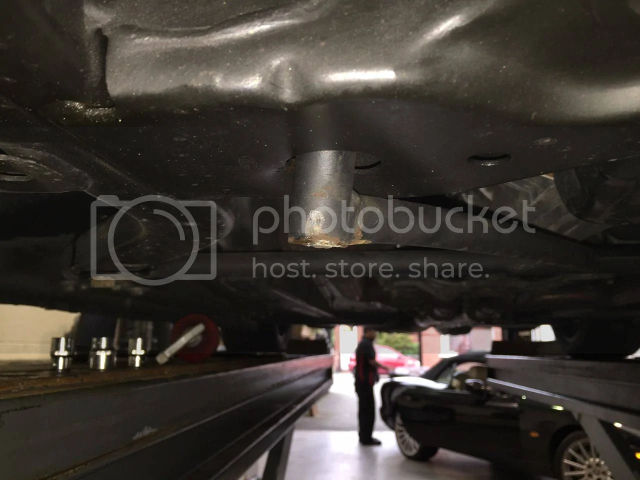

In the below image you can see the reduced ground clearance and where the part has being catching:
You can even see how its bent/enlarged the opening in the subframe.
The reason I went with Steeda G-Trac brace is because at the time it was the only brace on the market.

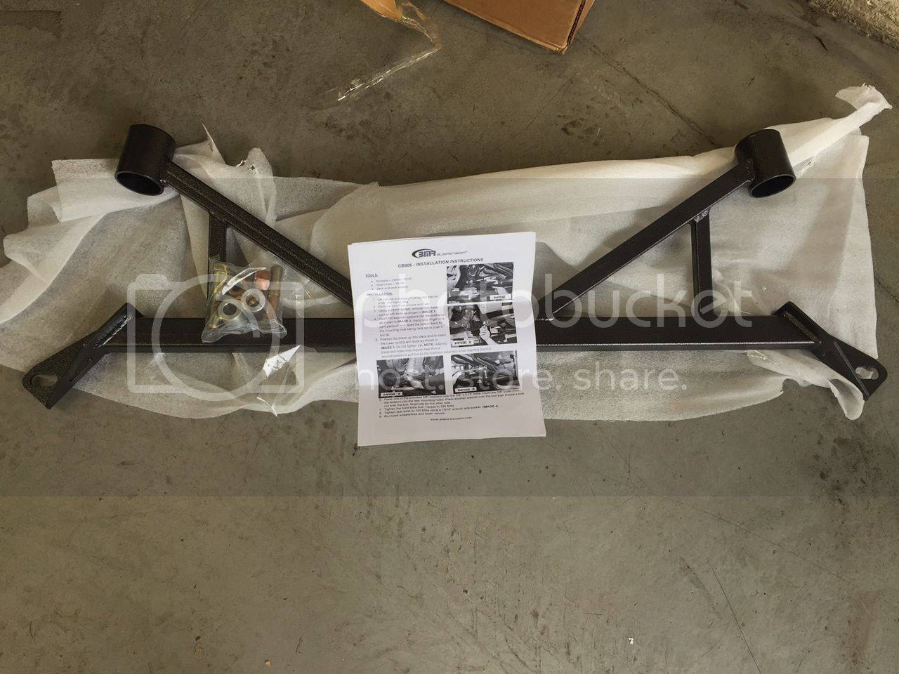

Now I present you BMR's CB006:
The quality of this kit is in a completely different league to the Steeda, the thought and engineering that has gone into this part is above and beyond. Kelly at BMR should be over the moon with what they have achieved. Even the bolts, washers and spacers are a lot more beefier and chunky, the only downside is it is a little heavier. But the quality and finish are vastly superior.

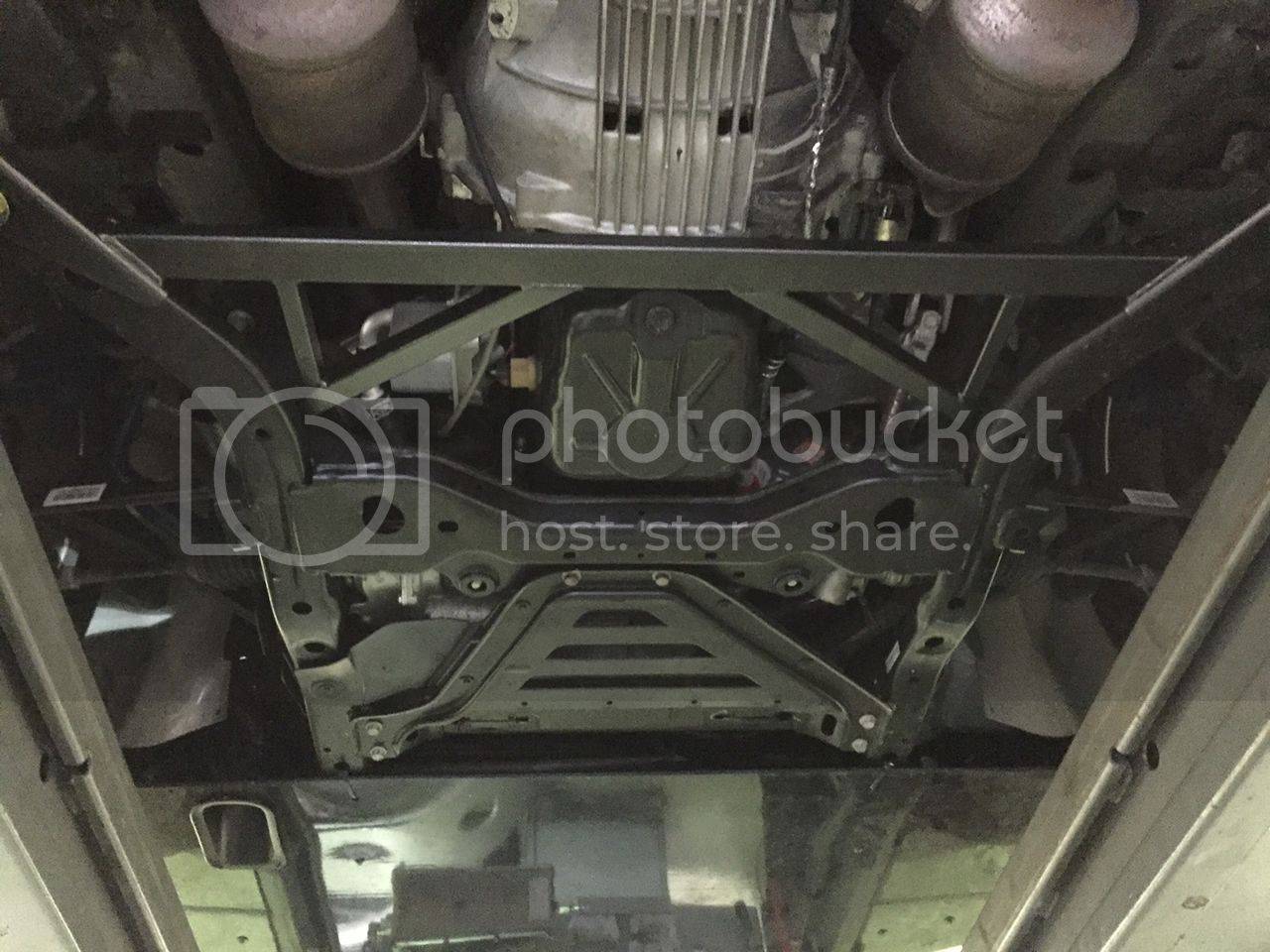

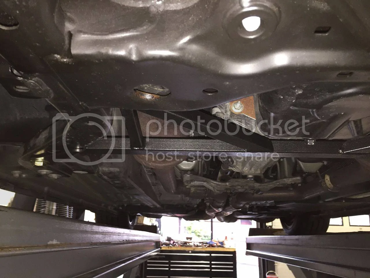

Some pictures of BMR CB006 on the car:
In the above photo you can see the BMR has no clearance issues at all because it does not bolt into the subframe, it in fact connects to the front lower control arm bolts, so not only do you get more clearance and a better quality unit it is also more functional.
When we originally fitted the Steeda it was relatively easy but a little fiddly as things did not line up perfectly, whereas the BMR unit was like a factory piece, everything lined up. Infact it was so easy we had removed the Steeda and fitted the BMR in less than one hour.

The Steeda unit is good, but I would not recommend it on cars lowered more than 1" due to clearance issues, this part is now for sale to a good home. :D
Yep, I have the Steeda brace and I do not like the brace lower than my frame. I will switch it out with BMR this winter.
