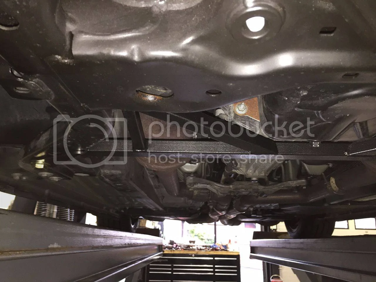

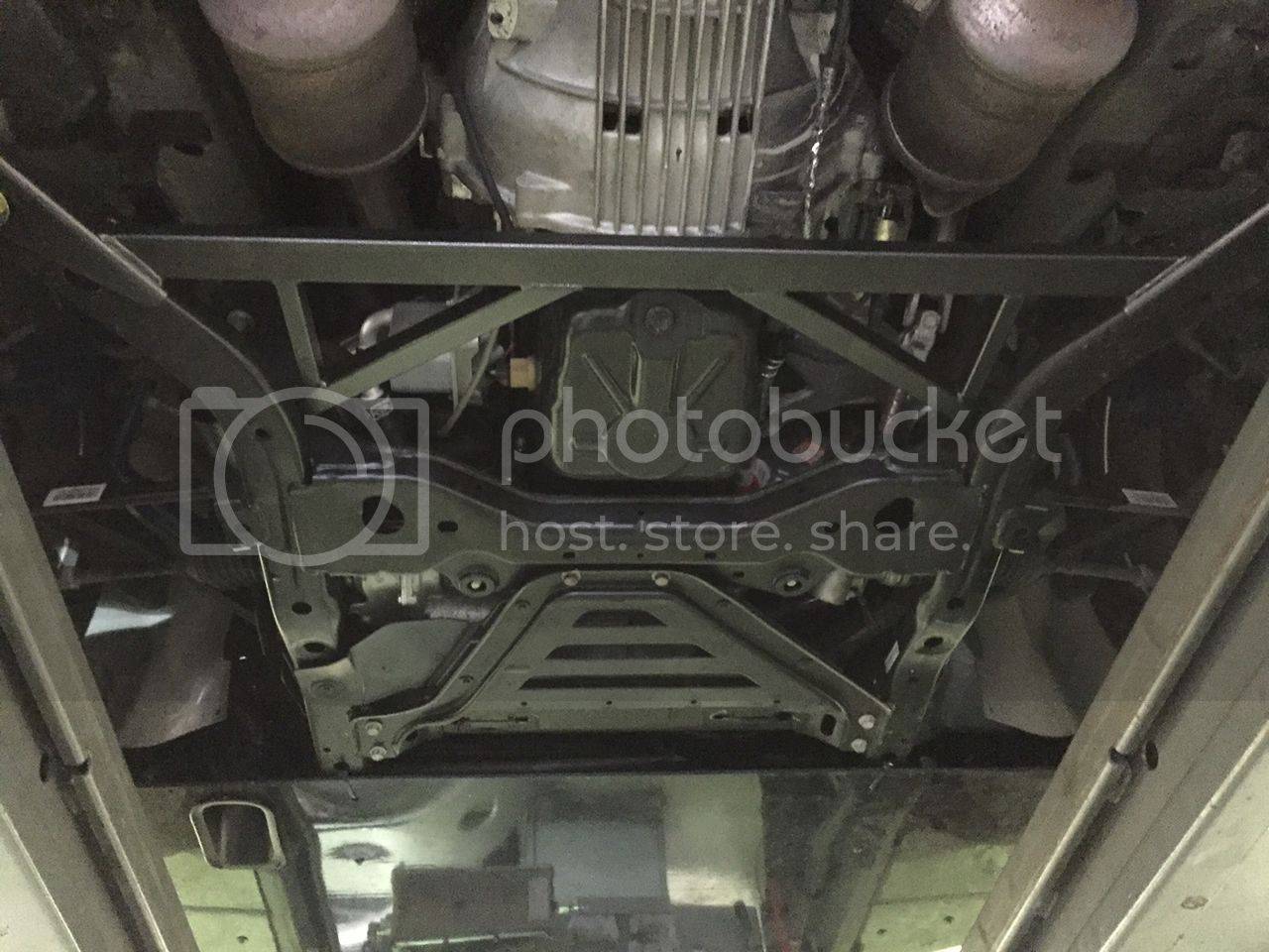

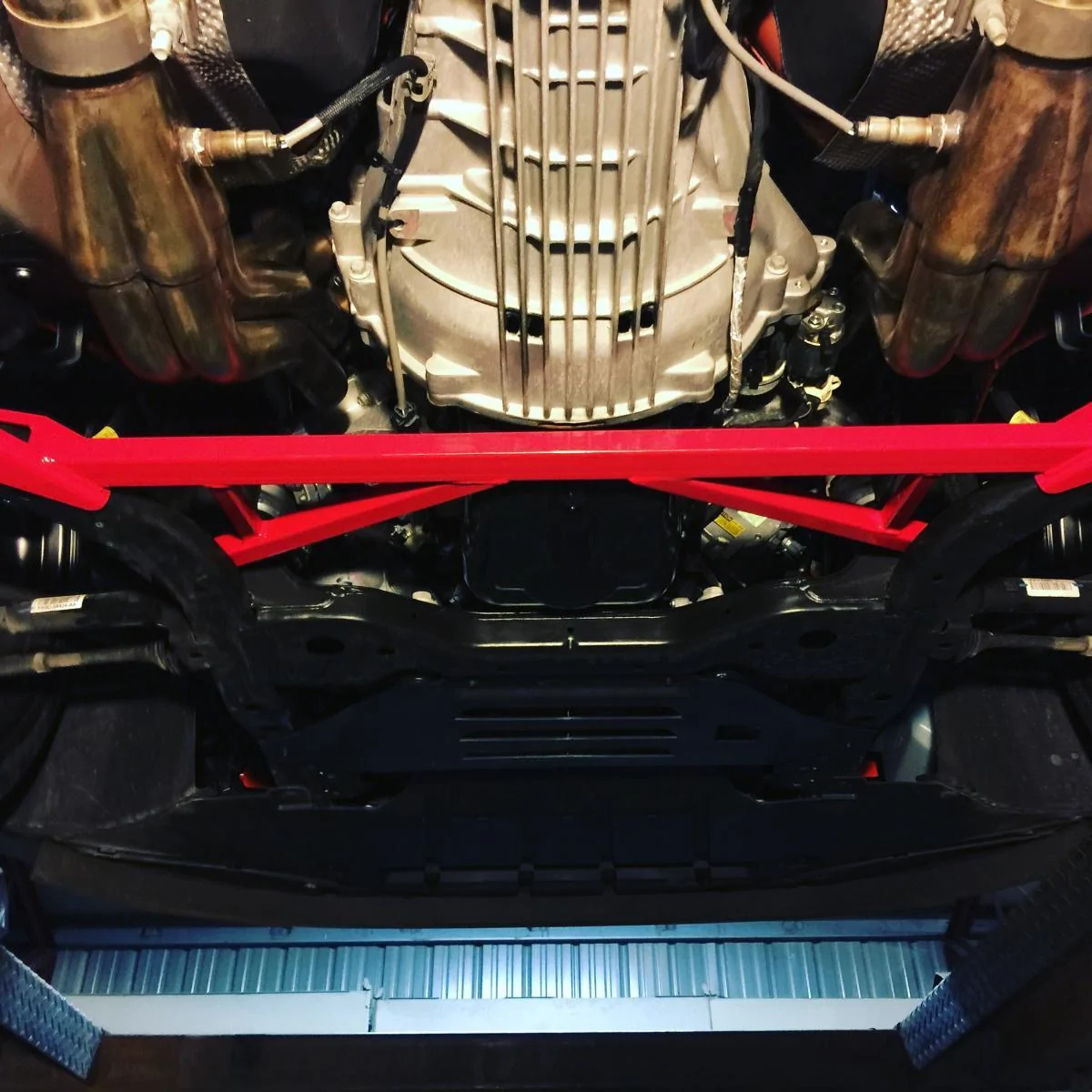

Hey guys, I just want to give a huge shoutout to Kelly and the guys over at BMR for making some kick-ass parts with beyond amazing craftsmanship and customer service! As some of you may know I was the winner of the CB006 giveaway and it's taken me a little while to get the brace on the car but it's finally on there and I thought I would give my honest review of it for you guys who may be interested!

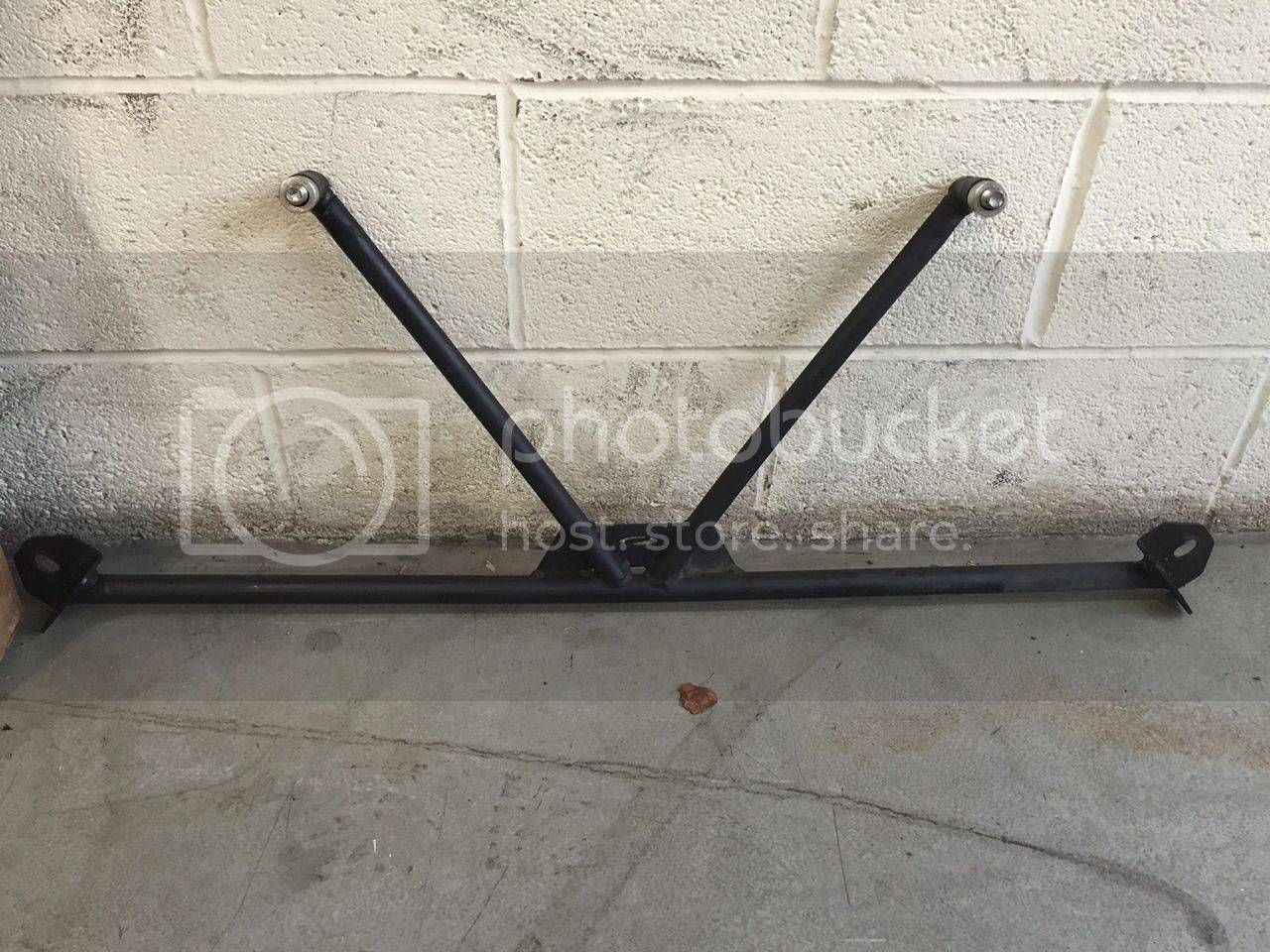

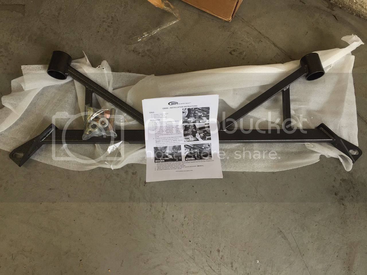

We'll start with quality, this things is beautiful! The powder coating was the first thing I noticed, it's as slick as glass and extremely thick, much much nicer than I've saw on some suspension parts from other companies I've purchased from in the past! There were absolutely no bare sports even in the tightest nooks and crannies it was just as thick as everywhere else. The welds were also very good quality and you could tell they were expertly done and strong and will definitely stand up to any abuse you could throw at it! Overall this is a very well made piece and you'll be hard pressed to find anything nicer anywhere!

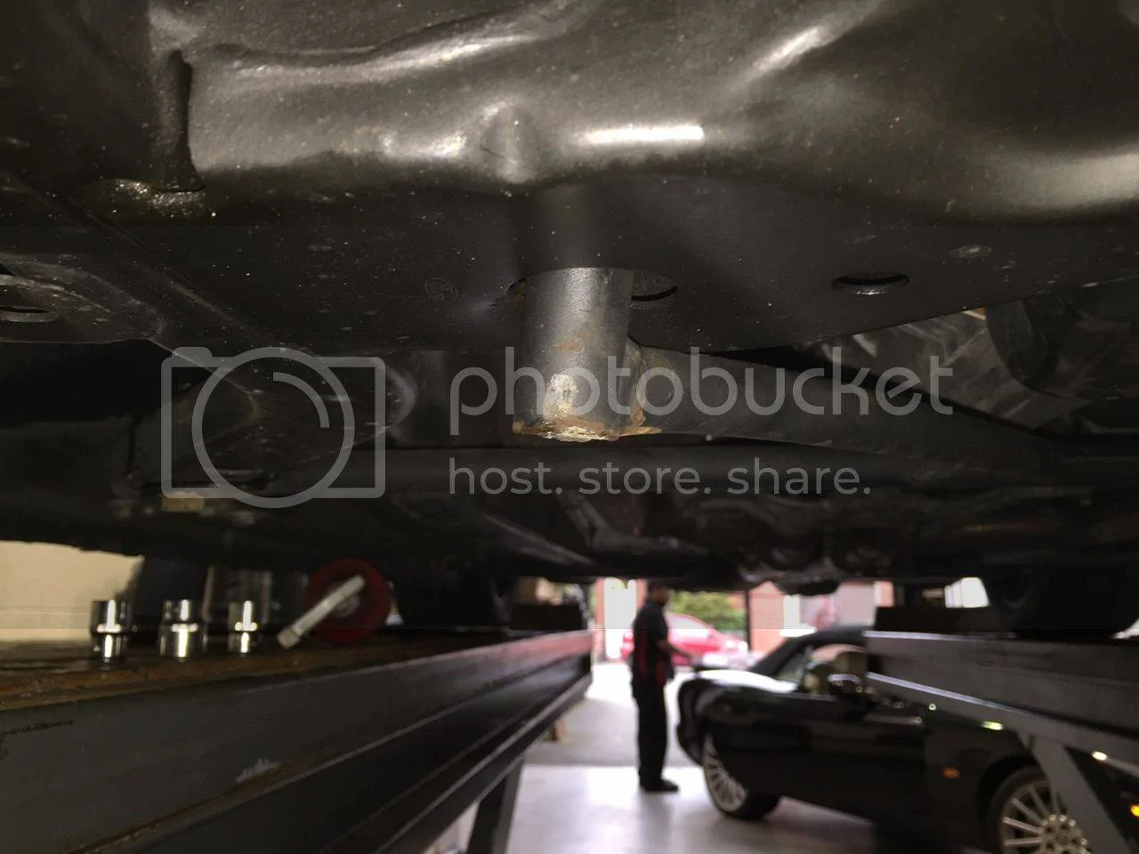

The install was about as straight forward as possible, and shouldn't take anyone any longer than maybe an hour with pretty basic hand tools. The only problem I ran into wasn't with the brace itself or anything related to BMR but was a problem that Ford itself created. You have to insert bushings into the front k-member "legs" that bolt onto the body to prevent it from crushing to rectangular tubing and evidently when Ford put the holes in the tubing they just pressed the holes and in my case the "slugs" from when they pressed the holes didn't come out but actually stayed inside the tubing still connected on one corner of the tab/slug. This was easily fixed by bending them back and forth with a screwdriver through the existing holes and fishing them out afterwards, just a extra added step you may run into! Other than that, you won't find a much easier suspension mod to install that this!
My post-install impressions are the car actually does feel overall "stiffer" in the front and more planted around turns. I don't auto cross my car or anything like that but I do run it fairly hard on these curvy SW Virginia roads and I can definitely tell a difference in the handling characteristics of the car! Overalls, for the money, I think it's definitely more than worthwhile for improving the handling of your car and I would without a doubt recommend it to anyone!
