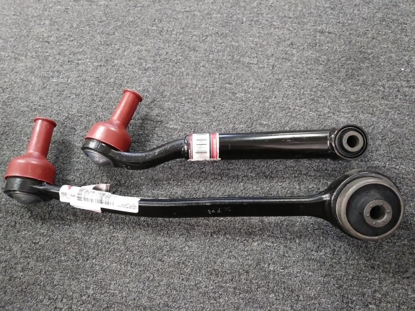

As we spoke about on the phone, I would suggest doing the following.
Ford Performance Front Control Arm Kit
*Rear Arm has a bearing, front long arm has a bushing.
*Replace the front long arm bushing with a bearing.
The other option is to simply order the "Performance Pack" control arm as it already comes with a bearing.
The Non-PP as you have, will have rubber on both pivot points on both sides.
If you pair this with the CB006, you will have a substantial change. :cheers:
Pics of the stock arms below.

Oh I like where this is going. I appreciate the chat earlier and the advice. Now that I'm looking at them I see what you are talking about. So the rear control arm has a spherical bearing but it's the front that could benefit from a bearing swap. And because I have the Base GT, my rear lower control arm has a rubber bushing which is where a lot deflection could be happening.
As we discussed, I think because my IRS has been stiffened so much that the front is comparably softer, which is leading to this feeling I alluded to.
I haven't seen much information surrounding the front control arms - as the major culprits always seemed to be found in the rear IRS. Everyone seems to focus on the rear. Although I'm forgetting that I don't have a PP which has different front control arms. But as you said, the CB006 alone may not change much because of the deflection already present in the rubber control arm mounting.
A lot more NVH potentially going to full bearings in both front lower control arms ? As you know I watched your FB live video with JPC Racing this afternoon- because of what you said I think I'm gonna ditch my diff bushings inserts. I believe it is causing unnecessary NVH (in combination with other parts) and has made my drivetrain/trans much more clunky. The benefit I gain from it is probably not worth it. I feel things that I think are directly attributable to the diff. It is a fine product but I think for me isn't worth it.

Yup - $120 for the pair of the bearing pieces.
Definitely a GREAT deal.
[MENTION=19599]Bluemustang[/MENTION] - get the pair of "PP" control arms for $120 and the CB006, and post back. ;)

So just buy two of them? Looks like the part # is the same in both links. Excellent, I am going to do that. I am torn between the red and the black CB006. I hear some people say they hate the red - I love it. But having seen a black one on a car, it truly looks like it should be an OEM piece. And it looks extremely strong.
