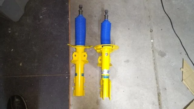

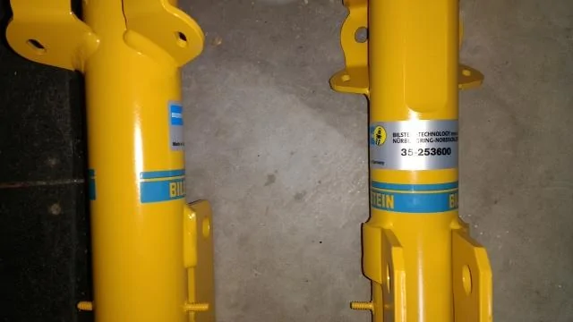

SP083 and Bilstein B6 combo? First drive?
Got a bit before that. Fronts aren't on and then I'll need an alignment.
