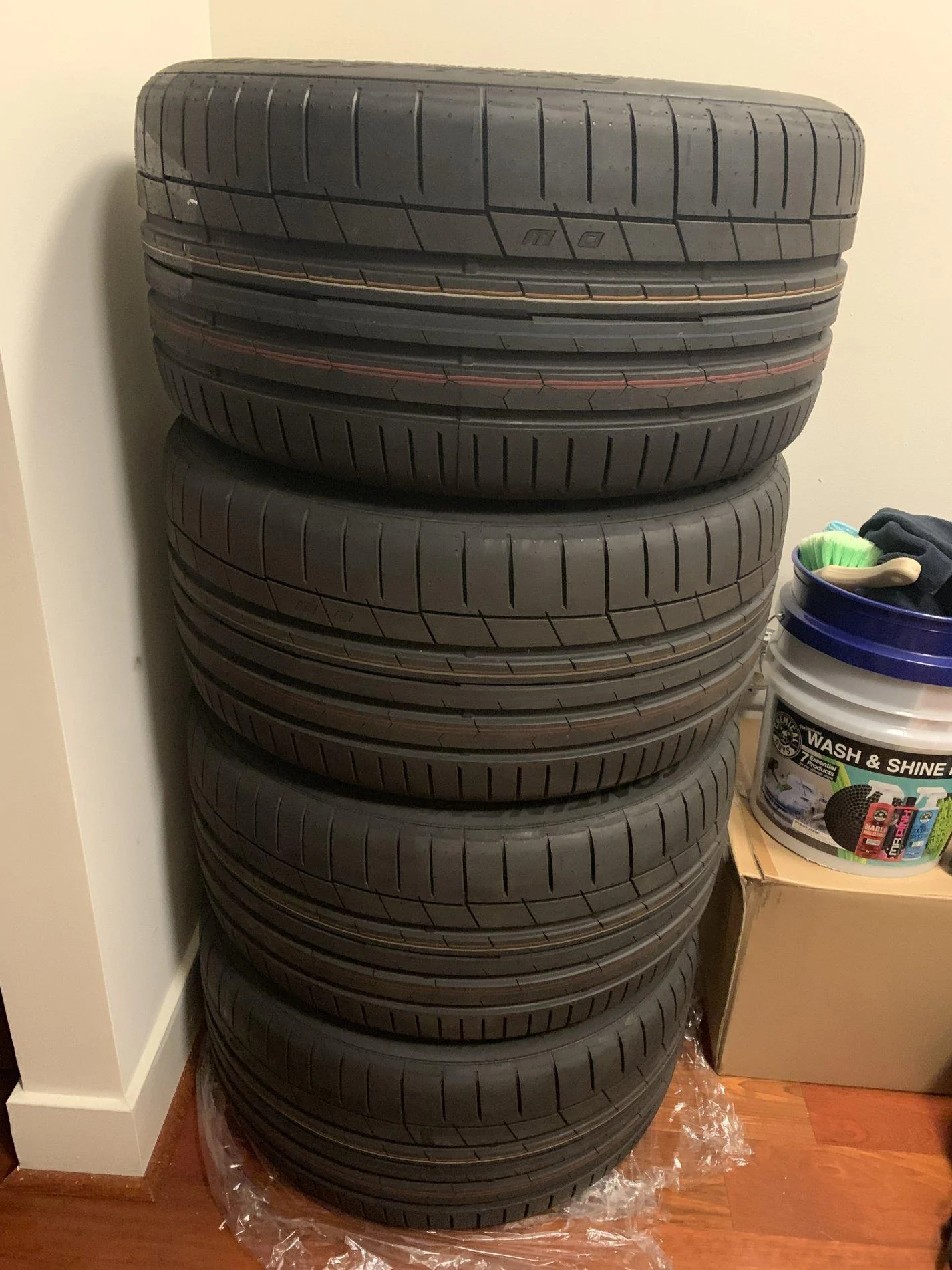

Any update on the wheels/tires? I’m dying to see those meats!
Haha yeah man. Things have been a bit slow. I picked up a '02 4runner as a daily but needs some work. Also I was planning on putting on the wheels once I got the Bullitt calipers and ceramic coated the wheels and calipers. I already have the steeda stainless brake lines waiting too. But being that I still am a bit of ways from that I will coat the wheels myself and put the calipers w/ GLOC GS-1 pads on after hopefully before the end of summer.
I have 2 wheels being mounted and balanced right now at Elite Importz in Laurel along with the BMR CBK760 that I'm getting pressed in my OEM arms. The last tire is coming in Monday. So I have the front BMR sway bar w/steeda end links, front control arms w/ BMR CBK760 , and the 4 wheels hopefully to be done next weekend. Also injured my shoulder last Friday with a possible tear (waiting for MRI results) so it'll depend on how I heal also

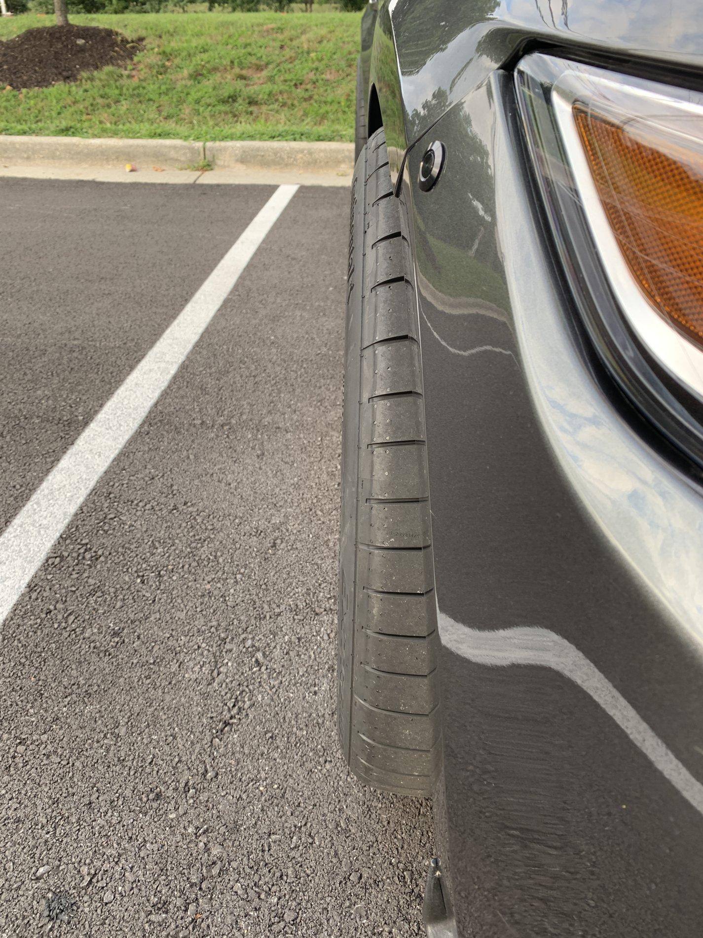

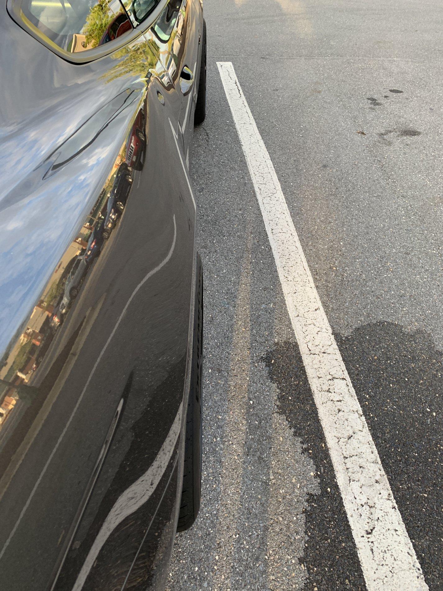

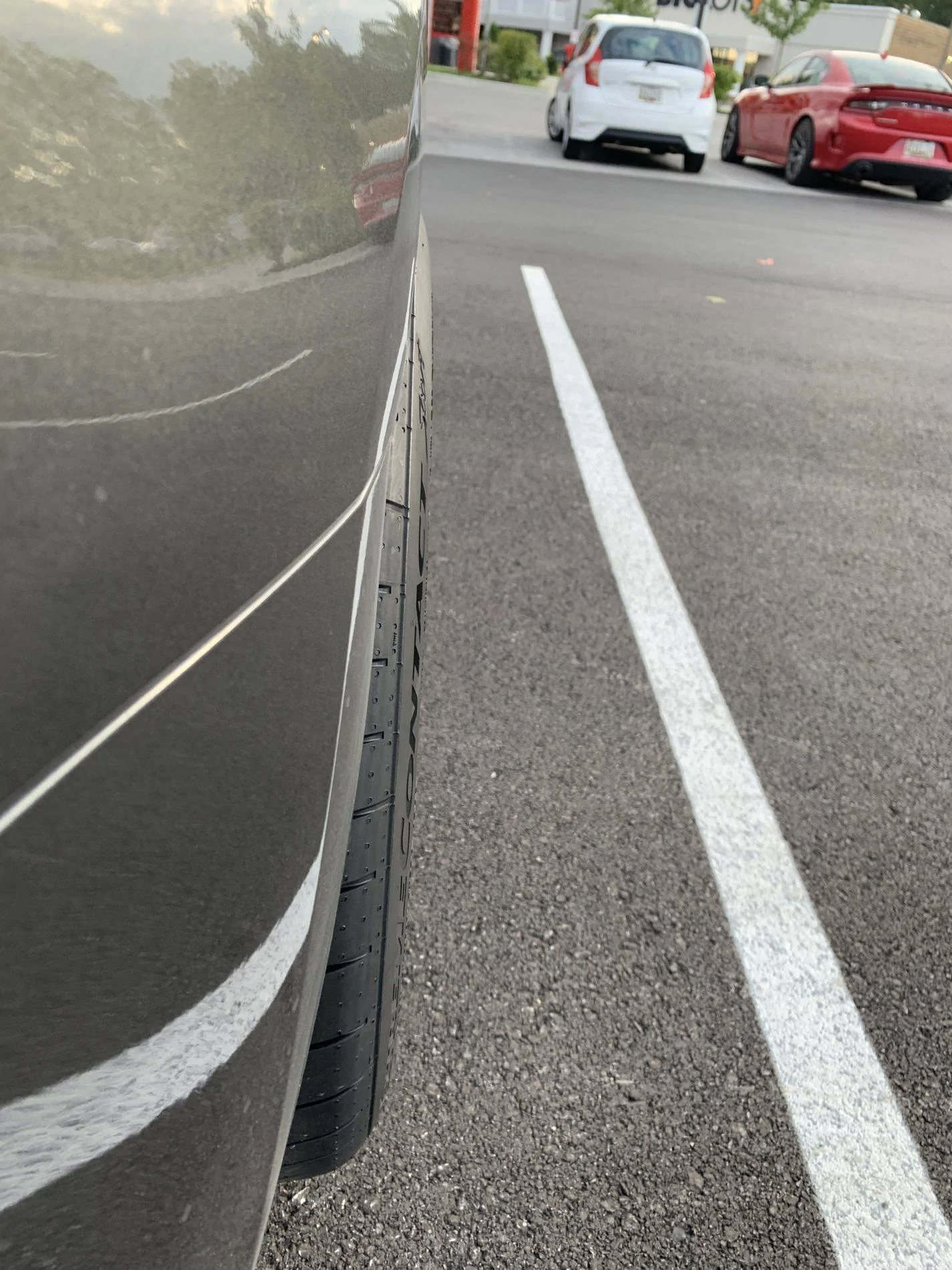

Right on dude. I’ve been contemplating going. With the same size wheels you did but I’d actually be able to see your car in person instead of just pictures on here. Do you have any more pictures of how those 295 Conti’s fit on those 11” wheels?
From the side? When I pick up the other ones tomorrow I'll send pics your way

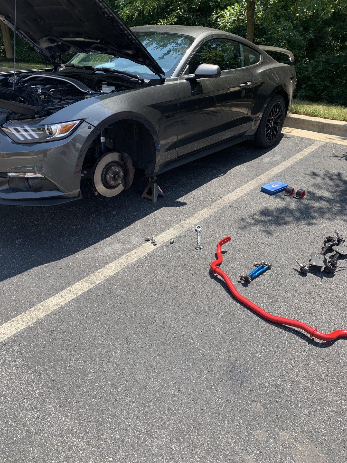

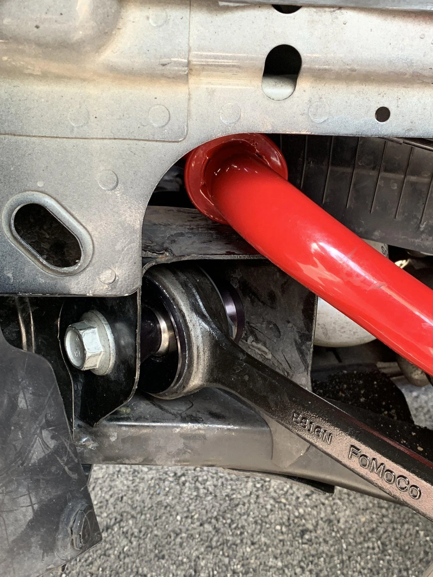

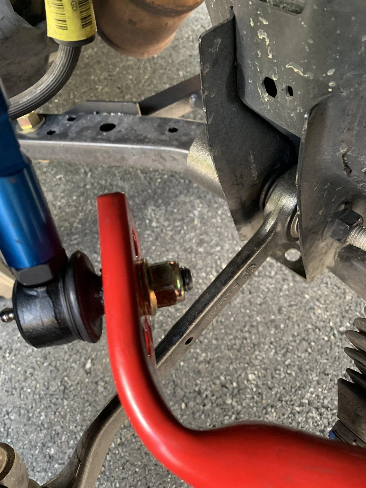

So today I finally swapped out the GT350 front bar for the BMR bar with Steeda end links. Also I took out the Steeda tension links with bearings (which I'm selling) and put in my OEM set with BMR CBK760. With the bar in the middle hole it definitely feels more responsive. I'm still on the trash stock tires hopefully for a couple more weeks. All weird noises are gone such as the squeaking I was getting due to the bearings being lose in the control arm. Nice quiet ride now.

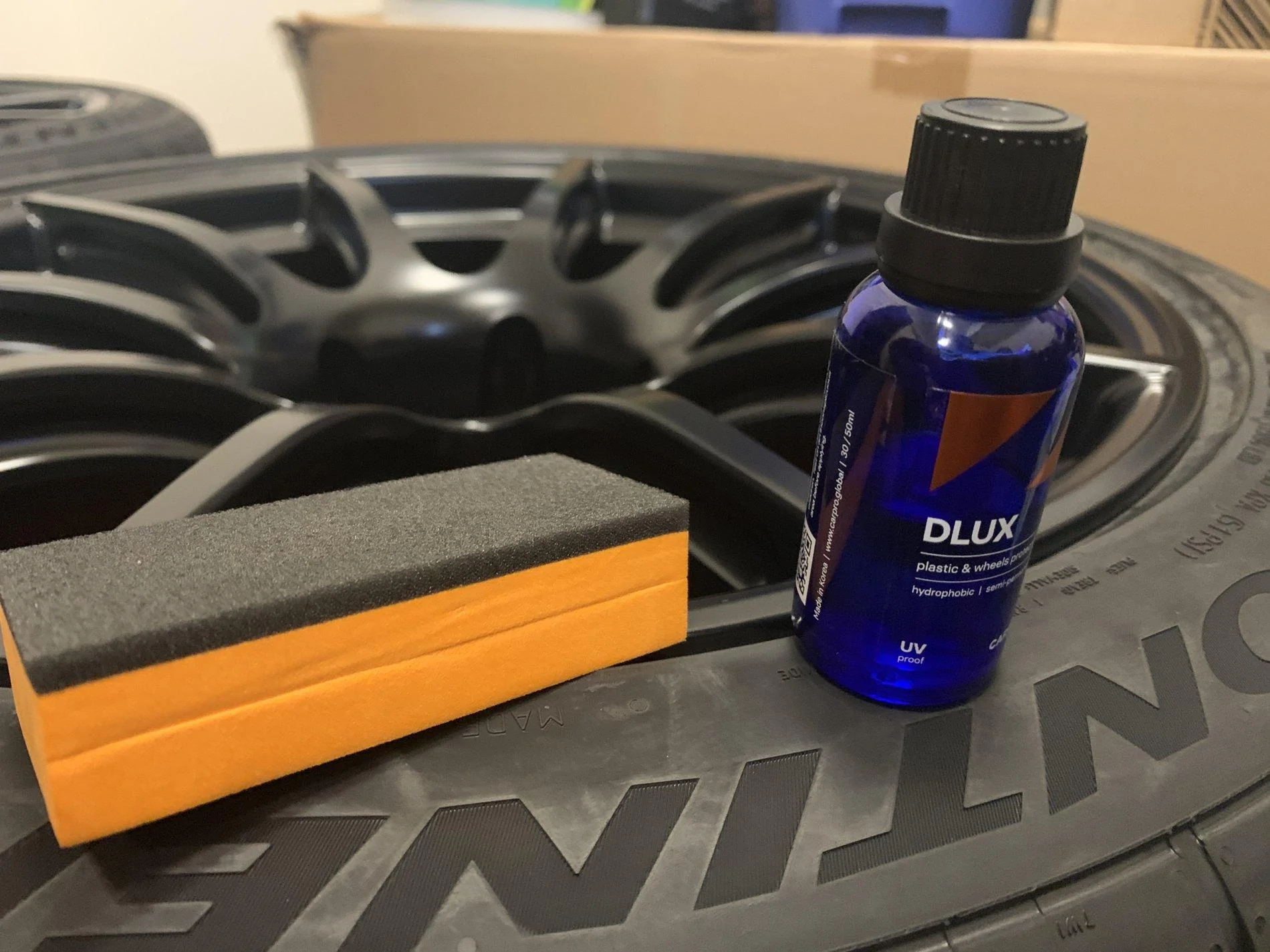

Also all wheels have been mounted and balanced so I'm just waiting for the products to come in to ceramic coated them. Hopefully I can put together things for the Bullitt calipers and GLOC pads but I might not wait on all that. Solid day in the work shop

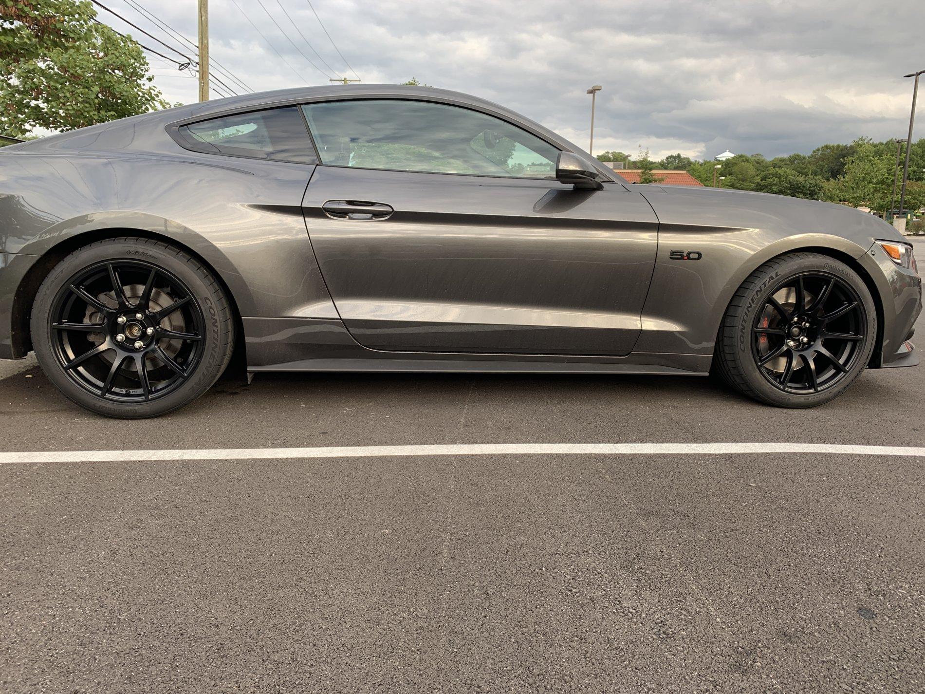

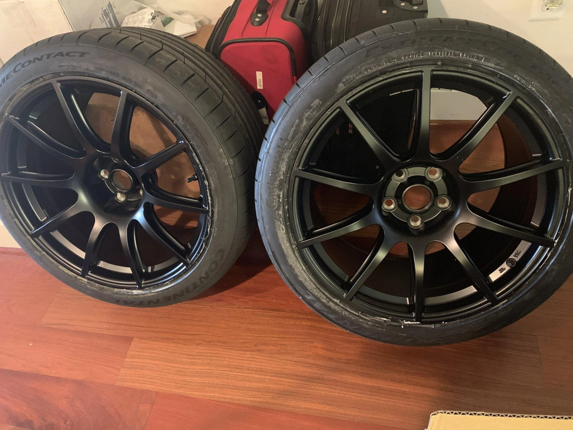

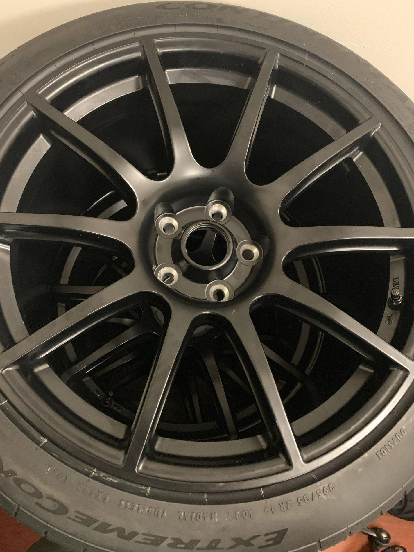

So I got impatient and decided to put the wheels on and man oh man. The Conti tires feel way better than the stock tires. It's amazing how much of a difference it makes. My center caps are coming in tomorrow so I will ceramic coated those and put them on. Will find time in the next week to get an alignment.
In the back I added a 3mm spacer.
Excuse the dirty car. By the way my PP set up going for $150 picked up https://www.mustang6g.com/forums/threads/pp-wheels-tires.127551/
Up next is custom color powder coating calipers by a local shop. Just need vertical links and possibly toe links (depends on alignment). After those I'll move onto the engine. Still have my ported 18 Mani and TSP headers waiting. Will most likely get a Dyno tune by Rev Auto in Baltimore. View attachment 390596

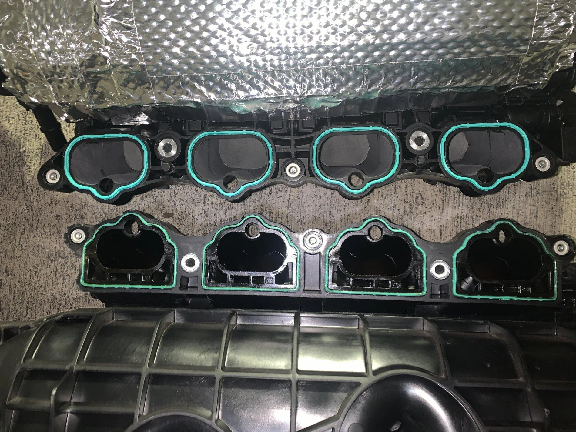

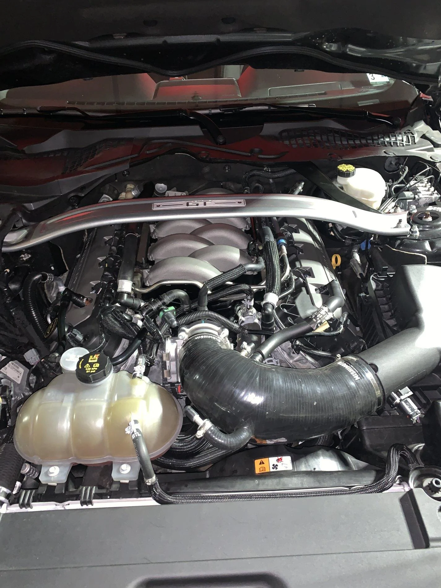

Well I finally was able to install my Ported 18 manifold and 170 Thermostat. Its been sitting since around April but I wanted to finish up the suspension and wheel/tire set up first. I went ahead with Shaun at AED for a 93 tune which I was able to upload. I can't give any feedback yet as I am still waiting back from him on the revised tune from my base datalogs. Hopefully I did them right as there wasn't much opportunity in my area to log pulls to 70 MPH. Hopefully I can have better feedback in a couple days as he and I go back and forth.
So far my CHT have been between 190 and 195 so I dont know if that's the thermostat or the gimmicky heat shield on the manifold lol. Next thing up will most likely be an 18+ JLT CAI.

Received my final tune from Shaun earlier today and everything is perfect. The car pulls very hard and I couldn't be happier. I knew my car was fun to drive but knowing myself I am going to look for reasons to drive it on the highway like going to target 20 minutes away instead of the one thats 5 minutes away lol. Happy with the manifold decision. Now I have some cosmetic/exterior stuff for the front to work on and it'll slowly be coming together.
It's really a big difference from the stock manifold. Tune itself makes a difference too of course, but the manifold changes the character.
Yes sir a huge difference! I remember you saying several months ago it will feel like a different car and it does. The only thing is I'm trying to get used to the powerband and timing of the shifts. My 1-2 is not as smooth but it'll come with practice.
