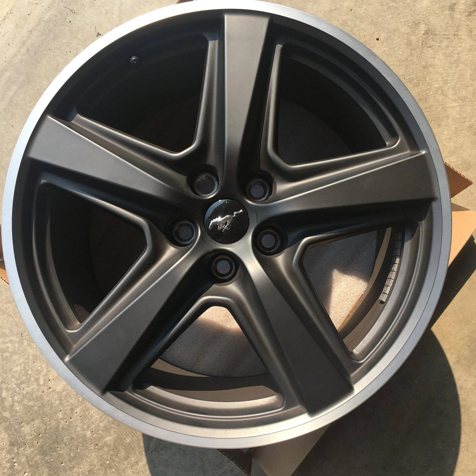

Fronts weigh about 33 lbs and rears 35 lbs, but that's with wheel weights installed so actually a little less than that.

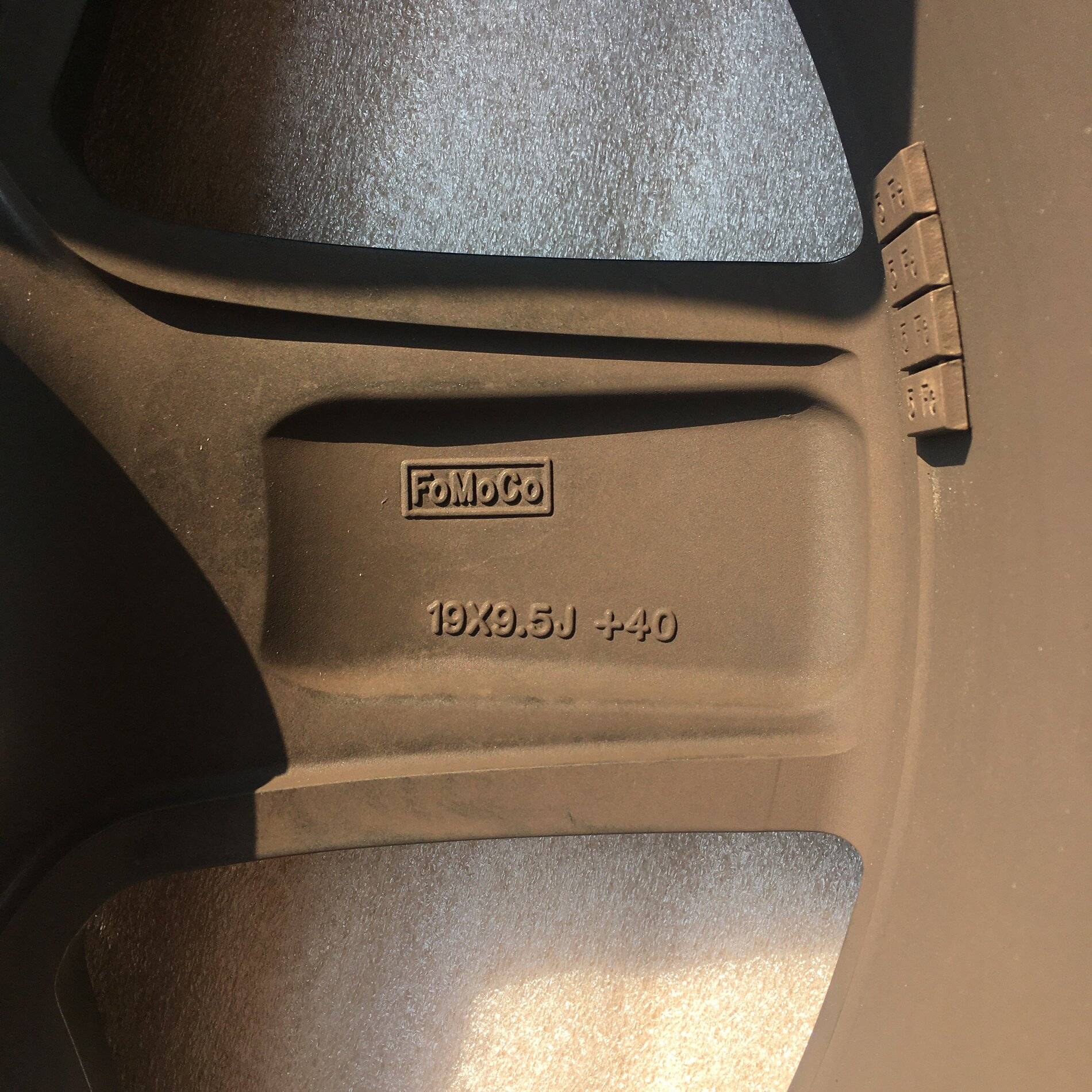

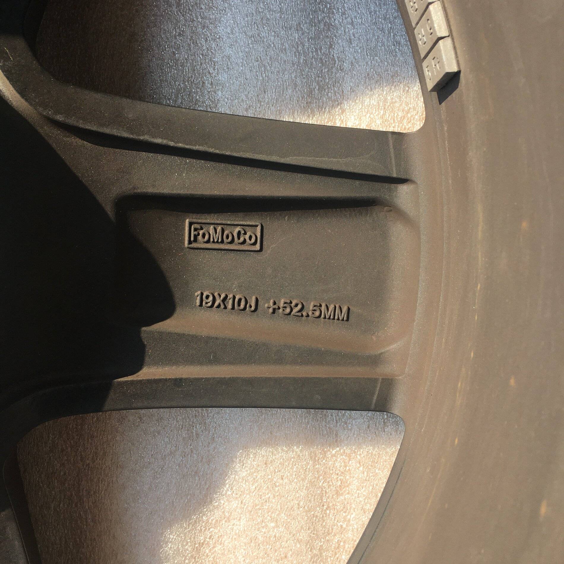

Fronts are 19 x 9.5 +40, and rears are 19 x 10 +52.5.

For what it’s worth, I got the OEM take offs for $825. Total cost was about $1,400 for the wheels, TPMS, mount & balance, and a set of used 255/40 and 275/40 all seasons with 9/32 tread.

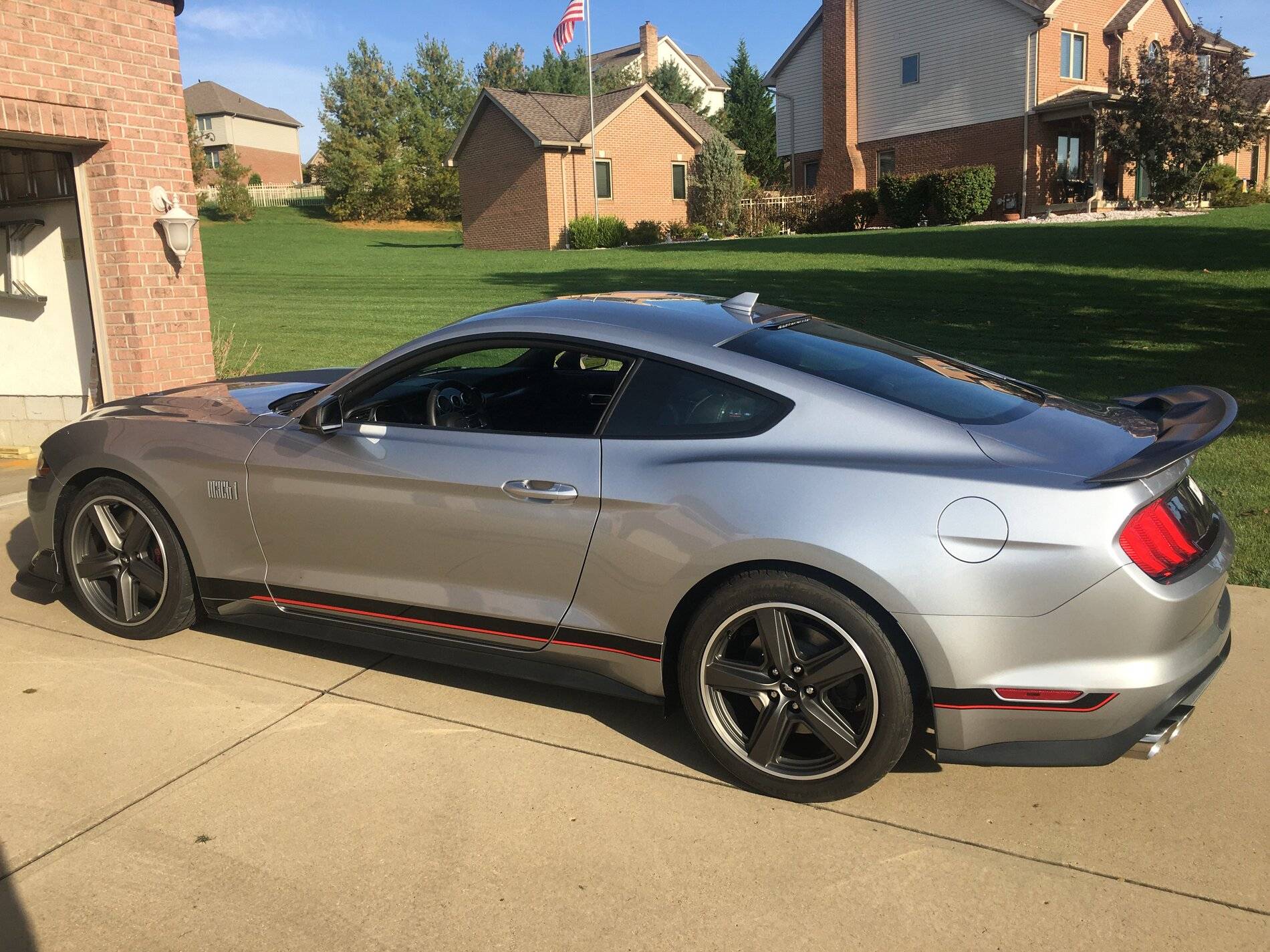

Here's what it looks like... I did exactly what you're thinking:
