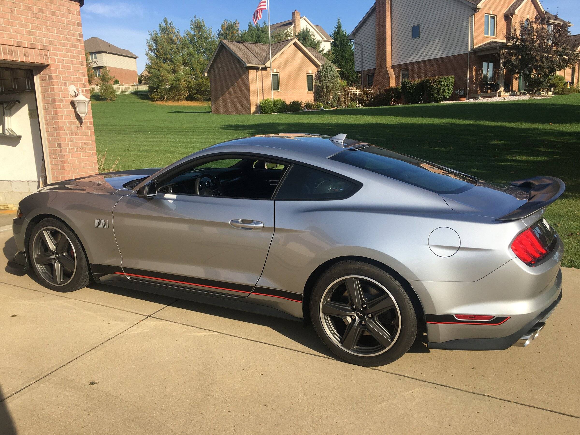

I lived in the Northeast for 65 years. It is the salt thing. Really depends on where you live and the amount and type of salt used. Most brushless and/or touch-less car washes have an under carriage wash which will remove the salt.

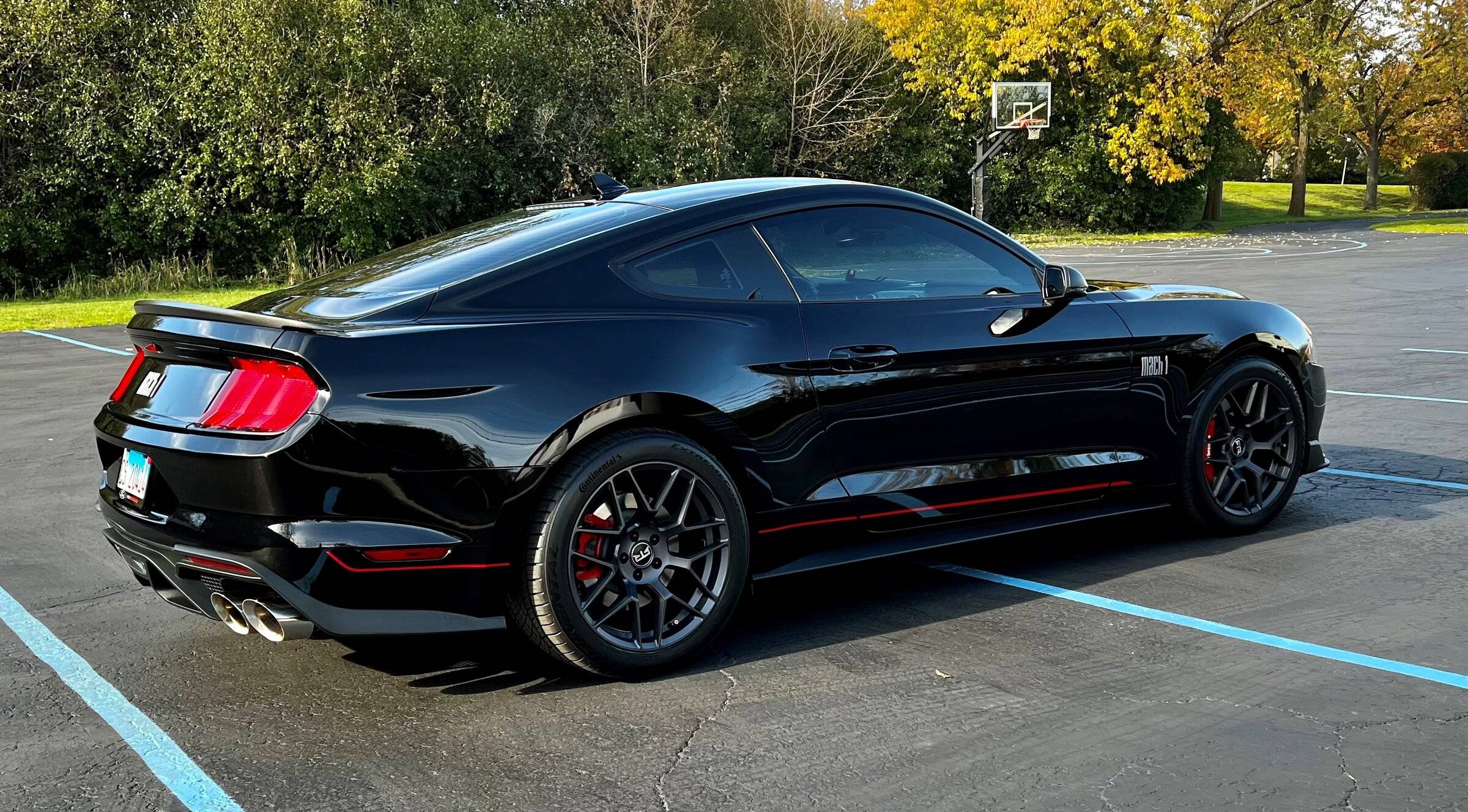

19" x 9.5" RTR Tech 7's, with 275's Continental DWS 06 Sport All-seasons on all 4 corners.
$2500 to my door ready to mount with sensors- American Muscle
For me I don't have to drive the car in the snow but like to drive all winter when nice out in Chicago. All-seasons are perfect for Nov, December, March, April when the PS4S's aren't the best.
Very happy!
Very happy!
Nice, those look awesome! This is looking like my top pick right now. The square setup lets you rotate your tires too.
These you can rotate. There is a new Continental DWS Sport + that is directional so be careful as I don not know which one American Muscle is using these days. I bought my setup few months ago

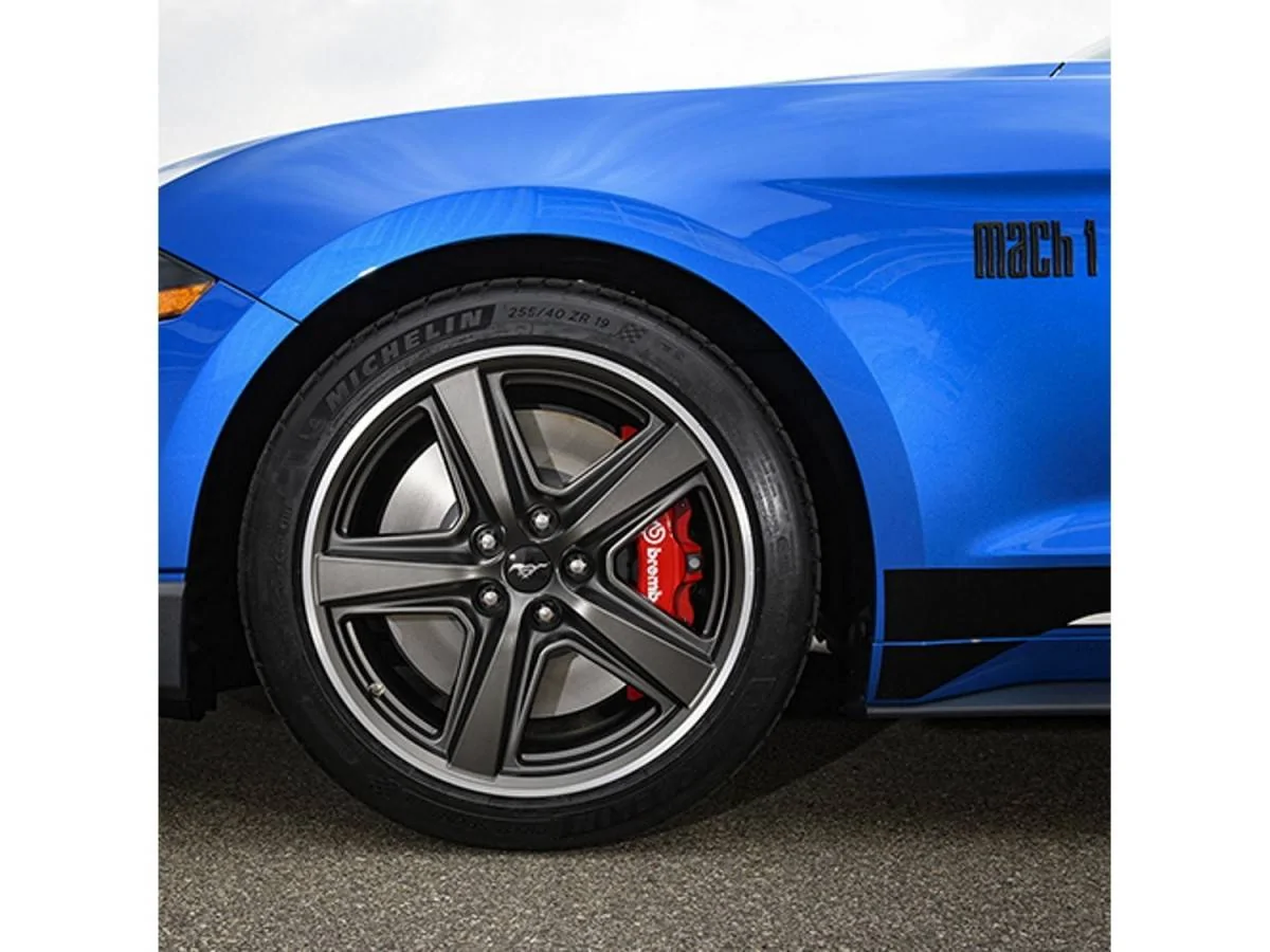

The base Mach wheels that @Bikeman315 linked above are only $862 including TPMS…
I paid 720 shipped with TPMS from ebay.
The Mach1's also need a wider/pricier tire, and narrow does better in snow. Unless you're doing some winter/ice racing, I wouldnt want a 10in rear in snow.
