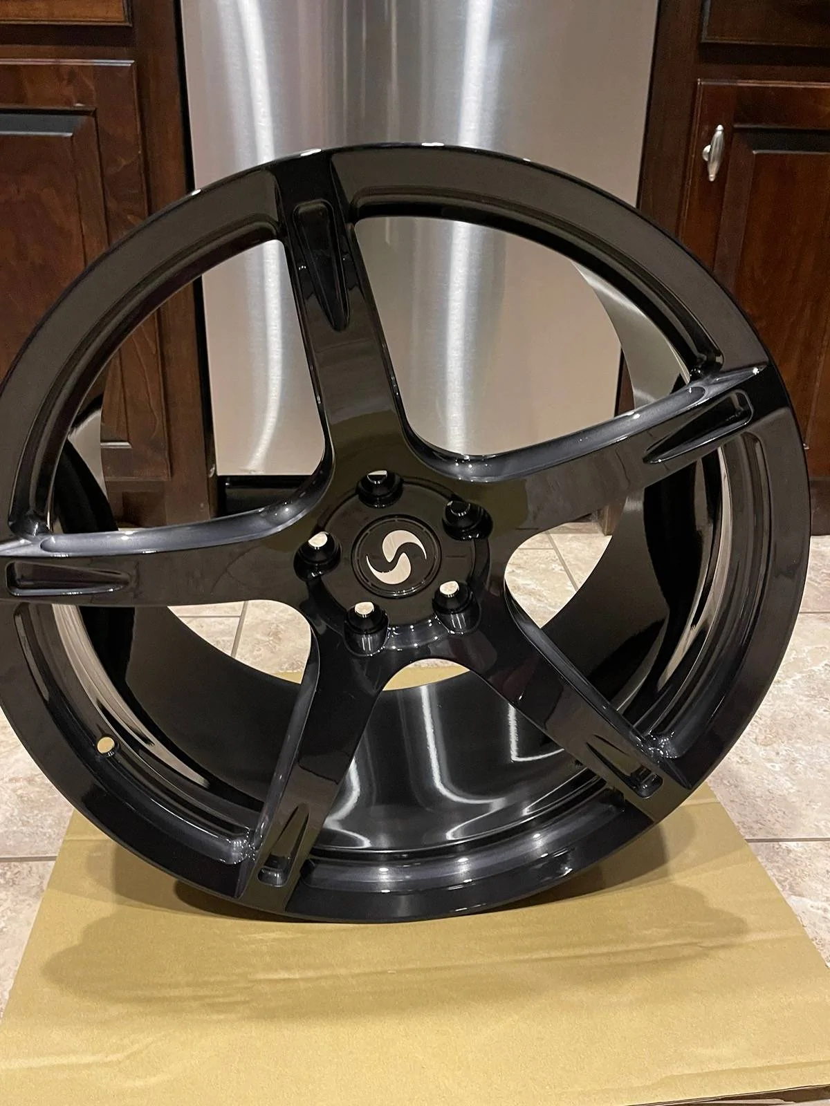

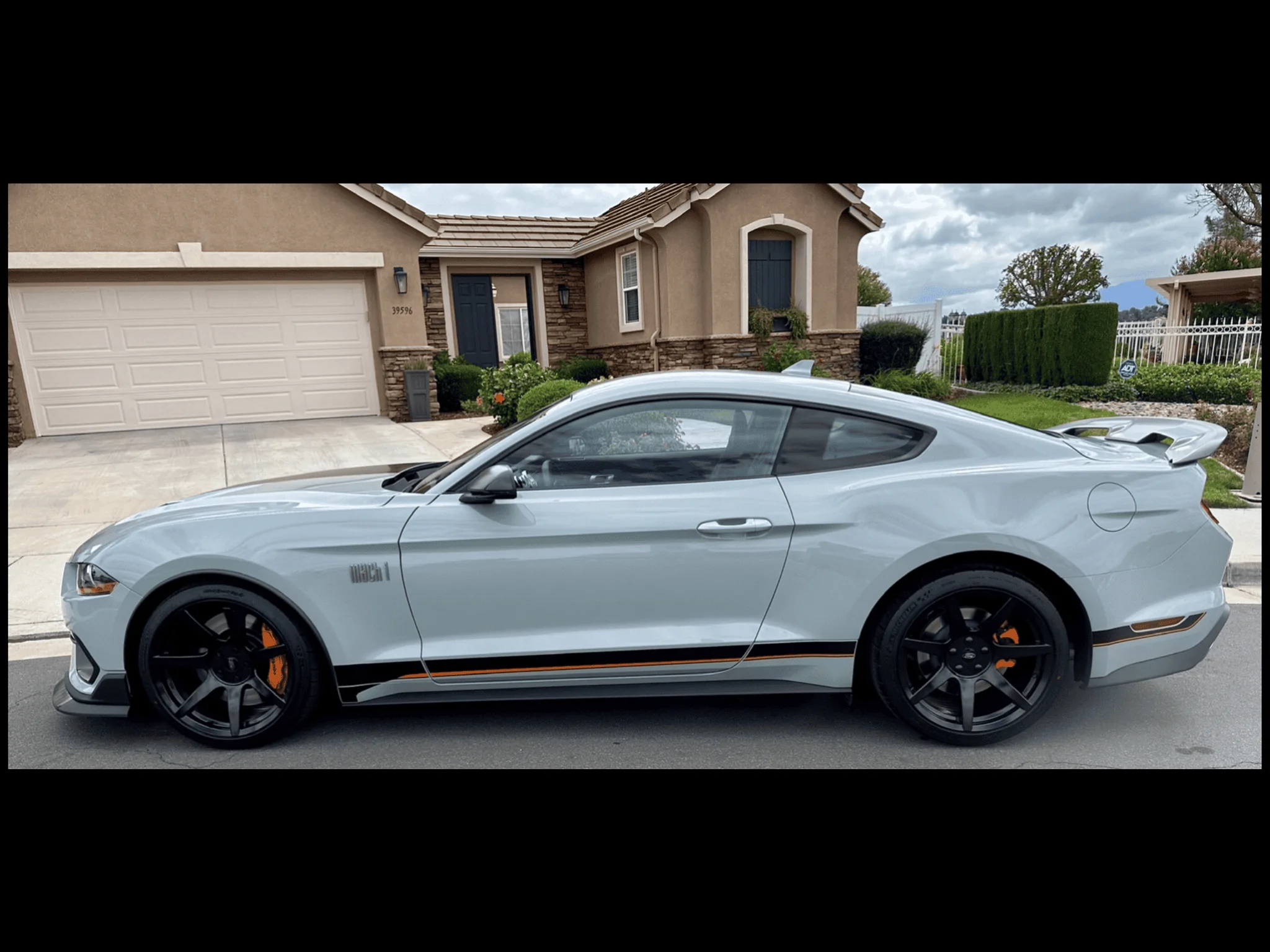

I already had these wheels and I use them on the track. They are the Project 6GR’s, 11/11 1/2 and are 9 lbs lighter. They do stick out a bit up front but the fender molding helps.

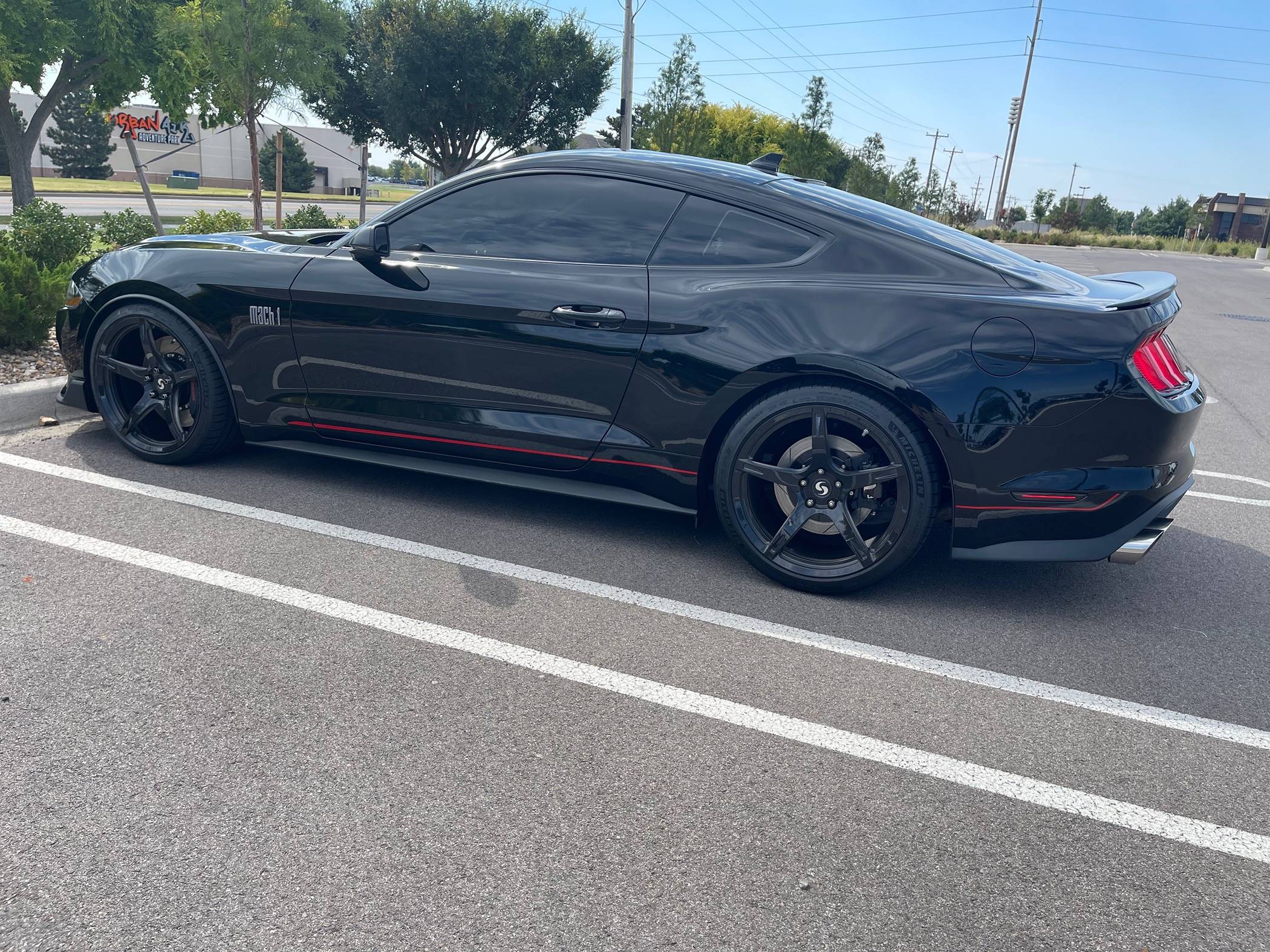

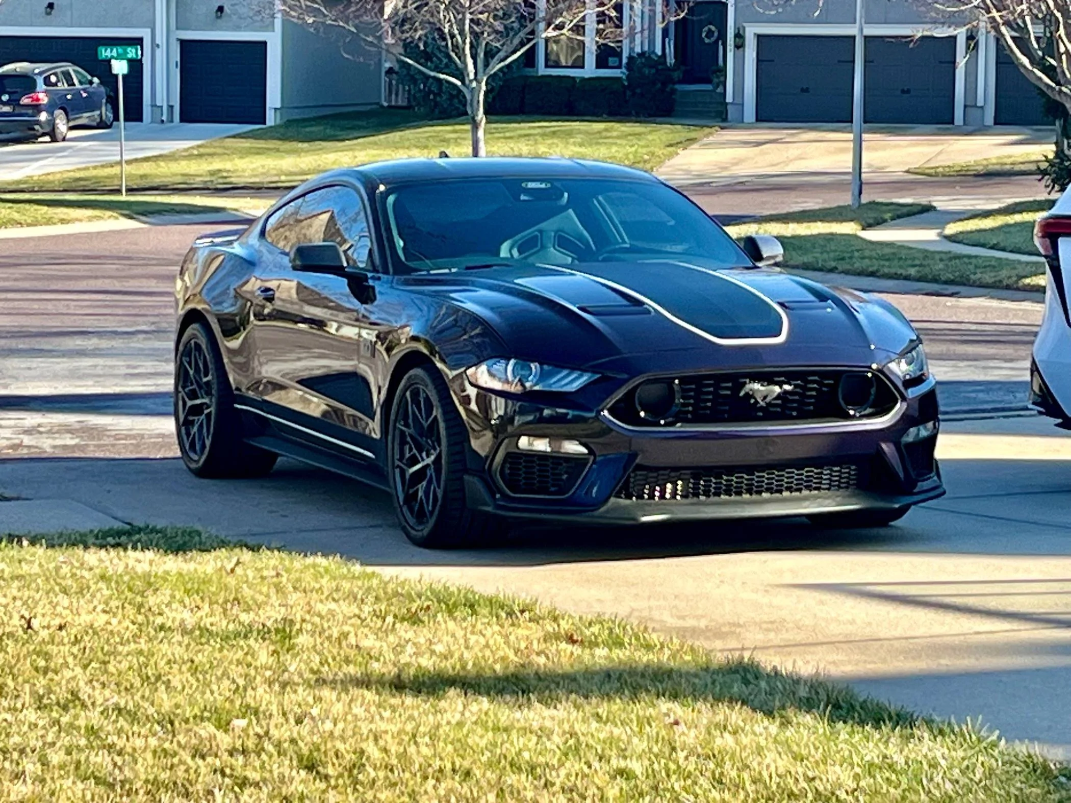

Factory wheels are not bad for a stock wheel compared to some manufacturers (CFTP are bad ass) but they are a dime a dozen and kinda boring, imho.
Signature 902 in triple dark tint 10.5/11.5” with exhibition of speed Ti lug nuts.

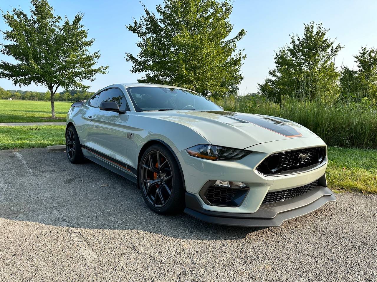

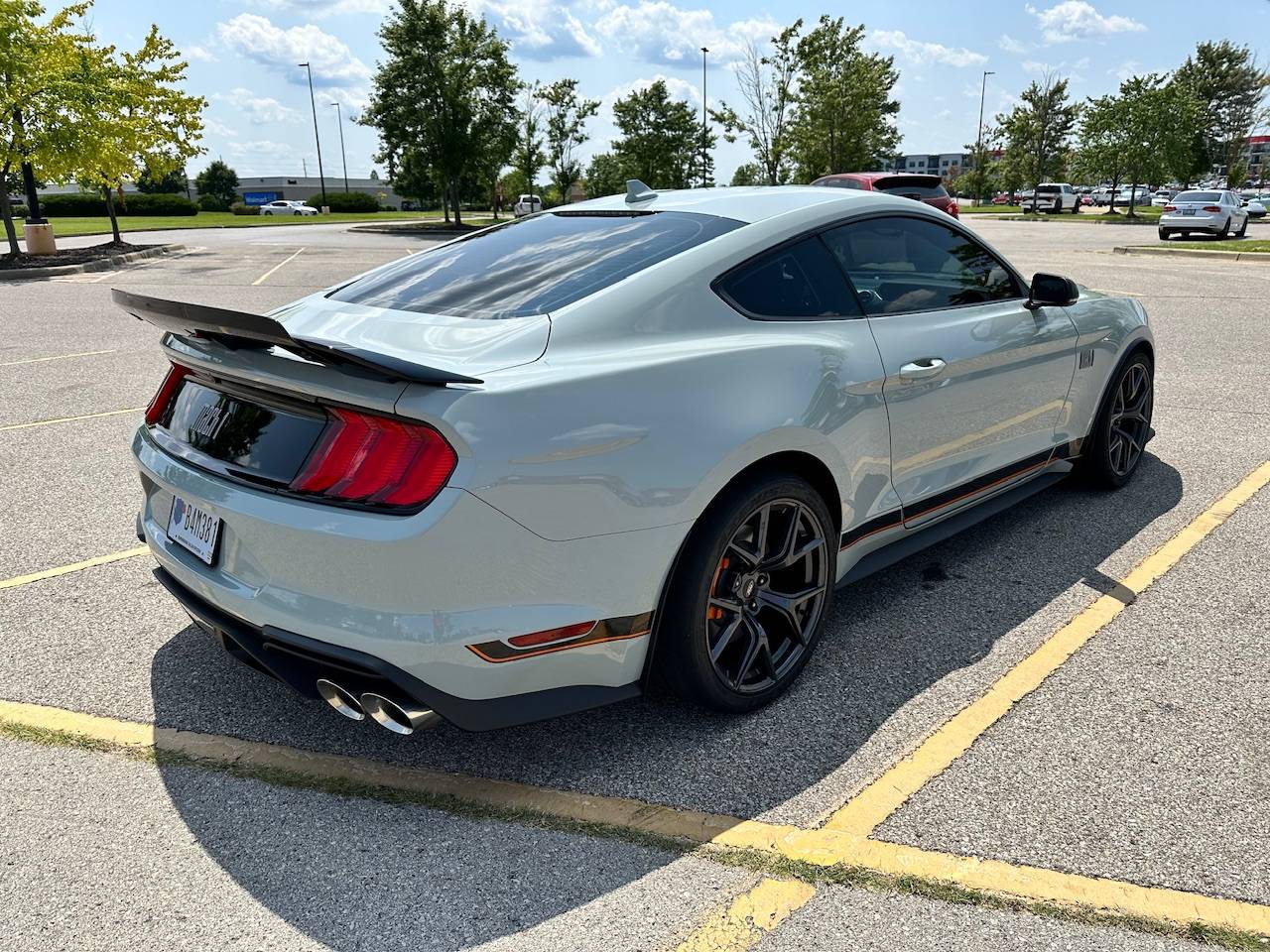

How does 19x11 fit on the front? Is there rubbing or did you trim some?
No rubbing. I run the same 19x11’s front and rear with a 50MM offset. In order to do that I run a 25.4mm front spacer up front with ARP studs so efffectively a 25mm front offset. This is a super common setup on S550’s for track usage. I have 305’s but from my measurements I could clear most 315’s up front.
Not only are my fronts WIDER than factory HP size and offset, but they also stick out LESS and l can rotate them. WIN-WIN

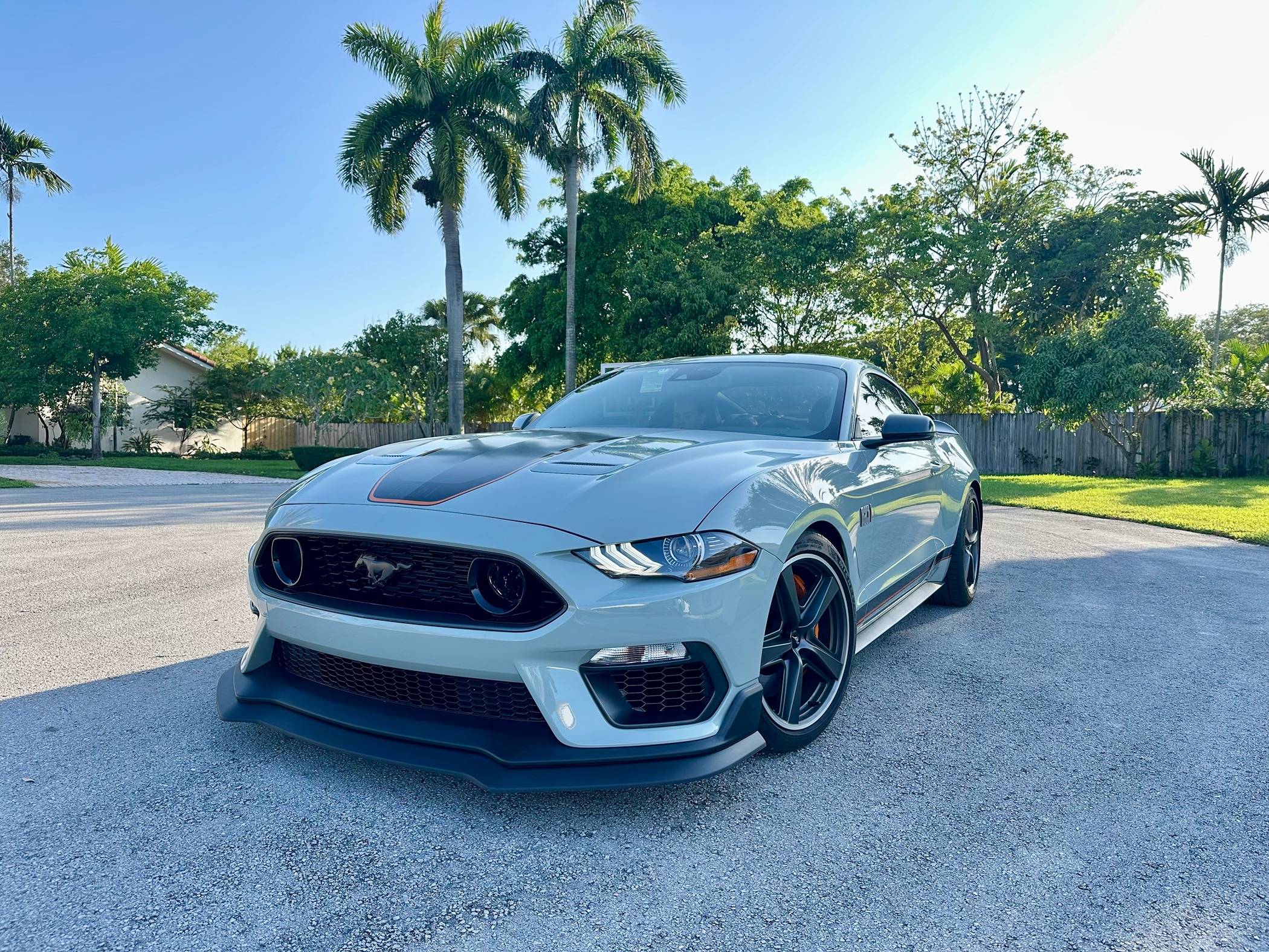

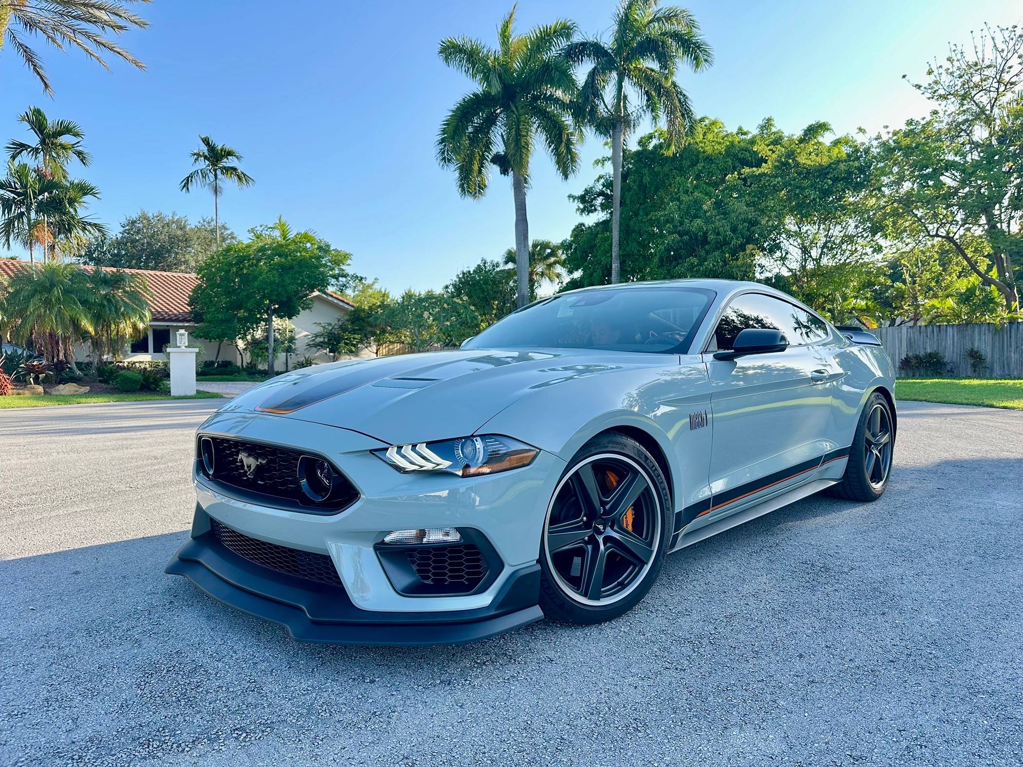

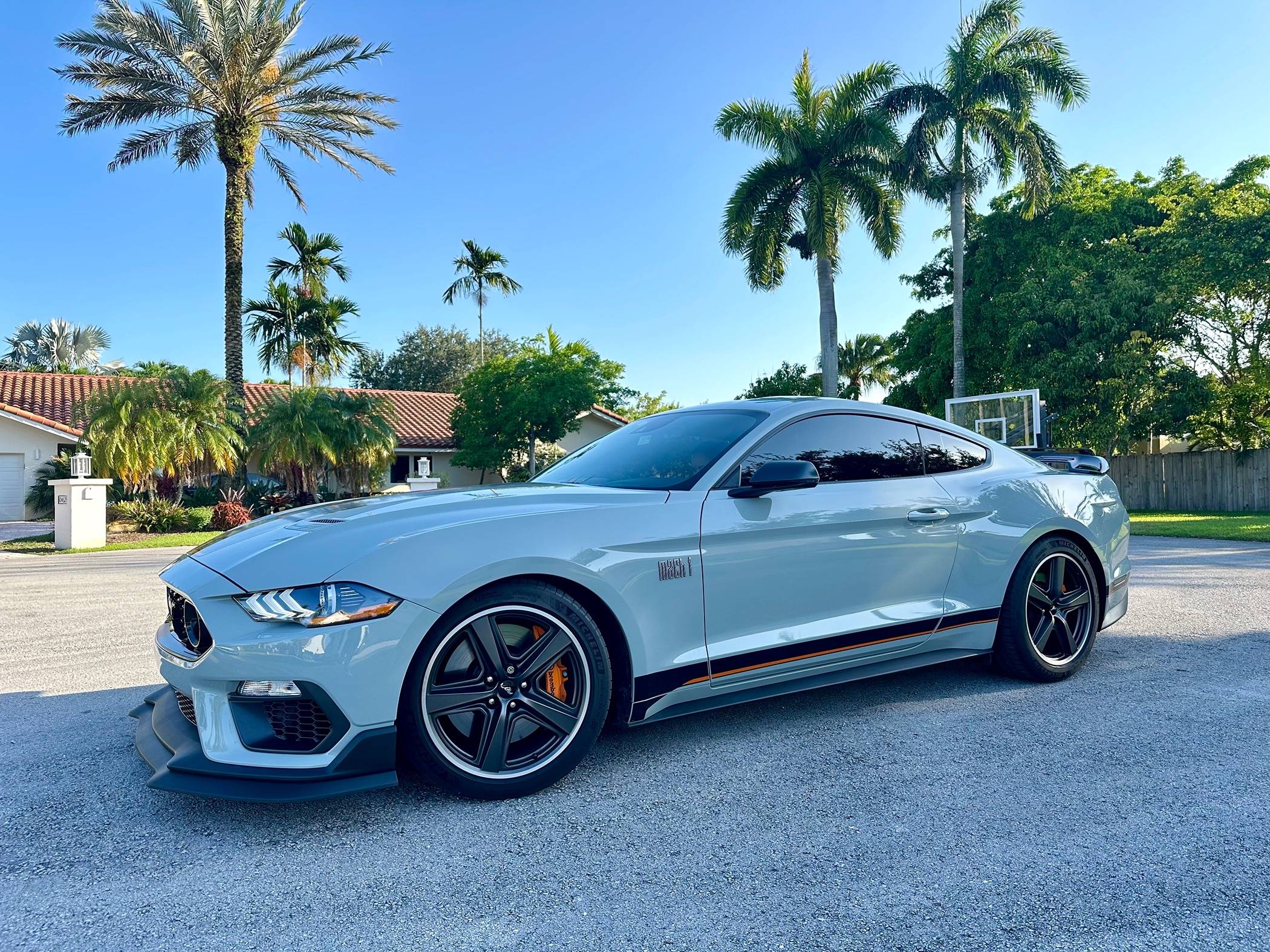

I have to say, I know I started this thread about best Mach 1 wheels, and I’m still planning to replace them primarily because aftermarket are lighter.
But these OE wheels get a bad rap, they don’t look too too bad, I will miss the classic look

They’ve actually grown on me. They don’t look too bad with spacers. And they are wider than PP1 wheels front and rear. Although the same tire size this puts a bit of a stretch on the tires and makes them responsive. I just wish the std wheels and option Y spoke wheels were square. They do make a nice wheel for all seasons or non track tires.

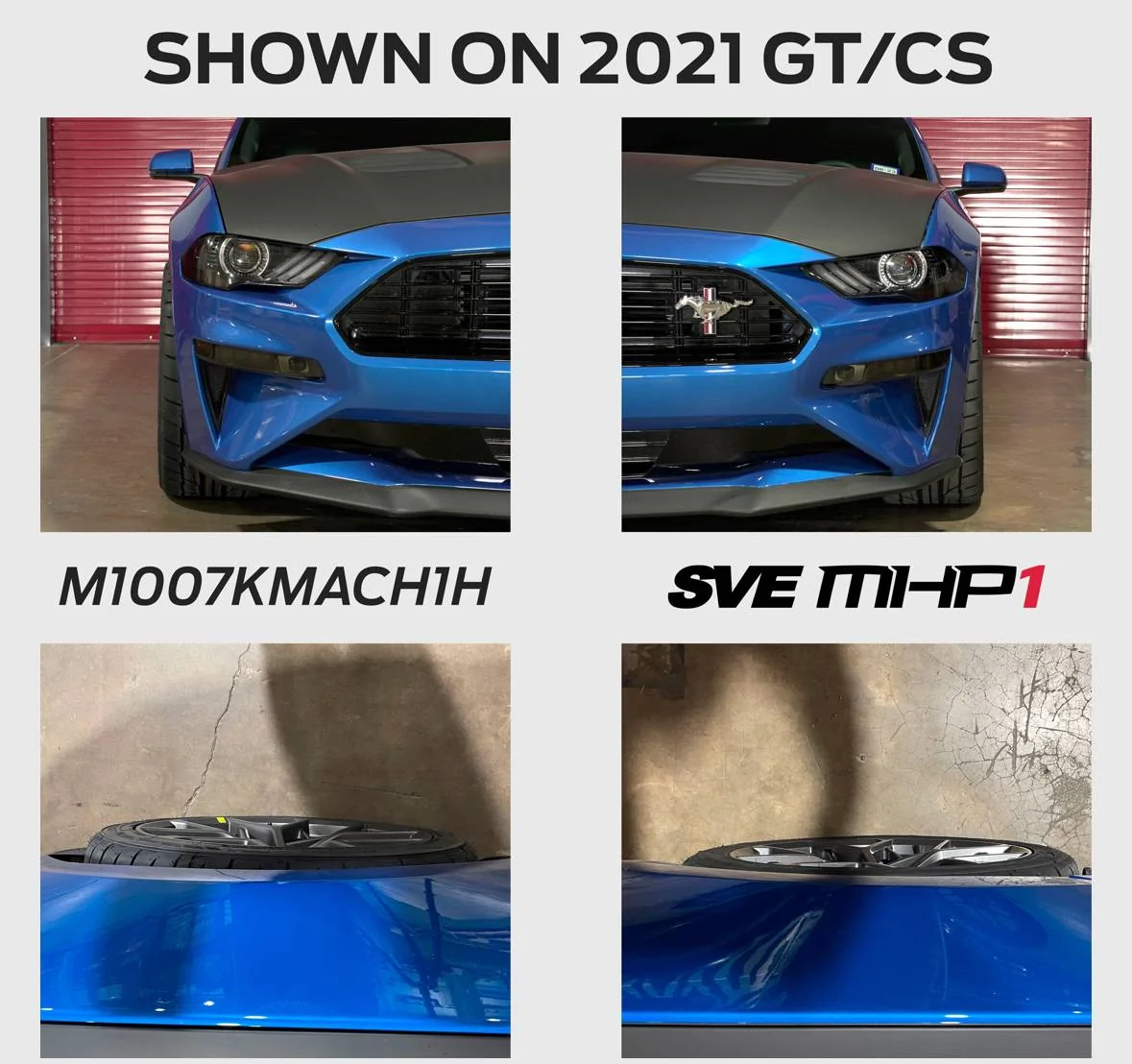

Although, I think I’ve decided to go with the “handling package” look, therefore either going to purchase the SVE M1HP wheels 10”/11” OR stick with Ford performance’s or 10.5”/11” fitment, therefore justifying putting the front fender flares on. 🧩🤔

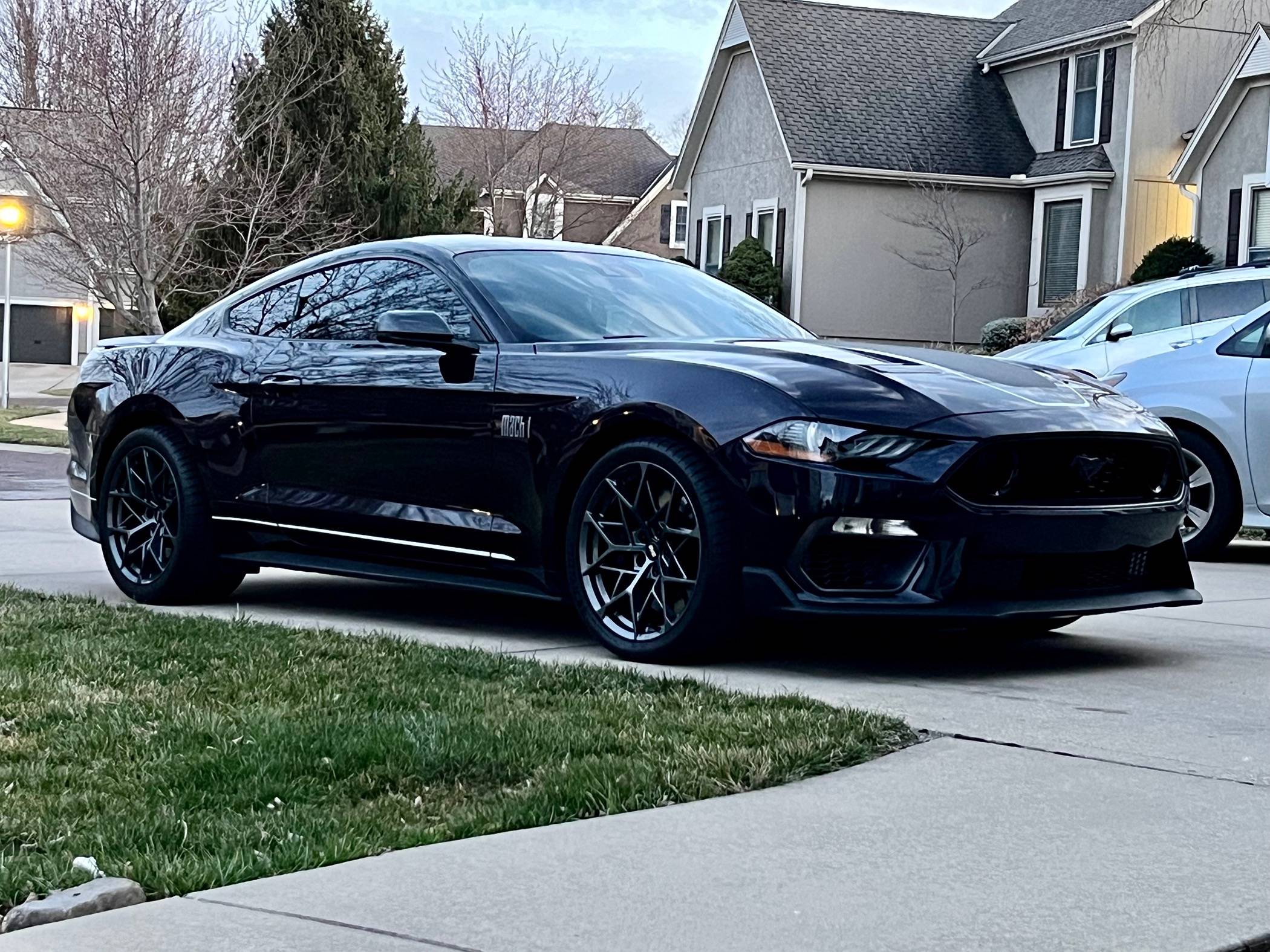

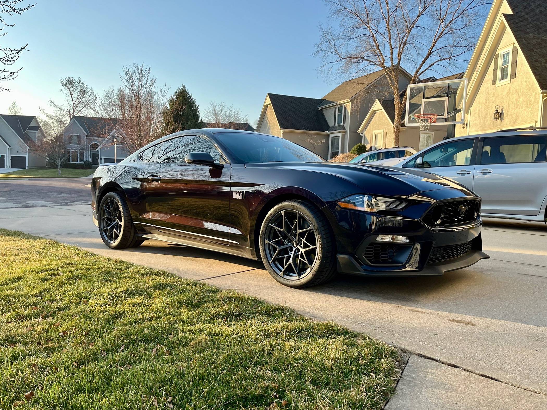

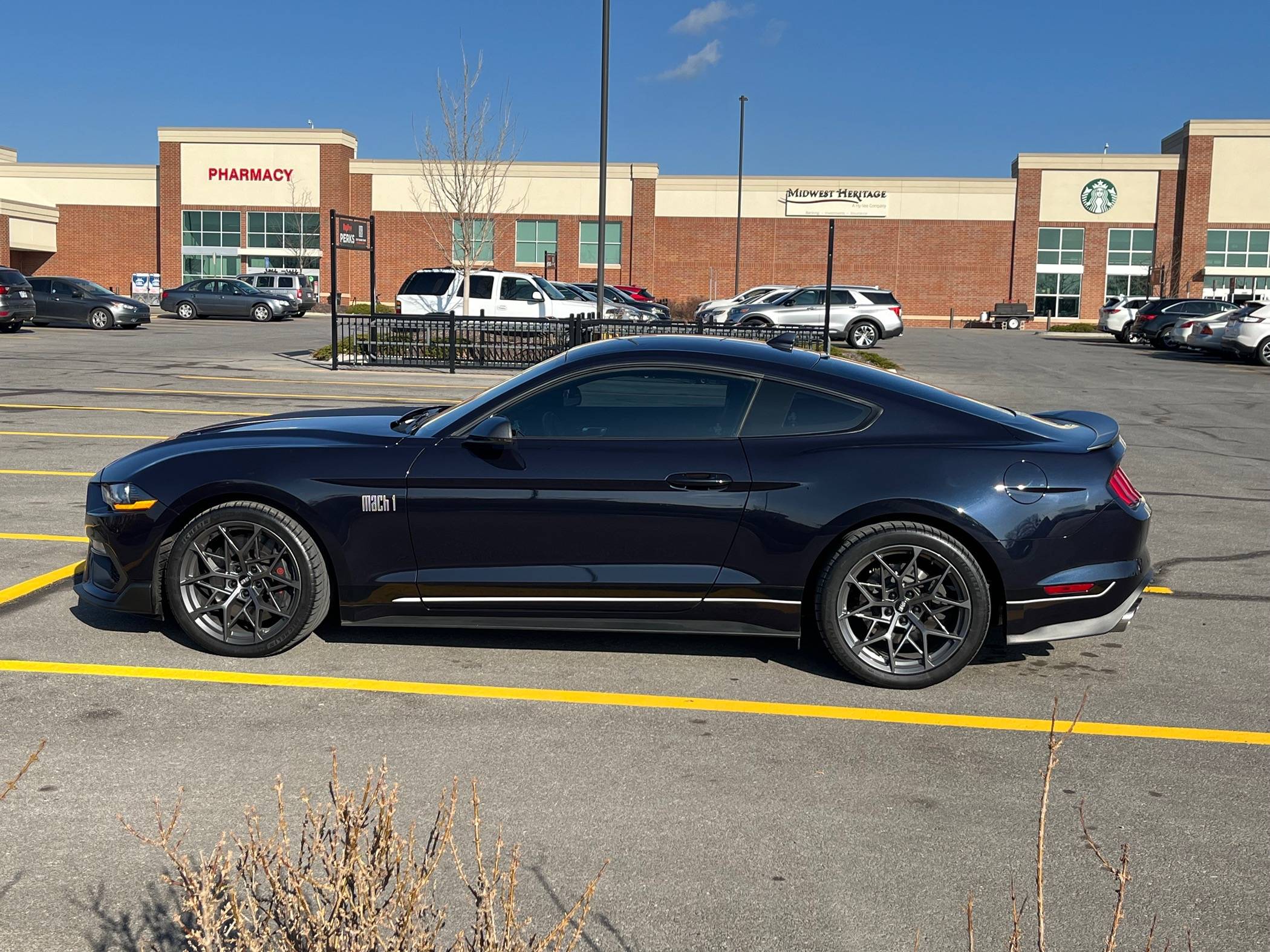

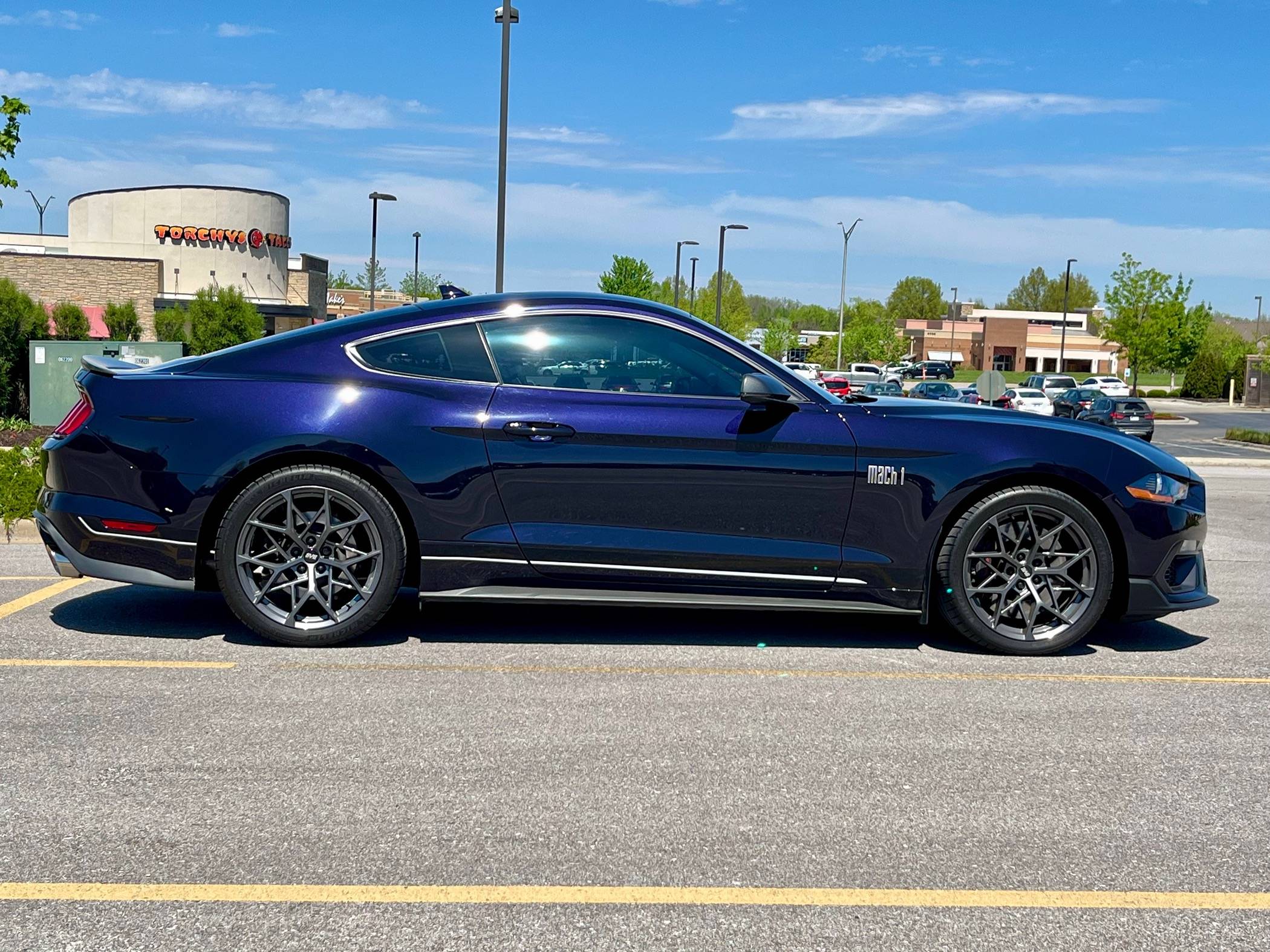

Sve MHP1
front 305/30
rear 325/30
Looks awesome! That’s perfect. Do you feel the handling or drive is hindered by running the 305 on a 10” wheel? I’ve heard others complain that you give up other qualities by going too wide.
Lucky13Cat
Jan 24, 2014
278
633
Overland Park KS
2023 Mach 1 Purple
I doubt it. Feels pretty amazing to me! Maybe I’m just easily impressed. I do know I have waaay more people complementing the car in traffic since these new wheels and I can take turns way faster.😝🤷🏼‍♂️ I love the look and will be sad 3 months a year when I put the originals back on with Michelin all seasons😭
i was ready to put 295/30 on the front because of Michelin’s guidance but the discount tire database says 10” ok for 305/30. That‘s all I needed to hear since I didn’t want a large wheel gap.🥳
