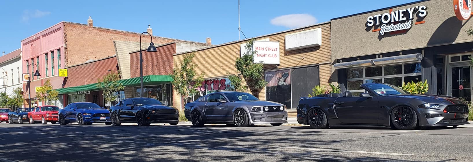

Well, I know due to the price it isn't a "bang for the buck" type of thing, but I absolutely love my Airlift Performance airbag setup! I can quickly raise it for speed bumps & entering my driveway (in Idaho, our driveways are like curbs! Crazy!), raise it for washing, getting jacks underneath it, raise it for bad roads and potholes, drop it for shows, club events, or just for fun, and drive it normally with very little wheel well gap. With the struts &shocks set to a more soft setting, it rides softer and smoother than stock, and when I'm heading to some curvy roads for some carving, I can crank up the struts/shocks and it handles much better than stock! I still have to finish up the height sensor installation, but I'm sure it will perform even better then. I had Eibach Sportlines and Koni Yellows on my 2014, but the airbags on my 2018 are sooooo much better! Easily the best modification I've done to any car ever!! If you can somehow swing it, the airbags are well worth it! :)
That's mine at the front from leading our cruise last weekend. :thumbsup:

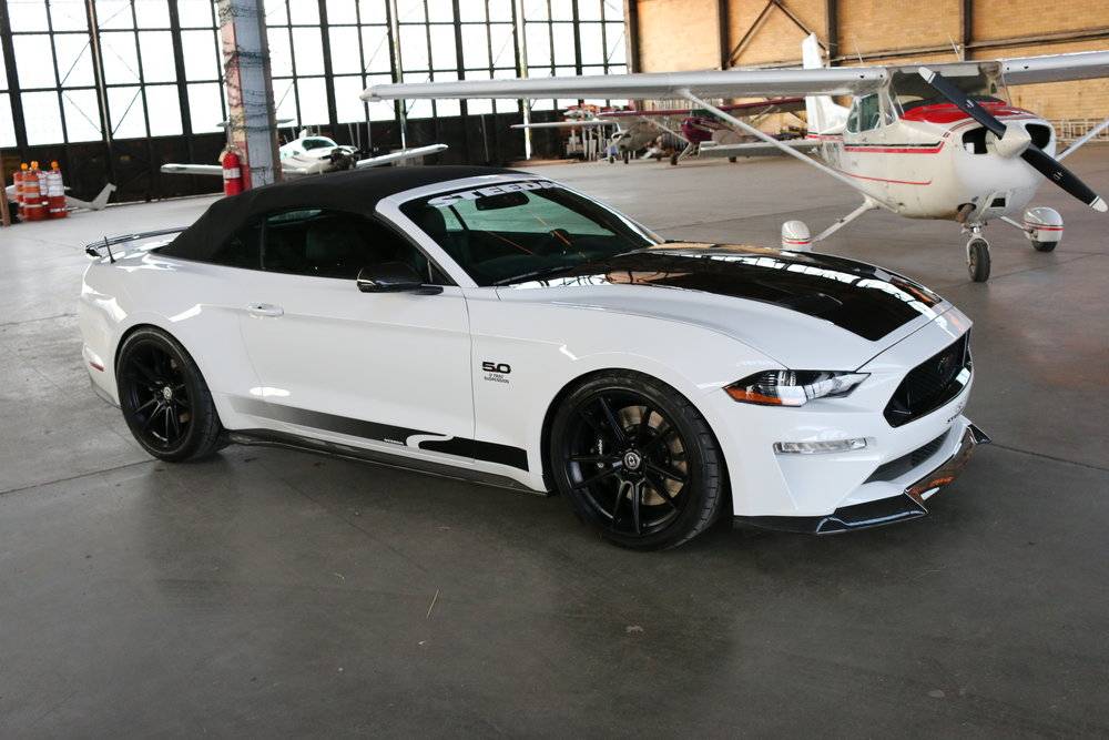

Full Steeda suspension, it handles pretty well :)
