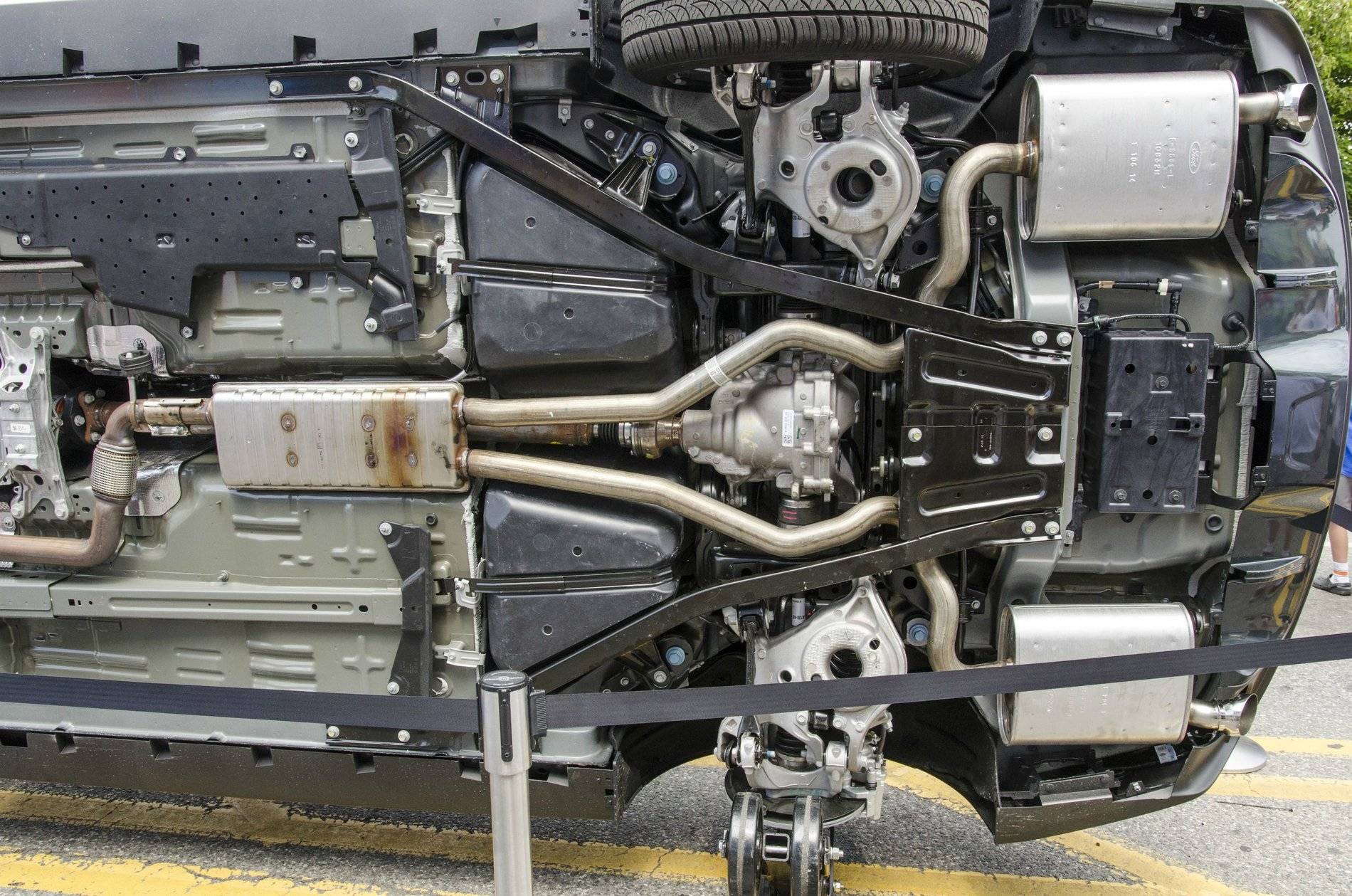

All of our standard catback and axleback systems (excluding xMOD) are compatible with both coupe and convertible.
The only real fitment difference is the center support brace on the convertible models.

It’s the extra bracing. Some companies do not bend the pipes with that in mind and will rub against it.
So if the manufacturers are not saying that it will fit the convertible, then I would think twice before splurging.
