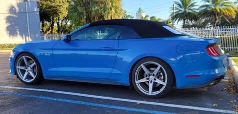

The wheels are Velgen Wheels VF5 Gloss Gunmetal Wheel - 20x10 (2015-2023) with 275/35ZR20 Nitto NT555 G2 Ultra High Performance Tire
The difference between the shocks/struts that I use on my convertible - the Steeda Pro-Action Mustang Shocks and Struts - Non-Adjustable (2015-2024) and Rodneys Mustang are Steeda Mustang Pro-Active Shocks and Struts Set (2015-2023). The Pro-Active Shocks have patented frequency selective damping technology. Compared to the Pro Action, which offers firmer dampening, these units provide more control on rough surfaces by maintaining constant tire contact with the road surface. (The valving in the shock is constantly adjusting itself automatically depending on the frequency of the impact)
So, with the Pro Active, you get excellent handling and great ride quality.
Now, on to springs. Our Steeda Mustang Sport Lowering Springs - Progressive (2015-2024) is our most popular spring. It has excellent ride quality due to the progressive design, but once it compresses about 3/8”, you are into the much higher working range that keeps the car cornering flat and reduces nose-dive under braking.
However, the convertible Mustang is much heavier than the coupe version. It’s so heavy that when using this spring in the rear, you need to use our Steeda Mustang Billet Rear Spring Spacer 1/4" All (2015-2024) to lift up the rear of the car, otherwise it will sit too low.
You can see from the pictures of Rodney's car just how low it sits by looking at the lack of gap between the top of the rear tire and the fender.
So on Rodney's 2022, he did the same package, but instead of Sport Spring Progressive, he did the Steeda Mustang Minimum Drop Lowering Springs - Linear (2015-2024) made his 2022 GT convertible about ½ “ higher than the 2018.
It has the same size wheels/tires, but you can see more gaps between the tire and fenders.
The ride is still very good with the linear spring, and it is much better than stock.
