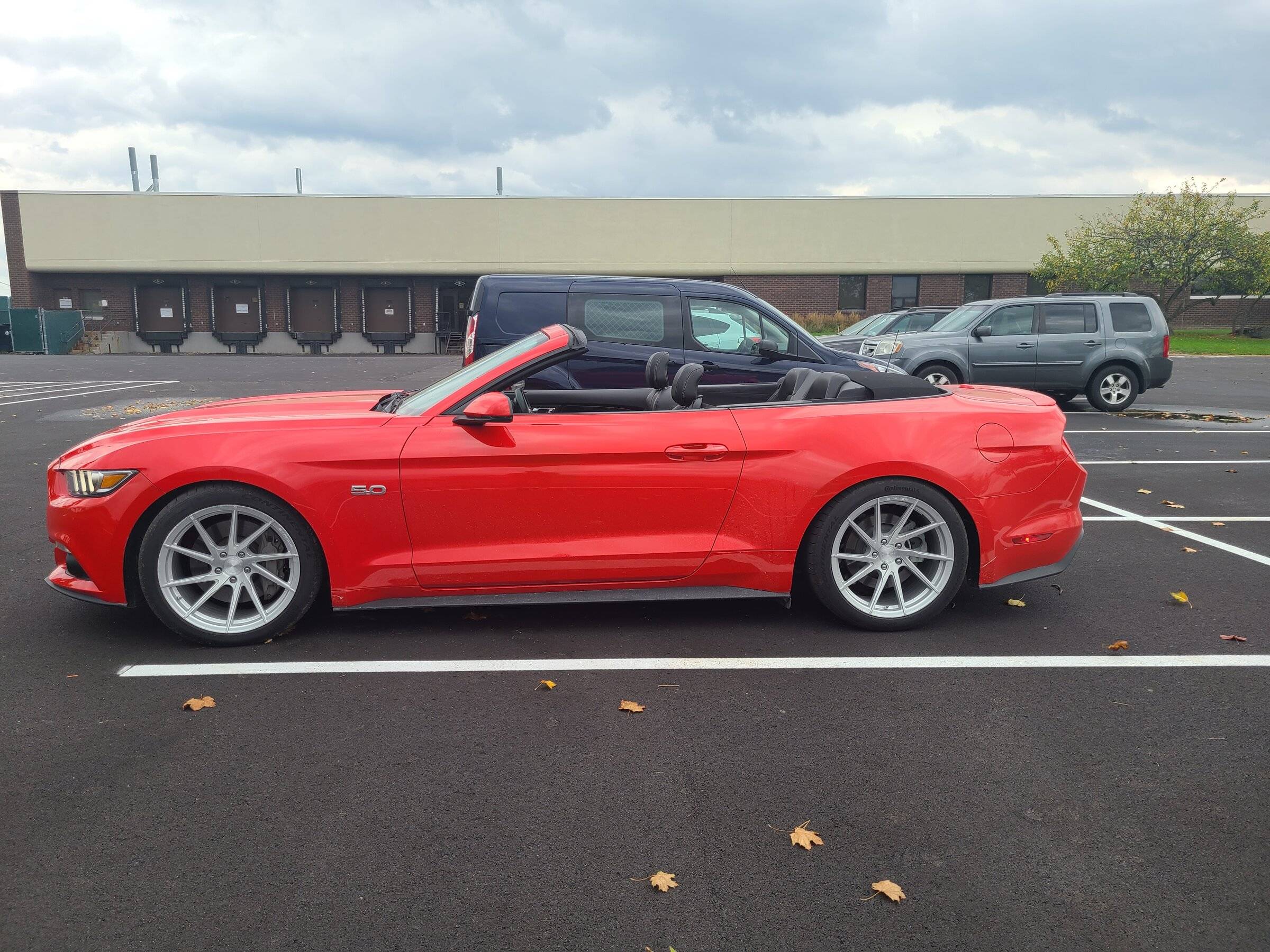

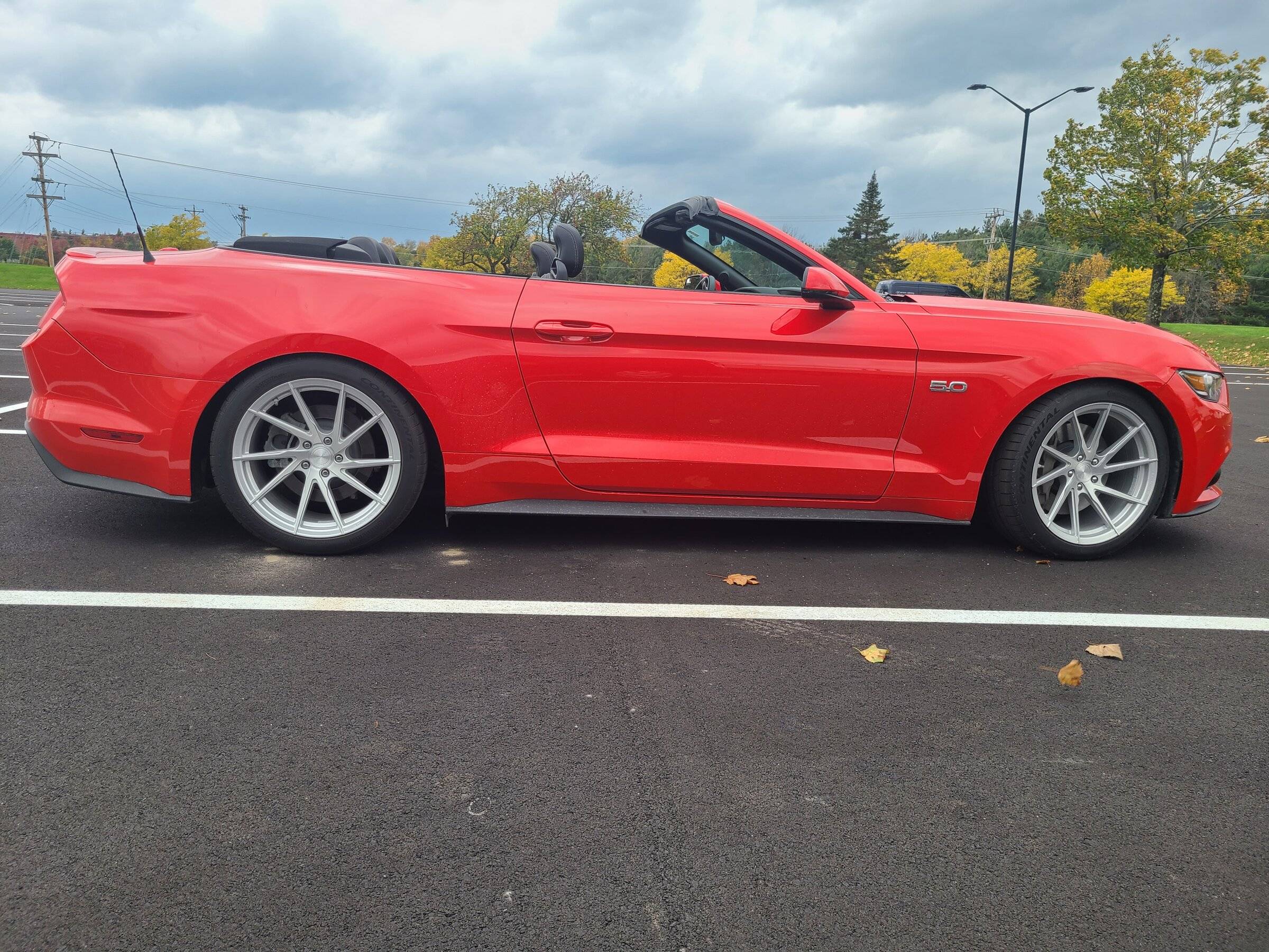

I did full Steeda progressives, sway bars and dampers! I absolutely love the way it handles. One caveat, though, Steeda had to put a spacer on my rear springs to level it out. I still can whole-heartedly recommend them and their customer service is exemplary! TJ with Steeda can hook you up!
I went this route. The ass end of my car sits a little lower than the front

Yes even with spacers
Which spacers are you using? That should be the case but I will be happy to run this by our lead teach - can you please shoot me an email with your current set-up & a photo/measurement of the rear of the car?

I hs
Thank you,
TJ
Jan 30, 2020
65
Vermont
2017 gt convertible
I started with the recommended spacer and Steeda sent out a bigger one. I think 3/8. I am not sure if I still have the documentation
