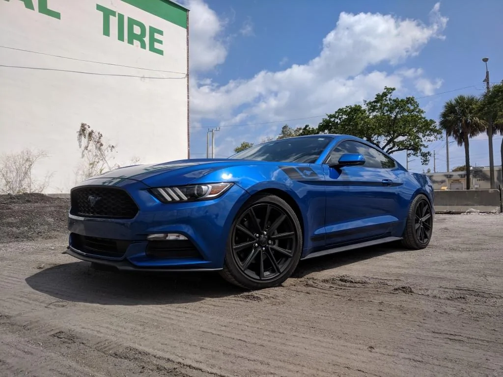

I'll start with saying don't go with the most popular one on AM (the Sportlines). I had them on my car and while it looked good, it ended up being too low for me and somewhat unpredictable to control. I've got Steeda Sport Linears now and they're great with my fixed Pro-Actions, probably even better with the Adjustables. This ties in to what whalesalad mentioned in his first bullet, I like the linear spring better than progressive (Sportlines).
For supporting mods, I got camber plates right away (went with Steeda to match my shocks/struts) because it is highly recommended for drops of 1" or more to make sure you're able to get the camber back in to spec.
I also just had Steeda adjustable sway bars (front and rear) installed yesterday and man oh man does it feel good now. That ties in to your spirited driving but not going on a track. I don't know about NH, but we have some nice curves on certain pieces of highway and other empty roads around here and it just feels so much better now than it did before I had the sways. Night and day difference there and definitely recommend doing that.
For your stance, I definitely agree with the 25mm spacers. It fills it out a lot better and is a cheap mod ($100 for the set if you shop around, you can get the Coyote brand on Amazon for a bit lower than that - don't pay AM $200).
You'll get good feedback from the guys on this forum and I'd definitely say it is better to get opinions here than trusting number of sales on American Muscle (plenty of people on our local FB group have moved on from Sportlines as well).
Here's a pic of my car on the Steeda Sport Linears from a few weeks ago. I added 1/4" spacers to the rear now so it is a touch more even all around, but no pics yet.
